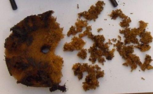

CNew 408 #2 Posted May 28, 2020 Welcome to the forum! Very nice fan, I recently rebuilt one of these but it had the earlier O&R engine. You can probably search for the thread on here, it was titled Ohlsson & Rice Manhole Fan. Do you know for certain the application as a firefighting fan? I never could figure out exactly how it was used. I’d love to learn more about the application of you have any info. I think the general consensus for oil is a 32:1 ratio. I’ve been using Stihl HP oil (mineral based and not the synthetic version) mixed with a high quality non ethanol fuel, and not the standard pump gas. You should be able to find a good high octane non ethanol fuel at a lawn equipment shop. I’ve stayed away from TruFuel stuff at the big home and garden centers. I’ve always been a little concerned it may be too “engineered” with all kinds of additives that may be harmful to these older engines with older seals and gaskets. One other good piece of advice I got from the great folks on here when I was first getting into this is to clean out the old air filter foam before starting the engine. If you don’t and it crumbles it’ll get sucked into the engine through the carb. Share this post Link to post Share on other sites

CNew 408 #4 Posted May 28, 2020 Very cool. Yes, the Advanced Engine Products would have been in the 1970s after taking over Ohlsson & Rice. I’m sure Factory and Wallfish will be jumping on this thread soon. These guys are super knowledgeable and know all the history of these engines. It’s not uncommon to need to rebuild the carb if the little rubber Diaphragm has dried out and turned hard. You’ll know pretty quickly once you try to run it. Don’t forget to check the air filter to make sure there’s no old foam in there. You can replace it with the modern, green colored lawn mower filter foam. Does your fan have a throttle handle on it? Share this post Link to post Share on other sites

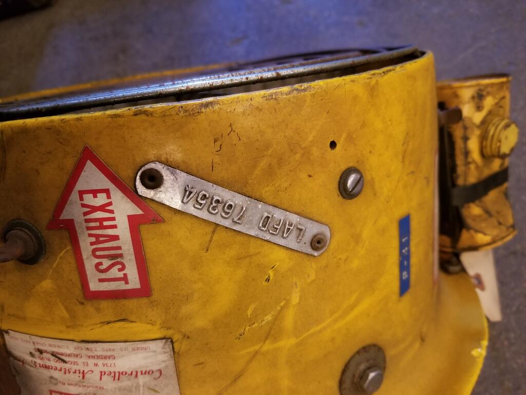

Chuck 7 #17 Posted May 28, 2020 $175 as is. It is marked L Los Angeles fire department LA FDI got it from a fireman Share this post Link to post Share on other sites

CNew 408 #21 Posted May 29, 2020 That’s really cool it has the LAFD tag on it! Share this post Link to post Share on other sites
factory 487 #22 Posted May 29, 2020 Interesting, the label looks to say Controlled Airstreams, searching for that & fan gives the full name as "Controlled Airstreams Inc." a company that made fans, apparently taken over by Tempest Technology Corp. they still sell fans for many applications; https://www.tempest.us.com/ including fans for ventilation after fires. David 1 CNew reacted to this Share this post Link to post Share on other sites
factory 487 #23 Posted May 29, 2020 3 hours ago, JUST O&R said: 20 hours ago, Wallfish said: I'm interested in it and you don't have to get it running! I know how to do that and you called us vulture's Well now we know they were used by fire departments and we know what to search for hopefully they will be easier to find. The Tempest website gives another possible use as a hot air balloon inflator (although the engine looks a bit bigger), they also mention the use of fans for helping control fires as well as clearing smoke afterwards. David Share this post Link to post Share on other sites
