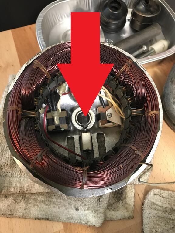

CNew 408 #22 Posted August 15, 2020 Bad news, while trying to get everything lined up to put the generator parts back together the little brush bot pinched and snapped Hopefully I can find a suitable replacement. Share this post Link to post Share on other sites
Wallfish 718 #23 Posted August 15, 2020 That looks like a PITA to get to that brush for putting it back together. Share this post Link to post Share on other sites
CNew 408 #24 Posted August 15, 2020 Indeed, you need another four hands for this operation. It takes two hands just to align the windings with the bearing while fishing the wire through and everything As it all slides together. Then, just as it engages the bearing you’re suppose to somehow use a dental pick through the front of the bearing hole, while also holding a flashlight, to push down the brush and slide it all together. One little slip and snap... just like what happened to me! Share this post Link to post Share on other sites
Wallfish 718 #25 Posted August 15, 2020 That looks like slots on either side. Maybe use a piece of string or something to hold the brush down. Search for some brushes and try to find something close. They're not that expensive. The graphite can be shaped to match your generator. Share this post Link to post Share on other sites
