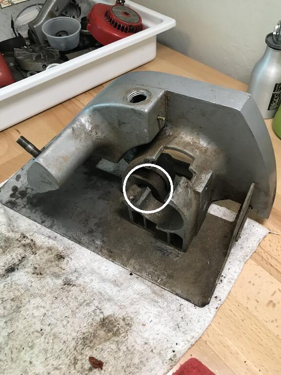

CNew 409 #1 Posted July 4, 2020 I’ve been wanting to dig into this one for awhile. Finally got it 97% disassembled. The main bearing on the blade pulley is a little raw. Would be best to replace it or at least get at it to put some bearing grease in there. I’m not sure how the roller spindle comes apart. There looks to be a clip holding the back of the shaft but it also seems like it may have some sort of taper fit like a crank shaft. Has anyone had one of these off before, any photos or tips? Someone has been inside this machine a few times. There were all sorts of make-shift gaskets and seals, horrible job. Worst part about the whole thing is the spark plug threads in the head are completely stripped out. I mean, how hard is it to thread in a spark plug? If you can’t do that then you should definitely NOT be operating a gas powered circular saw! The coil is also going to need some TLC, wires are all cracked and split. There was also a pretty terrible splice job on the power button. 1 pmackellow reacted to this Share this post Link to post Share on other sites
Wallfish 724 #2 Posted July 4, 2020 Look for a hole in the saw body for a set screw. Twice the set screw stripped on me so never actually got the bearing out. If you do get the set screw out, look inside for another one in case it's doubled up Share this post Link to post Share on other sites
CNew 409 #3 Posted July 4, 2020 Hmmm, I’ll have to take another look for a set screw in that area. There was an adjustment screw on the side of the engine mount tab that looked to help adjust the belt tension or something but I didn’t see anything around the bearing/shaft area. I’ll take another look later this afteenoon. Share this post Link to post Share on other sites
Wallfish 724 #4 Posted July 4, 2020 Yes, that screw you know if is just that. The engine mounting holes on the case are slotted so the belt can be tightened with that screw. I can't remember if the set screw was on the top or the bottom but it was small too. Share this post Link to post Share on other sites
CNew 409 #5 Posted July 4, 2020 No set screw on mine. Turns out it just had multiple cir-clip retainers. I was able to get the shaft and pulley removed along with the two bearings. Now the fun begins, trying to find new bearings... 1 pmackellow reacted to this Share this post Link to post Share on other sites
