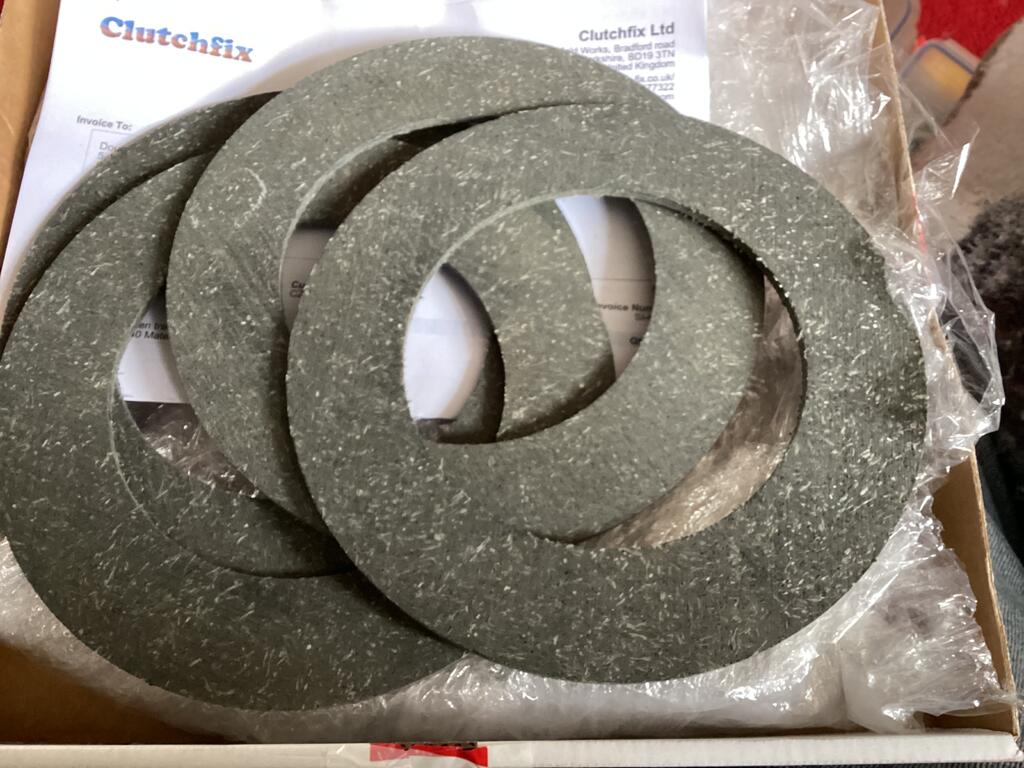

ranger 373 #1 Posted May 22, 2023 Hi everyone. I’ve been looking for a source for the pto clutch linings. Not wanting to pay Toro prices, I found a company that specialises in all types of friction plates etc. I’ve just ordered some linings to suit the 6 3/4” size pto’s. The company’s name is Clutchfix ltd. Have a look on their website. To order quote the material type - RF40, dimensions 171 x 108 x 4 mm. Price quoted £10.14 p + vat + postage. If you require the older smaller size, (6”), quote the required dimensions. Suggested adhesive = Araldite! Doug. 2 Stormin and Cub Cadet reacted to this Share this post Link to post Share on other sites

ranger 373 #5 Posted May 25, 2023 New linings just arrived! Share this post Link to post Share on other sites
