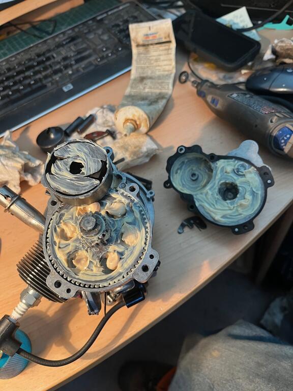

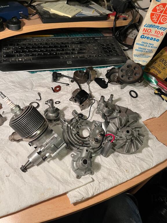

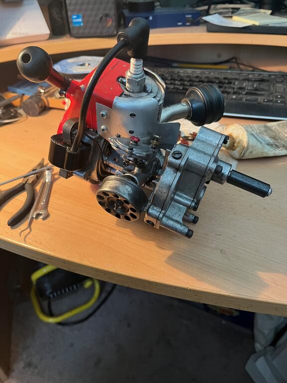

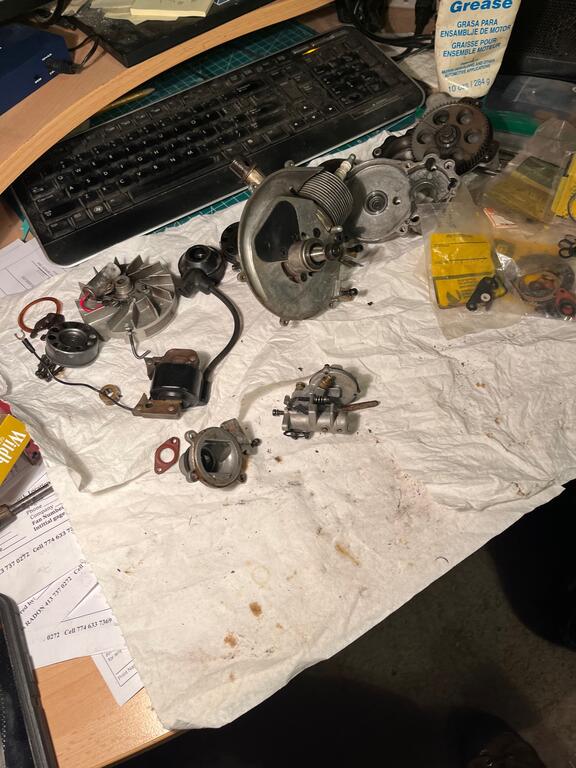

Wallfish 718 #1 Posted January 1, 2024 Happy New Year! This is a model J gearbox engine from a Polaris Power Pole snow blower. Recently member @seb T was asking about a gearbox for a Devillaine Ouragan car. So I had the engine out anyway and needed to pull the gearbox to verify if it would fit his engine. Well I might as well rebuild everything. Gearbox with a new seal and gaskets. Plus the entire engine just in case he is interested in a completely rebuilt package. Got everything cleaned up tonight. Tomorrow I'll remove the head and re-ring the piston and put her back together. 1 1 K-TRON and CNew reacted to this Share this post Link to post Share on other sites

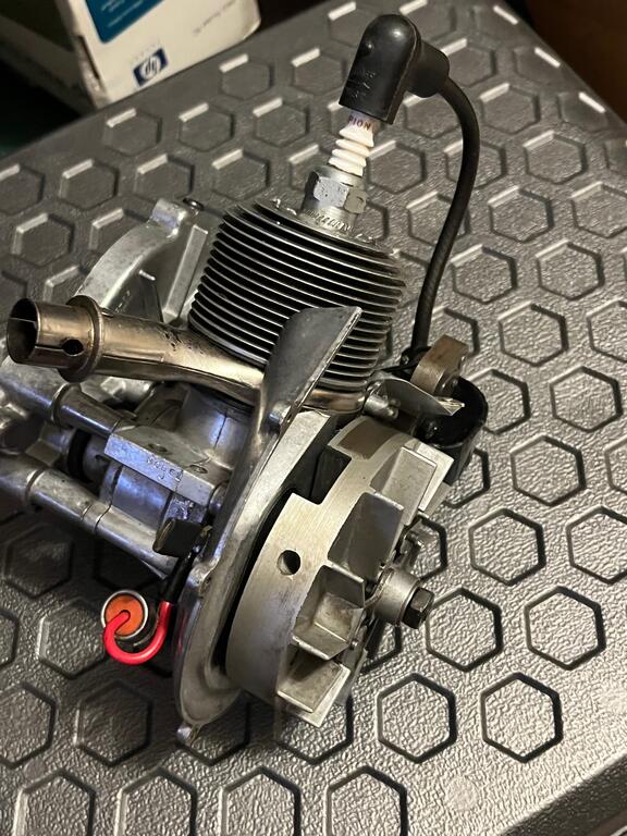

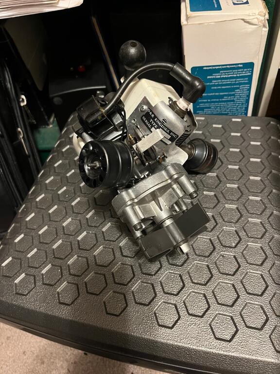

Wallfish 718 #4 Posted January 2, 2024 Got the engine done and mostly assembled but still need to do carb top half and recoil. Has a nice hot blue spark just spinning by hand and very good compression. Didn't need to do rings as everything with the cylider and piston was clean and good like this engine had very low hours. Definitely not as fast doing this as I used to be. And spent a bunch of time looking for escaped bearing rollers! LOL I let a few out by mistake when not paying attention. Feeling old as I can't see very well and the hands aren't as steady putting those little bearing rollers back in. I'll wait to grease the gearbox. 2 JUST O&R and CNew reacted to this Share this post Link to post Share on other sites

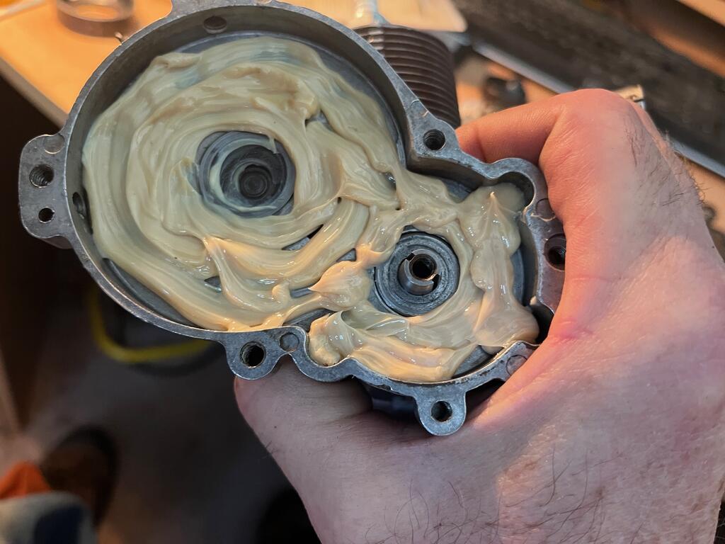

Wallfish 718 #8 Posted January 17, 2024 Had some time again today since the snow and ice put a damper on the scheduled job. Recoil and carb is done for this one plus did the gearbox too. I use the Lubriplate engine assembly grease instead of oil in the gearboxes. It will liquefy when it's running and slightly solidify again helping to keep it from being sucked into the engine seal or leaking. It does remain partially oil too but it's easy enough to squeeze more in when needed or if necessary. Even a thicker grease like JD Cornhead grease will work or 00 grease. Everything about this engine is in very good condition and it went together nice and smooth. I'll probably find a nicer air cleaner for it too. I don't run gas through the carbs one they're done because it will gum up just like the old ones do after a while. A few drops in the plug hole and Viola, she fires and still fine for long storage. Seb T ghosted me on the gearbox and engine and haven't heard anything back since emailing him, so I'm kinda happy to just keep it for the Polaris Power Pole Snowblower. Didn't really want to disable one of my tools and turn it to parts anyway. But I would sacrifice it just to see one of those cars running. Share this post Link to post Share on other sites

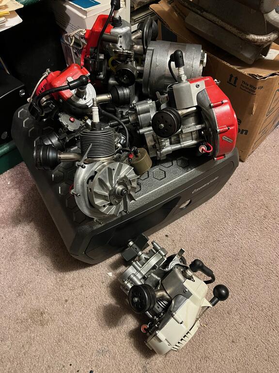

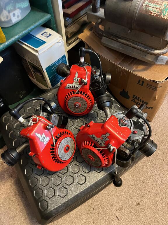

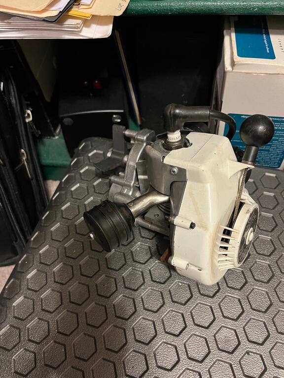

Wallfish 718 #9 Posted January 21, 2024 Only Jan and already got 4 engines rebuilt so far this winter. The Amp Champ in the other thread is done, the snow blower gearbox engine in this thread, plus these other 2 in the pic with the blower engine. The guy across the street is going to spin up some of the recoil handles on his wood lathe. So now it's time to start putting these rebuilt engines on some tools and then get started rebuilding those engines or I might keep those tool engines together with the tools. IDK yet 2 CNew and pmackellow reacted to this Share this post Link to post Share on other sites

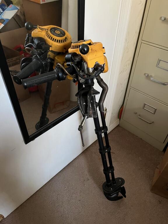

Wallfish 718 #13 Posted January 22, 2024 1 hour ago, CNew said: I’ve never had one of the outboards opened up, not sure which crank setup that is. I do have a partial outboard, I’ll have to see if it is all put together at the crank end or if that’s pulled apart. I’ll try to take dig it out later this evening. There's an Aqua Bug outboard out there that had no plastic cover or tank when it was bought so I added a drillgine type tank. Those outboards actually look more old school cool without the cover and that one always got attention when taken to the shows for display. Probably because everything is visible. Think I'll start with that one and pull it apart and rebuild or replace that engine. Maybe then a Mini Motor and another Aqua Bug I also have a rare Polaris Power Pole outboard still sitting in a box and all parts from shipping. It's the same tool/engine that @Laserscottman had when he made the famous carb tutorial thread years back. Can't remember how deep he went into it but think he went through everything on it except for actually rebuilding the engine. Work is a bit slow this year so might as well stay on a roll getting some O&R stuff done that's been on the back burner for too many years. Share this post Link to post Share on other sites

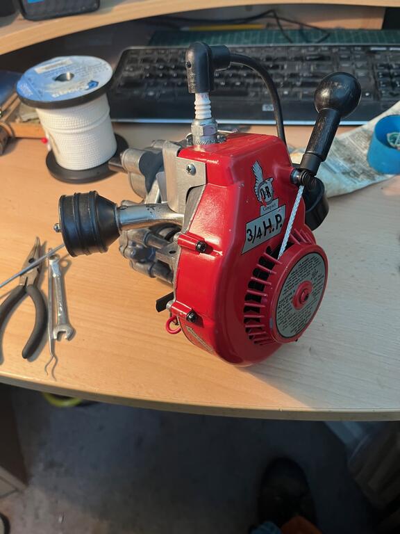

Wallfish 718 #14 Posted January 22, 2024 Well, I must've already went through this engine or it has had very little use because the compression felt when pulling it over is about as hard as the recently rebuilt engines. Do enough of these and you can easily feel the difference between a worn engine and a new one. If there's any doubt, then it's in the middle and new set of rings will typically take care of it. Clean up and new recoil string is probably going to be about it but I'll give it the balloon leak down test for checking the seals. The lower unit gears and seals were gone through when I got it but honestly do not remember ever removing the engine on this Share this post Link to post Share on other sites

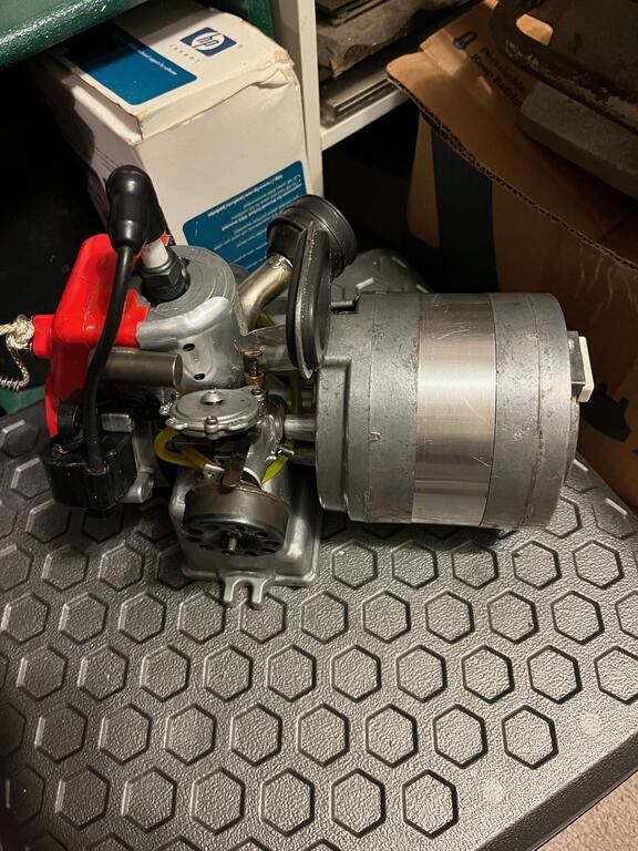

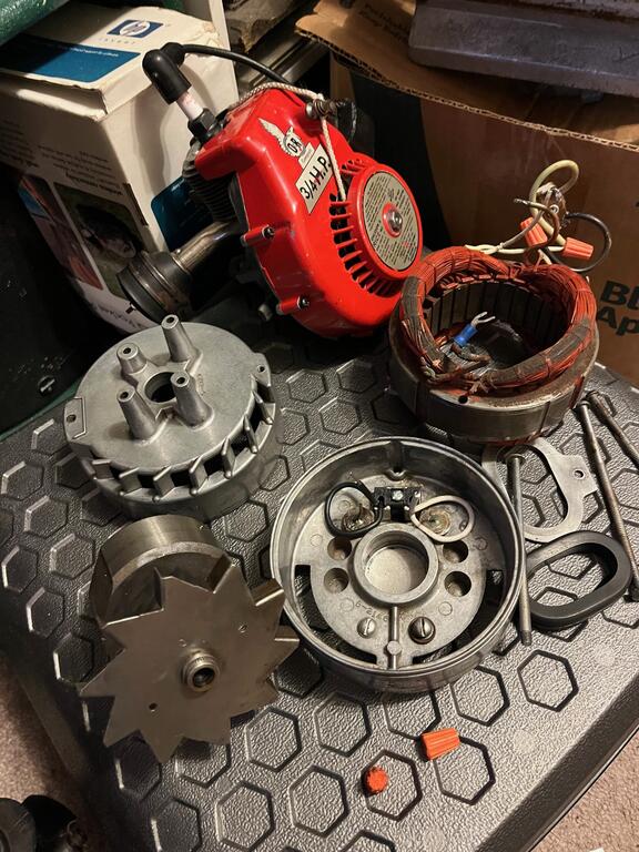

Wallfish 718 #15 Posted January 22, 2024 Found a TT generator with just an engine attached. So one of these newly rebuilt engines will go with the gen head and there's a spare tank out there. Probably need to make a base for it though. Forgot to take a beginning pic but this thing was nasty and covered with crud. Fixed wiring, inserted new AC plug and got'er all cleaned up so far. I'll rebuild that original engine too. Share this post Link to post Share on other sites
CNew 408 #16 Posted January 23, 2024 I agree, the outboards look way better without the plastic cover! 1 Wallfish reacted to this Share this post Link to post Share on other sites

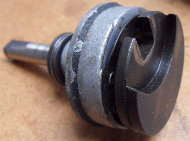

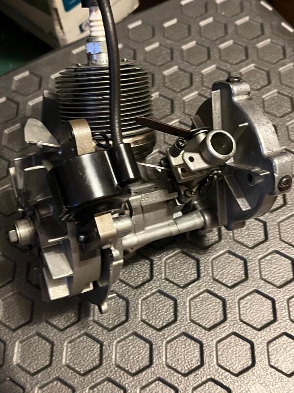

JUST O&R 237 #17 Posted January 23, 2024 Here is a pic of the aquqbug i did a few years back it shows the crankshaft 1 Wallfish reacted to this Share this post Link to post Share on other sites
Wallfish 718 #18 Posted January 23, 2024 31 minutes ago, JUST O&R said: Here is a pic of the aquqbug i did a few years back it shows the crankshaft Thanks! Has the flat on the side of the shaft like a chainsaw. I got plenty of those Share this post Link to post Share on other sites

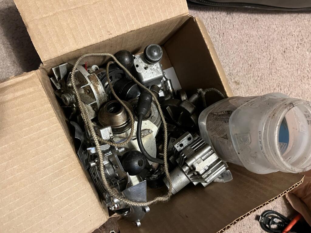

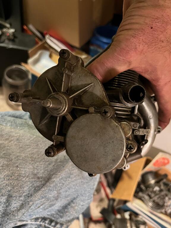

Wallfish 718 #20 Posted January 23, 2024 2 hours ago, CNew said: I gotta figure out what project to start next, got the O&R itch again! Ha, that's what happens when others get active and start posting stuff huh? Just get started as that' seems to be the toughest hurdle. Grabbed a box of more stuff. Found one of the 1600 rpm gearboxes attached to a parts engine. so might do that engine after inspecting it. IDK Has anyone made a new band for a TT generator? Need to make one and cut out a base for it too. Share this post Link to post Share on other sites
CNew 408 #21 Posted January 24, 2024 3 hours ago, Wallfish said: Has anyone made a new band for a TT generator? Are you taking about the metal strap that goes around the generator or the rubber handle/cushion? What tool would have used a 1600 rpm gearbox? Share this post Link to post Share on other sites

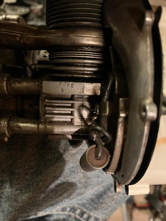

Wallfish 718 #22 Posted January 24, 2024 33 minutes ago, CNew said: What tool would have used a 1600 rpm gearbox? Actually 3300 rpm It's a Model G gearbox. Not common Yes, the metal strap Ohlsson & Rice Compact Industrial Engines Gear Cases Mar 1964-1.pdf Share this post Link to post Share on other sites
Wallfish 718 #23 Posted January 26, 2024 Type G engine rebuilt. New rings seals etc along with the gear box and a new seal in that. Ran out of good recoils and air baffles This had originally came with a weird rubber paddle fan attached so I put it back on Share this post Link to post Share on other sites

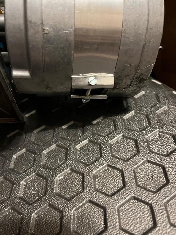

Wallfish 718 #24 Posted January 26, 2024 On 1/23/2024 at 7:50 PM, CNew said: Are you taking about the metal strap that goes around the generator or the rubber handle/cushion? A piece of aluminum flashing cut to size, folded on the edges for some strength and a screw to cinch it tight worked well. The flaps and screw don't look as nice as the latch thingy they used but once it's on the base it'll barely be visible anyway. Not sure about the shine of it so might dull it down a bit so it doesn't look out of place on there. Just need to cut a thicker piece of aluminum sheet for the base of which I do have a large piece of. Rebuilding engines is is going good so far as I'm up to 6 done. These 5 plus the Amp Champ. Share this post Link to post Share on other sites
CNew 408 #25 Posted January 27, 2024 Band strap turned out great! You’re cruising through these engines. Share this post Link to post Share on other sites
