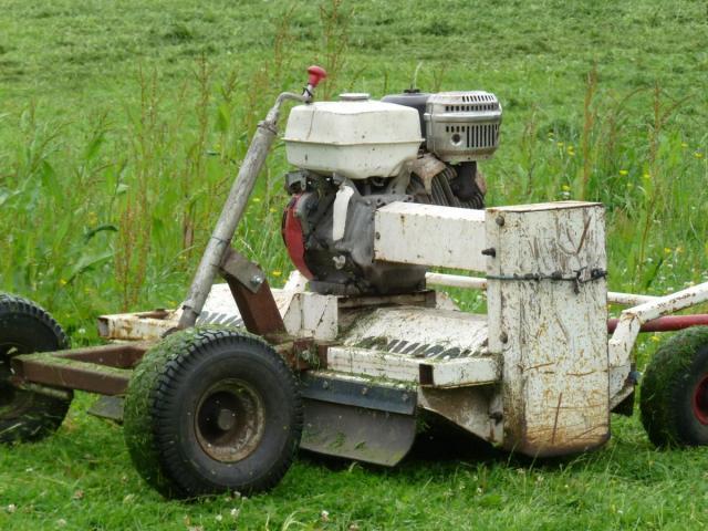

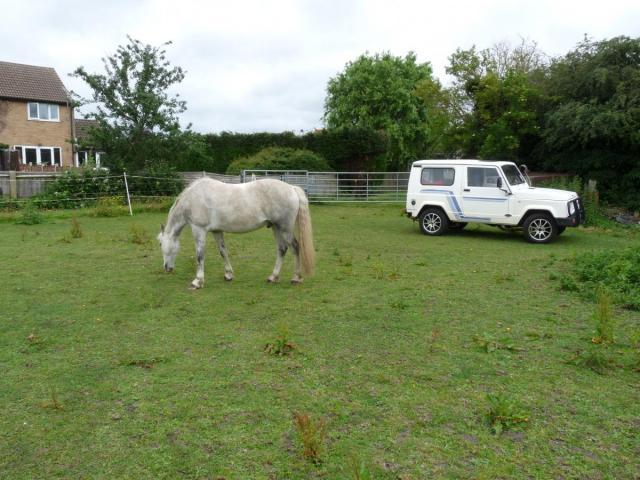

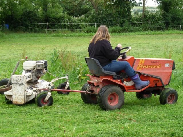

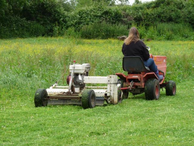

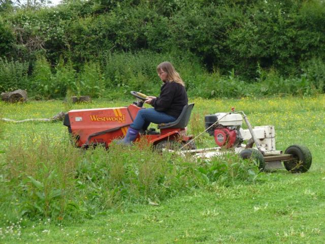

ranger 373 #1 Posted June 15, 2014 Our two four legged drive grass cutters-my wife on the Westwood towing the modified flail mower 2 nigel and Stormin reacted to this Share this post Link to post Share on other sites
Stormin 4,458 #2 Posted June 15, 2014 That flail mower looks some beast. I like the four leg drive piebald grass cutter as well. Share this post Link to post Share on other sites
meadowfield 1,901 #3 Posted June 15, 2014 I was just thinking that flail is quite a machine! Not quite as good as the horses.... Share this post Link to post Share on other sites
ranger 373 #4 Posted June 15, 2014 She`s a retired skewbald- got brown on her, not just the mud! The flail is a Rousseau front mounted unit for a quad. I fitted the front wheels from my 312-8 on a frame adjusted by an old jockey wheel jack, casters on the front and a 9hp Honda. I`ve just bought another BCS complete with flail and wood chipper/shredder attachments.pics when I get the chance. Share this post Link to post Share on other sites
the showman 4,074 #5 Posted June 15, 2014 Now I see where you got your name Share this post Link to post Share on other sites
Ian 2,417 #6 Posted June 16, 2014 Now I see where you got your name I think we should start calling Ranger Rick The tow behind flail mower looks like a handy bit of kit to have Share this post Link to post Share on other sites

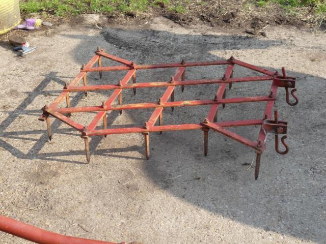

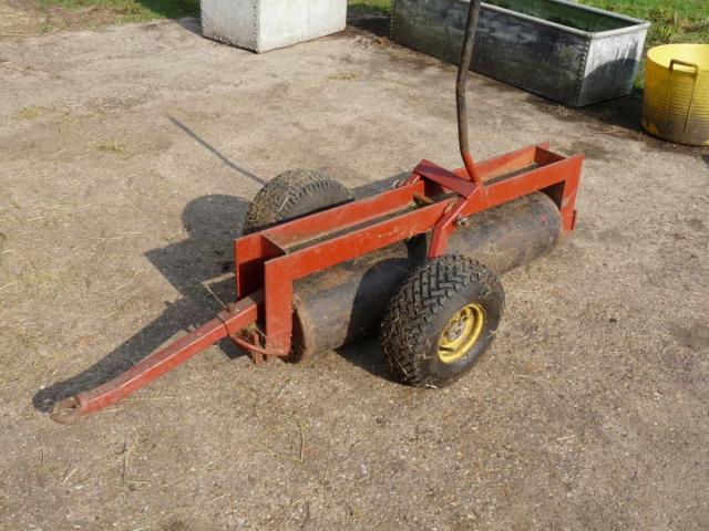

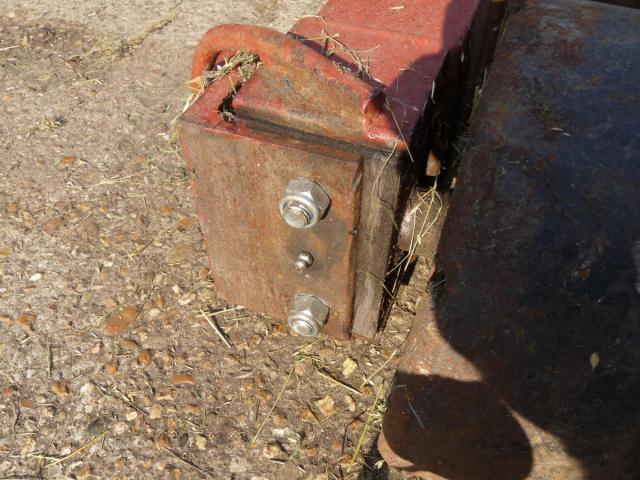

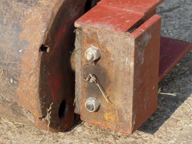

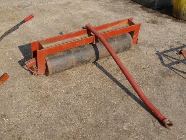

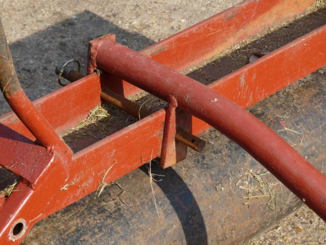

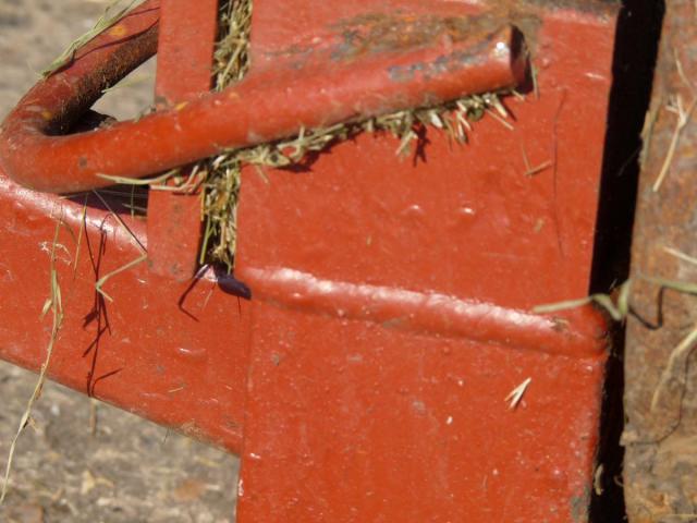

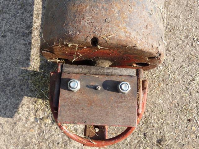

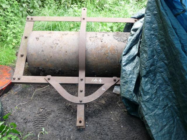

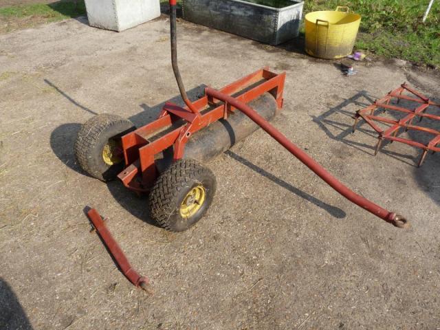

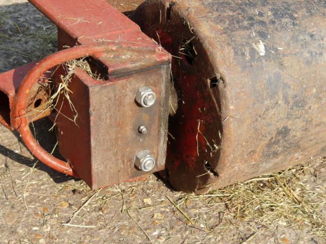

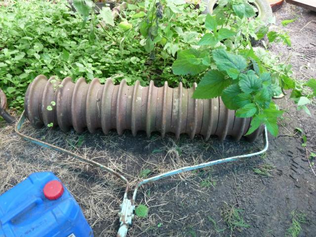

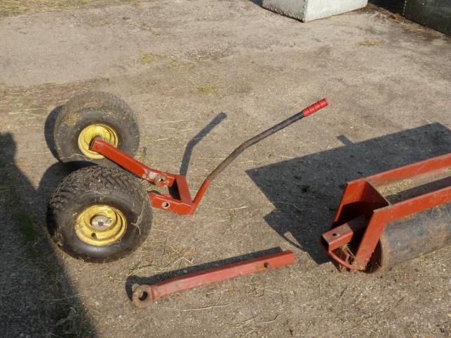

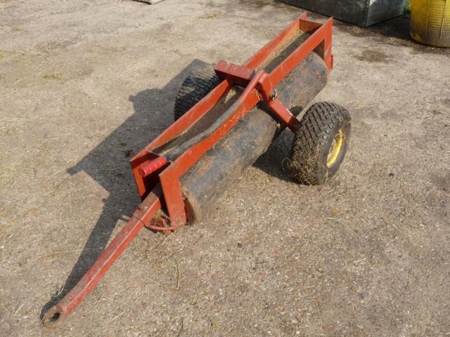

ranger 373 #7 Posted June 21, 2014 Should this be in the 'Home built items' section? Pulled this out of the spare stable/hay barn, I made this a couple of years ago out of an old oxy bottle, some scrap channel, an old oak fence post, (for bearings) J D front wheels and other assorted pieces from the 'come in handy' pile. My original intention was to make a smaller version of the fold up rollers the big boys use and pull it behind the Wheelhorse, but I ran out of spare bottles. With the wheels in place it fits nicely through the stable door. By pulling the lever the roll is lifted or lowered. The spike tooth harrow is one of a set of three I bought from the 'Cheffins' machinery sale a couple of months ago 3 Lauber1, Stormin and Ian reacted to this Share this post Link to post Share on other sites
Stormin 4,458 #8 Posted June 21, 2014 Ingenious. 1 ranger reacted to this Share this post Link to post Share on other sites
Ian 2,417 #9 Posted June 22, 2014 So great fabrication skills you have, a very nice build 1 ranger reacted to this Share this post Link to post Share on other sites
