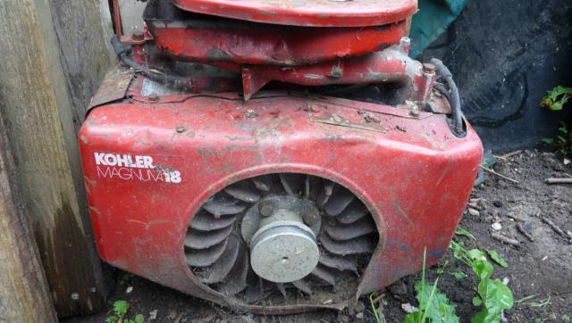

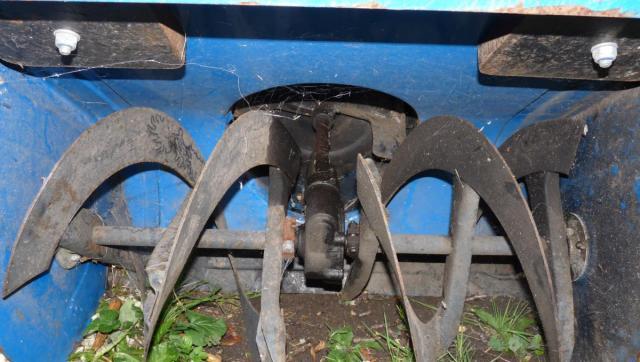

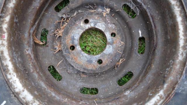

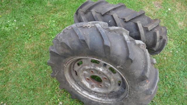

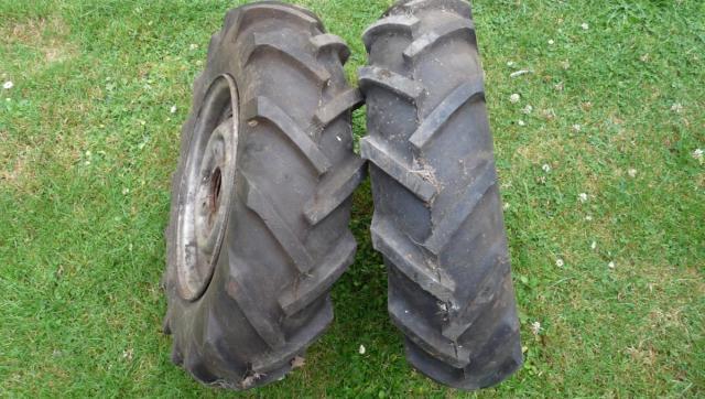

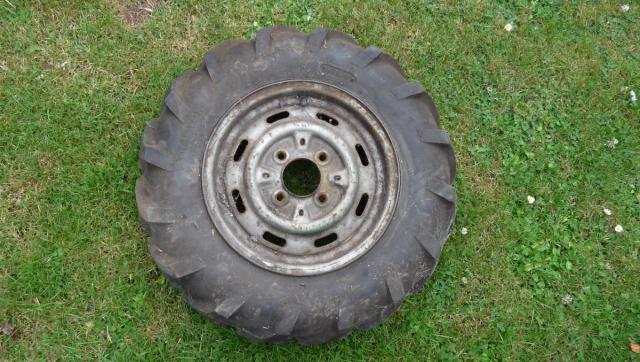

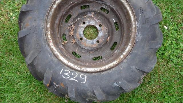

ranger 373 #105 Posted July 28, 2014 Hi Ian. These are the wheels and tyres I was going to use for the axle, I suddenly remembered I had them,fell over an old engine and snowblower to get at them, You may guess where they came from by the lot numbers! the wheels I think came off a late old type Mini 12" with a reinforcing plate on the back. 1 Ian reacted to this Share this post Link to post Share on other sites

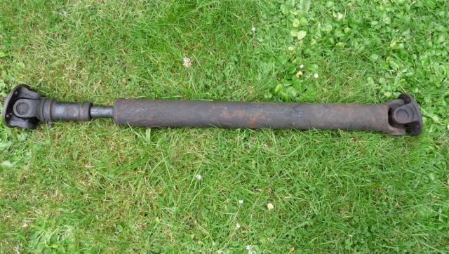

ranger 373 #108 Posted July 28, 2014 Back again, General Lee has been recovered (again) by the RAC. Bryan came round for advice. I asked the question and came away with a propshaft with duff u/j's 1 Ian reacted to this Share this post Link to post Share on other sites

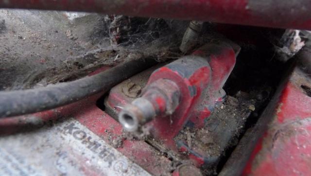

ranger 373 #109 Posted July 28, 2014 Hi Nigel, Does this look like the bit you want? and who's Kim? I was given the engine for nothing,so if it will help you out, Share this post Link to post Share on other sites
Ian 2,417 #110 Posted July 28, 2014 Hi Doug, you should build the Bonsor type truck, those wheels and tyres look ideal for the job Hi again, The chap with the Reliant can't use a phone let alone a computer, When he was busking,people would film him and put it on yt. You may find his clips easier by "Googling" "sawman" instead of searching in yt. There are I think a half dozen clips. He goes under the alias of "Bryan Brynn" he thinks the taxman will be after him! You wouldn't believe it but he makes anything from £25 to £70 in an hour. people probably pay him to go away. Thanks Doug, I will have to do some serious Googling and see if I can find him... That;s quite an hourly busking rate he is on! Back again, General Lee has been recovered (again) by the RAC. Bryan came round for advice. I asked the question and came away with a propshaft with duff u/j'sP1020019.JPG That's great Doug, can you thank Bryan for me I will pop you a PM shortly Share this post Link to post Share on other sites

nigel 1,880 #114 Posted July 29, 2014 Hi Nigel, Does this look like the bit you want? and who's Kim?P1020020.JPG I was given the engine for nothing,so if it will help you out, thats the one doug whos kim? i would be very gratefull for it please Share this post Link to post Share on other sites
ranger 373 #115 Posted July 29, 2014 Hi Nigel, when I hear from Ian regarding where to send the propshaft to, I'll put the pump in with it,is there anything else of the engine you need ? regards Doug. Share this post Link to post Share on other sites

ranger 373 #120 Posted August 1, 2014 I may have a couple of spare 12" wheels like the ones with the ag tyres on, you could widen them or swap the centres over. or you may be able to bore a pair of wheelhorse hubs to suit the reliant shaft. 1 Ian reacted to this Share this post Link to post Share on other sites
Ian 2,417 #121 Posted August 1, 2014 looking good Ian what are the measurements for the adapter plates? and how are you thinking of doing those? bolt em together? if so put a brake disc inbetween em, bit better than drums eh. Koen Thanks Koen, no idea on the measurements yet, I've been to busy nursing my poorly wife this morning and welding the 6x6 this afternoon.. There are disc conversion kits make for this axle.. I wonder what pcd they have? I may have a couple of spare 12" wheels like the ones with the ag tyres on, you could widen them or swap the centres over. or you may be able to bore a pair of wheelhorse hubs to suit the reliant shaft. Thanks Doug, a pair of 12" wheels that bolt straight on would open up a few more options.. I'd best reply to your PM The Reliant axles are tapered at the hub end which would make them interesting getting a Wh hub on, but they do have a keyway.. That's maybe another option. Share this post Link to post Share on other sites
