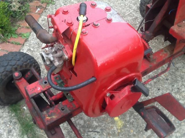

Charlie Smith 192 #18 Posted August 12, 2014 Good news for now,...after a little tinker about and a few quid for a little few parts, fuel line, plug etc the little tecumseh h60 is now up and running, in top shape, sourced an air filter now just after a little pepper pot exhaust off the bay, Pulleys ayy, finding it difficult to source one the right size ATM. 3 ranger, pmackellow and Ian reacted to this Share this post Link to post Share on other sites
