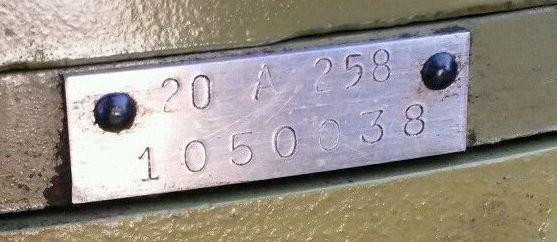

factory 487 #8 Posted August 17, 2016 (edited) Looks like my Challenger Mark IID chain saw is fitted with a Walbro HDC6 carb, I will have to double check tomorrow as the picture isn't very clear. Are there any other bits missing? Also is the engine type the same as mine, 20A-258? It should be on a plate like this. David Edited August 18, 2016 by factory Corrected carb part no. Share this post Link to post Share on other sites

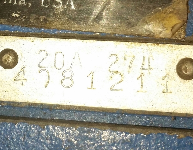

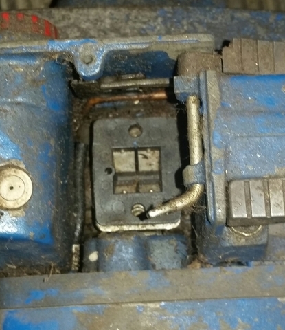

Dap1961 6 #9 Posted August 18, 2016 Here's my tag and the carb compartment. Share this post Link to post Share on other sites
factory 487 #10 Posted August 18, 2016 Your engine is model 20A-274, so there are probably some slight differences to mine, I suspect the starter mechanism will be different as mine has the early type. I took the carb off mine for a better look at the model number, the carb fitted is a Walbro HDC6 (I've corrected the previous post). Also I have found the first error with the model 20A maintenance manual, as the carb has a right angle fuel inlet and the manual shows an incorrect carb model no. below the picture. Here are some pictures of the carb and the other parts you may be missing. I thought mine was complete but it seems the fuel lines to the carb are missing. The tank outlet is hidden under the starter mechanism housing. David Share this post Link to post Share on other sites
