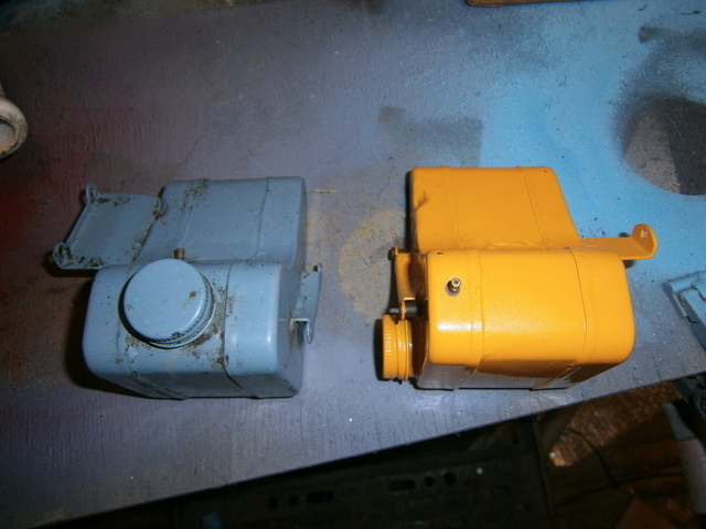

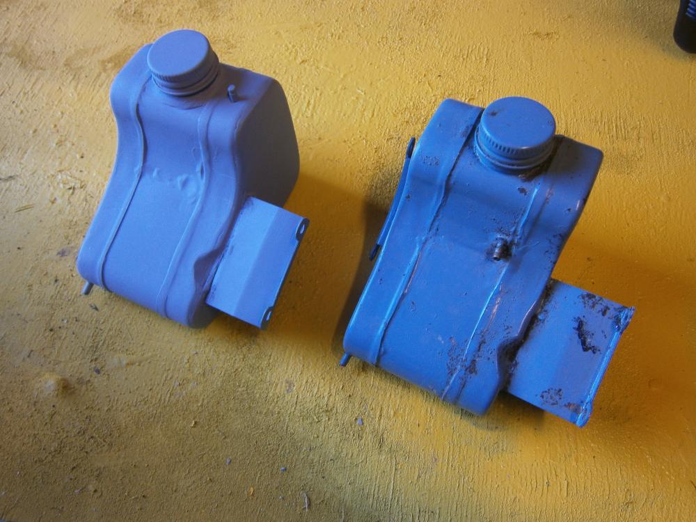

pmackellow 2,738 #26 Posted November 14, 2016 Tank has arrived, many thanks to Webhead Just need to get it looking the same as the blue one now... Share this post Link to post Share on other sites

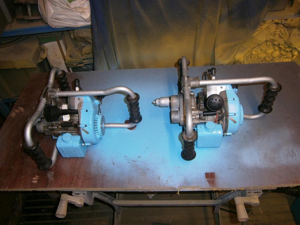

pmackellow 2,738 #27 Posted February 9, 2017 These units have not been forgotten, still waiting for the second tank to be done and have been busy with the Orline compressor set Share this post Link to post Share on other sites

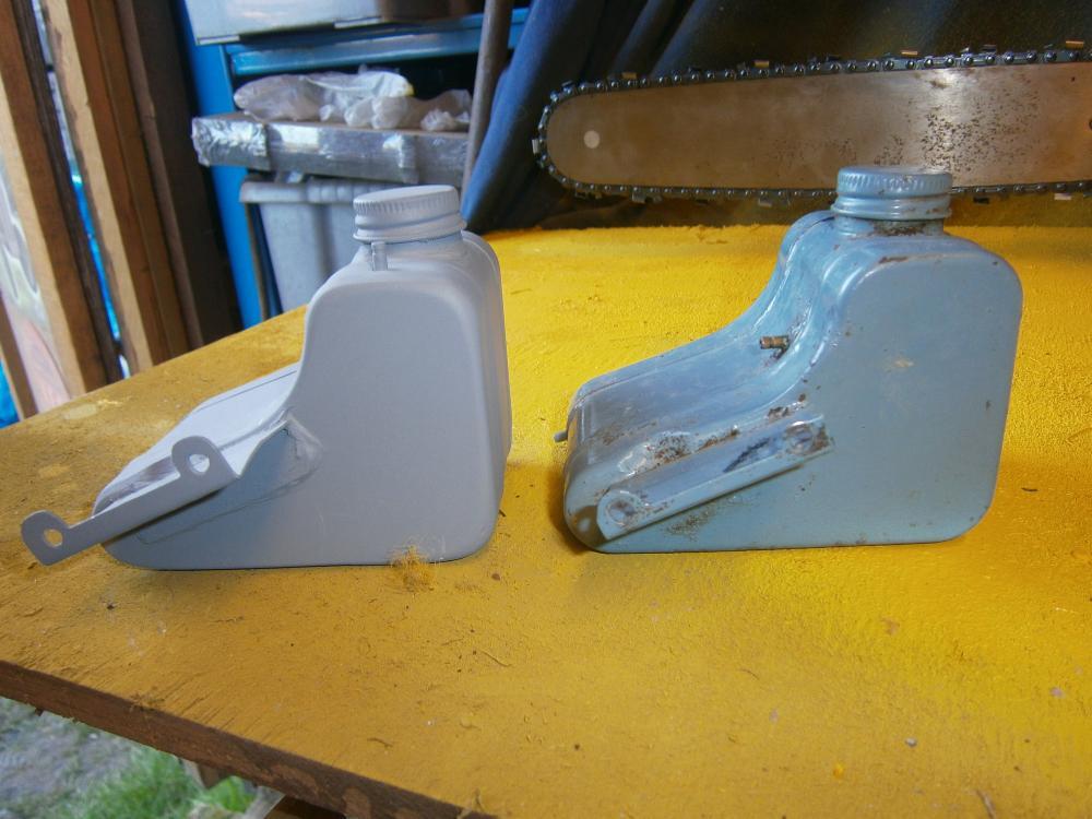

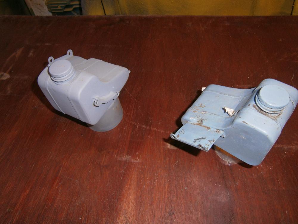

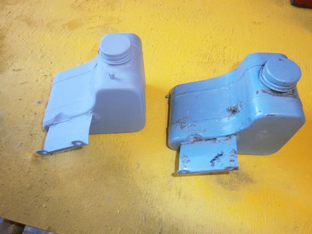

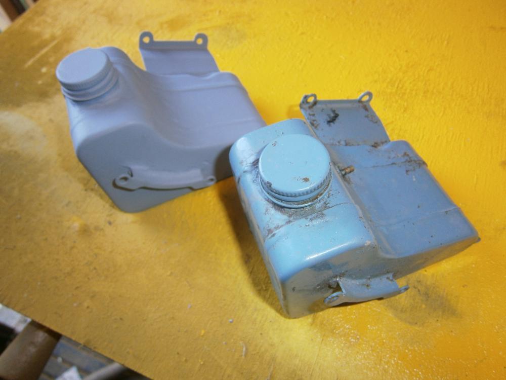

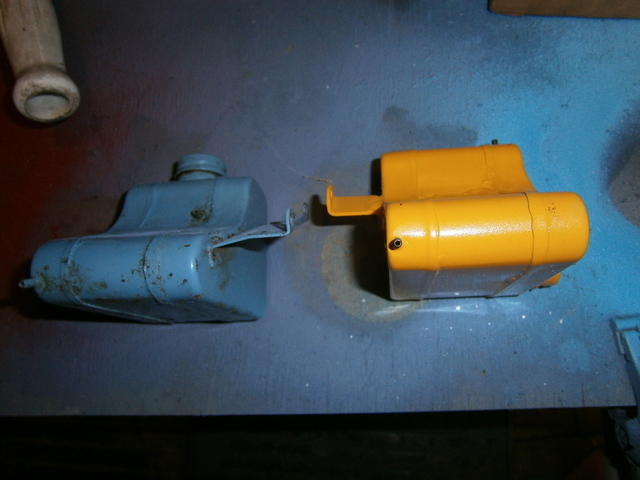

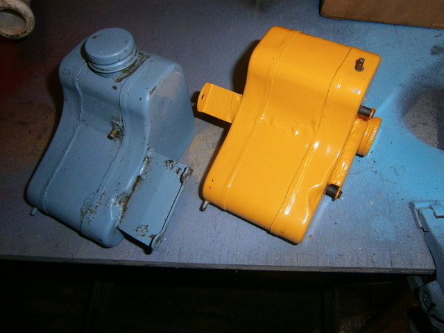

pmackellow 2,738 #28 Posted February 18, 2017 Second tank collected today, looks good... (original is on the right in first photo) 5 Wallfish, factory, Cub Cadet and 2 others reacted to this Share this post Link to post Share on other sites
Wallfish 718 #29 Posted February 18, 2017 Nice job! Did you solder that stuff or use something else? 1 pmackellow reacted to this Share this post Link to post Share on other sites
pmackellow 2,738 #30 Posted February 18, 2017 2 hours ago, Wallfish said: Nice job! Did you solder that stuff or use something else? The chap that did it used chemical metal to bond the brackets 1 S1g reacted to this Share this post Link to post Share on other sites

Wallfish 718 #35 Posted February 20, 2017 Well I know J-B weld won't hold up to gasoline very long no matter what the manufacturer says. Personal experience. Loctite states this stuff is "resistant" to fuel but I think J-B states that too. Hope it does, it will be useful. The stuff usedtoolman suggested does hold up to gasoline but can't use it for attaching things. It's called Lab Metal Share this post Link to post Share on other sites

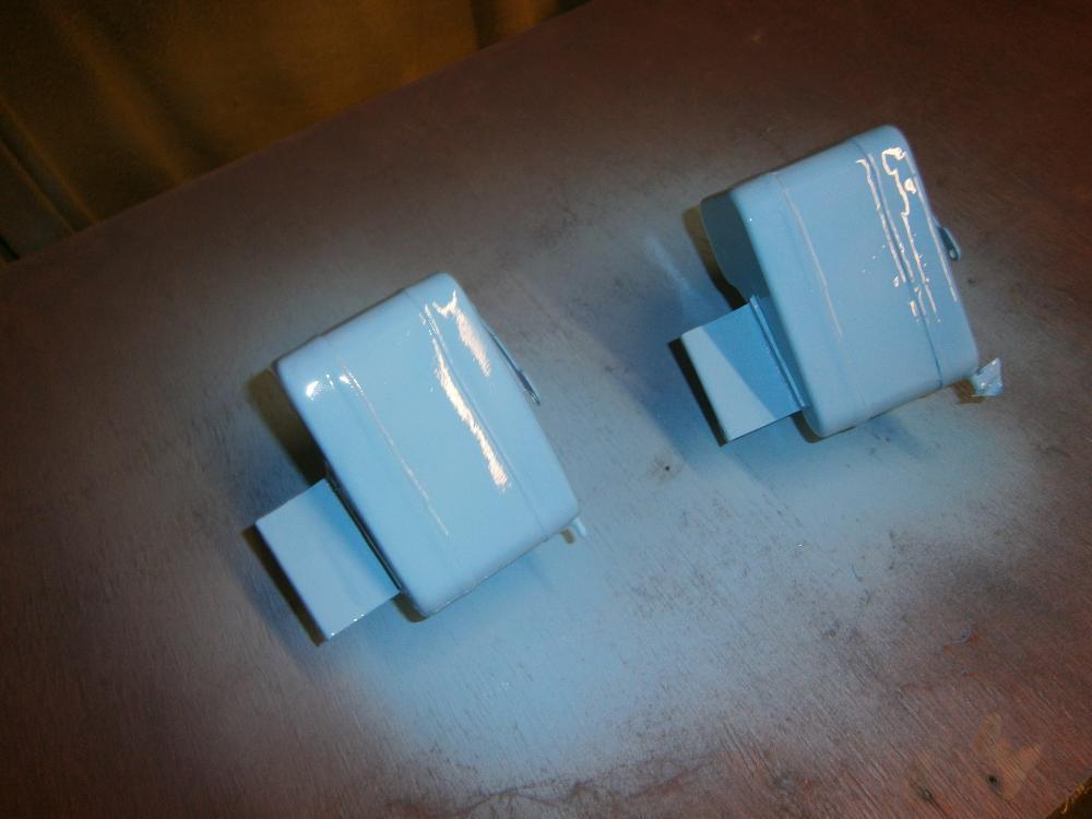

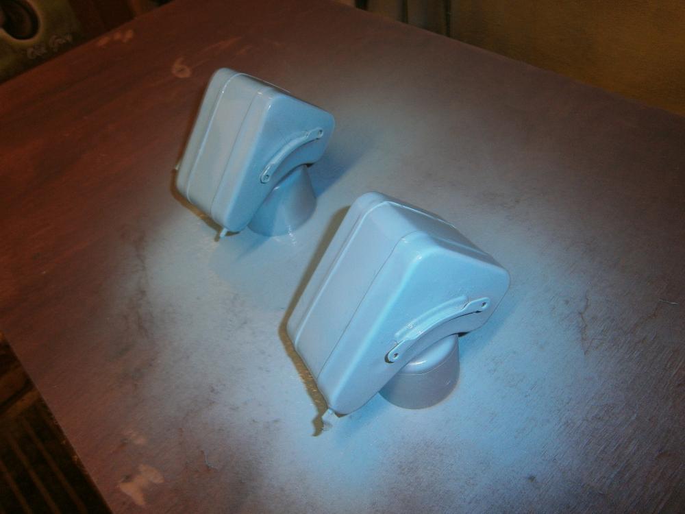

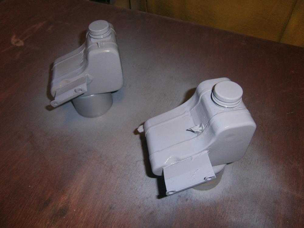

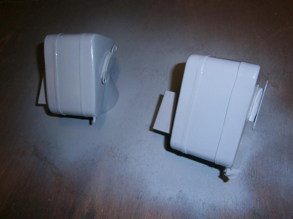

pmackellow 2,738 #36 Posted March 7, 2017 Painting the tanks this evening... 2 S1g and the showman reacted to this Share this post Link to post Share on other sites
the showman 4,074 #37 Posted March 7, 2017 Gotta good shine on them. 1 pmackellow reacted to this Share this post Link to post Share on other sites
pmackellow 2,738 #38 Posted March 8, 2017 18 hours ago, the showman said: Gotta good shine on them. Not bad for Halfords rattle cans Share this post Link to post Share on other sites

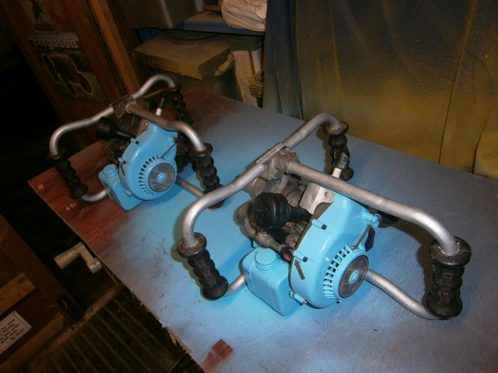

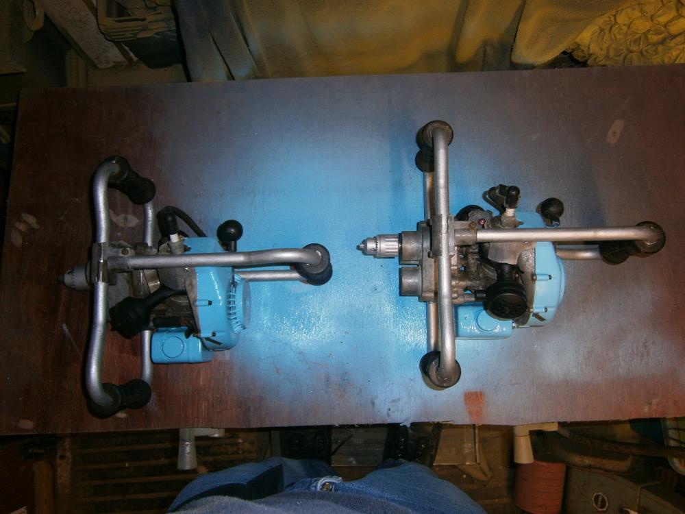

pmackellow 2,738 #39 Posted March 9, 2017 Tanks back on, bit more fettling to do and they will be ready for Newbury show... 1 Wallfish reacted to this Share this post Link to post Share on other sites

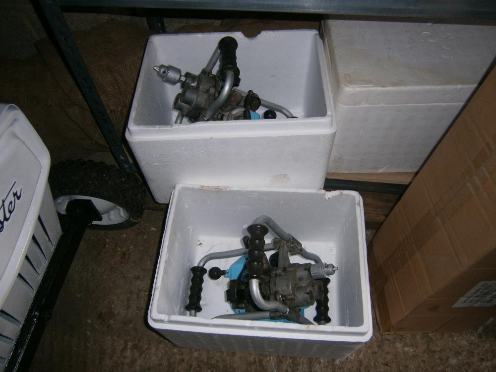

pmackellow 2,738 #40 Posted March 10, 2017 Boxed up and at the storage unit until they are next needed... Share this post Link to post Share on other sites
