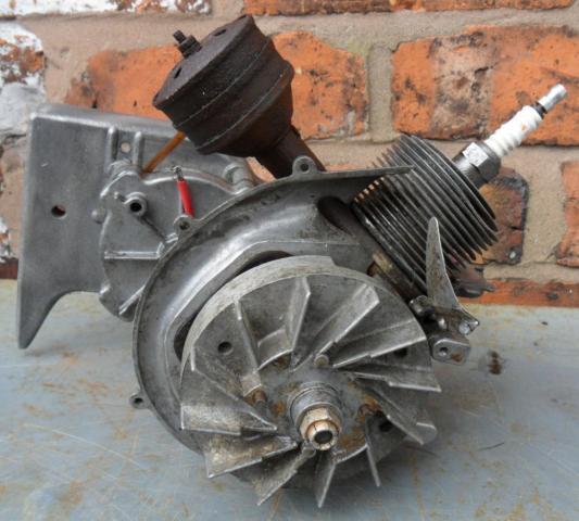

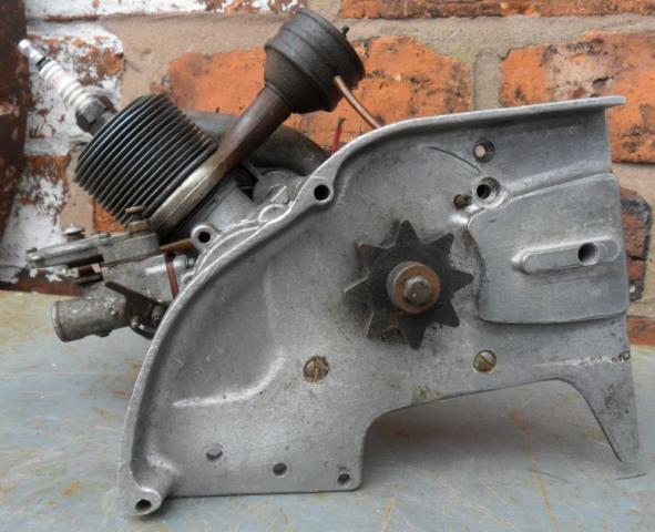

factory 487 #2 Posted November 17, 2015 (edited) Another UK find that I bought earlier this year, seems to be the remains of a Chug-A Saw, sadly the seller didn't have any other bits of it. The engine serial no. is within 1000 of the two Chug-A-Drills I have. David Edited November 17, 2015 by factory 2 pmackellow and Wallfish reacted to this Share this post Link to post Share on other sites

Wallfish 718 #5 Posted April 5, 2020 Bodger It would certainly help to know your location as you didn't fill it in when joining. The pic shows it's also missing a starter paw and I would strongly suggest you go through the engine to determine any other parts needed. I can guarantee it will not be a gas go situation if the saw is still in that condition. You'll need a carb diaphragm at minimum too. Clean points etc. I'm sure we can help! Share this post Link to post Share on other sites

factory 487 #11 Posted April 5, 2020 Merged the two threads, it isn't necessary to post requests twice. 15 minutes ago, Wallfish said: You are the person which scored the saw we were discussing in this thread I was wondering when that saw would reappear, it was advertised on farcebook. 26 minutes ago, Bodger said: Hello there. I am based in the uk where these items seem impossible to find! I know I am going to need various items but it has good compression. really I need the starter pawl. Pull starter assembly complete, the tank. I will be stripping further in the next few days just wanted to see if the large items were available before I start. thanks The starter pawls for the older flywheels are impossible to find, they aren't held in place like the later ones so often go missing, I've had to fit a later flywheel and make a custom sized flywheel key as the sizes are different too. My Chug-A-Saw has a damaged starter too, the early ones are a bit fragile, a later one could be used, but they need modifying to fit the older magneto coil. I would keep an eye out for another engine myself as what's left looks in very poor condition, they do appear in the UK occasionally. David Share this post Link to post Share on other sites
Bodger 5 #12 Posted April 5, 2020 Thanks david. I am just trying to get used with using this site! I am confident I can make a new starter pawl, but yes I was thinking it will be easier to find another engine. I am going to clean the carb when I get a chance and fit a wrap around rope pull for now to see if it will fire. it feels to have good compression, just need to see if it will spark. Thanks andy Share this post Link to post Share on other sites
factory 487 #13 Posted April 5, 2020 I will see if I have a spare later starter, you will probably need a new carb diaphragm too as has already been mentioned. Also clean out the old crumbly foam from the air cleaner before attempting to run the engine, if the foam dust gets inside it can make a right mess. David Share this post Link to post Share on other sites

Bodger 5 #15 Posted April 7, 2020 On 4/5/2020 at 2:26 PM, factory said: Merged the two threads, it isn't necessary to post requests twice. I was wondering when that saw would reappear, it was advertised on farcebook. The starter pawls for the older flywheels are impossible to find, they aren't held in place like the later ones so often go missing, I've had to fit a later flywheel and make a custom sized flywheel key as the sizes are different too. My Chug-A-Saw has a damaged starter too, the early ones are a bit fragile, a later one could be used, but they need modifying to fit the older magneto coil. I would keep an eye out for another engine myself as what's left looks in very poor condition, they do appear in the UK occasionally. David Hello there. I believe you may have carb diaphragms available. Would I be able to purchase 2 please Share this post Link to post Share on other sites

factory 487 #18 Posted April 7, 2020 8 hours ago, Bodger said: I have just bought this today too! So I can swap parts to try the chainsaw but still on the hunt for a pullstart, diaphragms, and ad a chainsaw tank. Thanks andy Hi Andy, You've found the remains of a Turbair crop sprayer, it's missing a few parts including the blade guarding, but at least it does have the manual which is often missing. Yes I have new diaphragms & have located a used starter (slightly later) from my spares, I would suggest you go through the engine to make sure nothing else is required. Also have a look to see which type of check valve gasket is used, if it's not the clear plastic version you might need to change that too, see the carb thread for more information. David P.S. I can't go out at the moment, so will have to rely on someone else to post any parts out to you. Share this post Link to post Share on other sites

factory 487 #20 Posted April 7, 2020 No you need part A-139, which are unobtainable as I found out a few years ago repairing the engine from a Chug-A-Pump, here is the picture I posted then showing the two types. I have had to change the flywheel on a few engines to the later type as a result and had to make a new in-between sized flywheel key too. There is a spare later flywheel here if needed, though it would be easier to use that spare engine he's just bought. David Share this post Link to post Share on other sites
JUST O&R 237 #21 Posted April 7, 2020 The a-139 is like the one I have it has that same peace of spring steel The a-139-2 that I have a small stack of . The one on Bodger saw looks like it has the aluminum peace that holds the spring in. The pic is not very clear but I see now that I look harder the flywheel is defendant too. Share this post Link to post Share on other sites
Bodger 5 #22 Posted April 7, 2020 45 minutes ago, factory said: No you need part A-139, which are unobtainable as I found out a few years ago repairing the engine from a Chug-A-Pump, here is the picture I posted then showing the two types. I have had to change the flywheel on a few engines to the later type as a result and had to make a new in-between sized flywheel key too. There is a spare later flywheel here if needed, though it would be easier to use that spare engine he's just bought. David 1 hour ago, factory said: Hi Andy, You've found the remains of a Turbair crop sprayer, it's missing a few parts including the blade guarding, but at least it does have the manual which is often missing. Yes I have new diaphragms & have located a used starter (slightly later) from my spares, I would suggest you go through the engine to make sure nothing else is required. Also have a look to see which type of check valve gasket is used, if it's not the clear plastic version you might need to change that too, see the carb thread for more information. David P.S. I can't go out at the moment, so will have to rely on someone else to post any parts out to you. That’s great! I will strip the chainsaw and assess further to see what else is required. I will update once stripped and go from there. Many thanks. Andy Share this post Link to post Share on other sites
factory 487 #23 Posted April 7, 2020 43 minutes ago, JUST O&R said: The a-139 is like the one I have it has that same peace of spring steel The a-139-2 that I have a small stack of . The one on Bodger saw looks like it has the aluminum peace that holds the spring in. The pic is not very clear but I see now that I look harder the flywheel is defendant too. The dimensions are slightly different between the two, the middle part is longer on the A-139 starter dog, I haven't got one to check but from memory the hole is bigger on the A-139-2 starter dog. Perhaps we need to know the serial number of the engine to confirm which flywheel & starter dogs it has. David Share this post Link to post Share on other sites
factory 487 #24 Posted April 8, 2020 I've had a look at the serial numbers on my Petro saw, the saw number is lower than @Bodger's saw and my engine is approx #062000 (quite a bit newer than the pump I was referring to the other night). If it's of a similar age then it probably does use the later A-139-2 starter dogs, measuring the remaining one would confirm this. David Share this post Link to post Share on other sites
