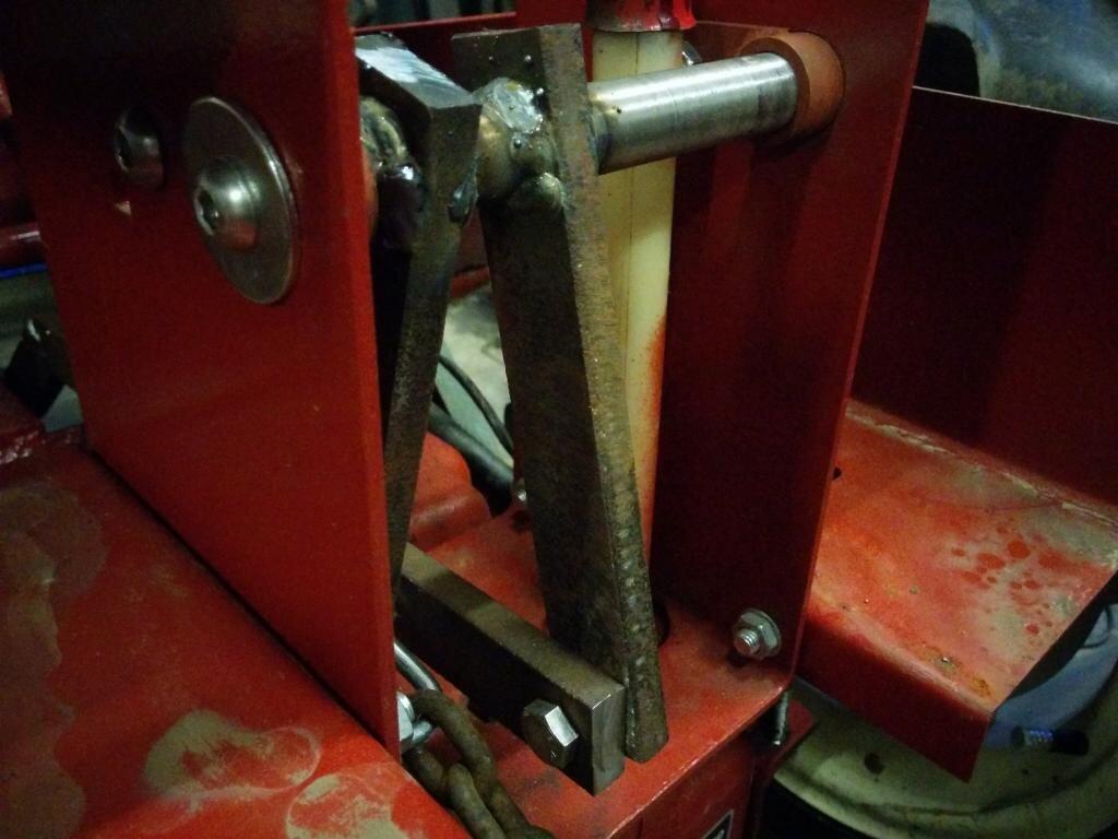

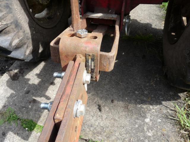

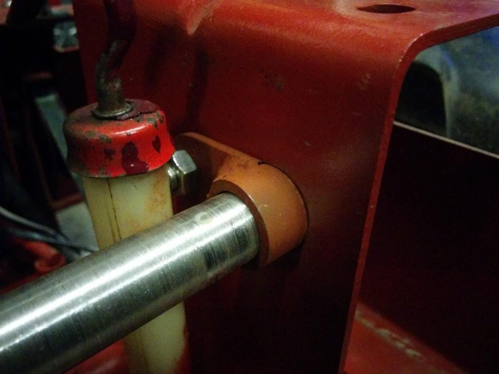

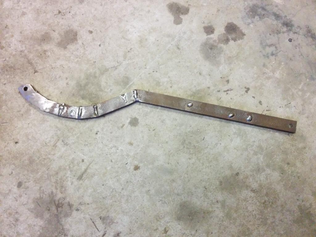

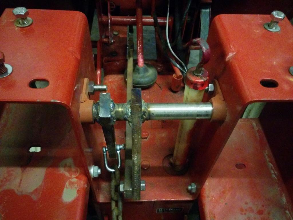

meadowfield 1,901 #1 Posted January 4, 2015 To follow up my plough conversion, here's the lift assembly needed. Firstly the beefy bar to run from the deck lift arm. Then two bushes for the rocker shaft Then a piece of 18mm bar for the shaft with the ends threaded to retain it. It all fits nicely with the fuel tank in place. And the view from above with the link bar in place. And with the plough fitted. 7 ranger, OldBuzzard, slf-uk and 4 others reacted to this Share this post Link to post Share on other sites
Tom 215 #2 Posted January 4, 2015 Thanks for posting this up Mark, really good idea and fabrication. Ignore me if I'm being stupid but does the lift bar you made interfere with the gear selector? It just looks a bit close in picture 4. Tom Share this post Link to post Share on other sites
meadowfield 1,901 #3 Posted January 4, 2015 Thanks for posting this up Mark, really good idea and fabrication. Ignore me if I'm being stupid but does the lift bar you made interfere with the gear selector? It just looks a bit close in picture 4. Tom Well spotted, when we take it off for painting it needs a bit grinding off the side when the lift is up as it makes third gear hard to select But an easy fix.... Share this post Link to post Share on other sites

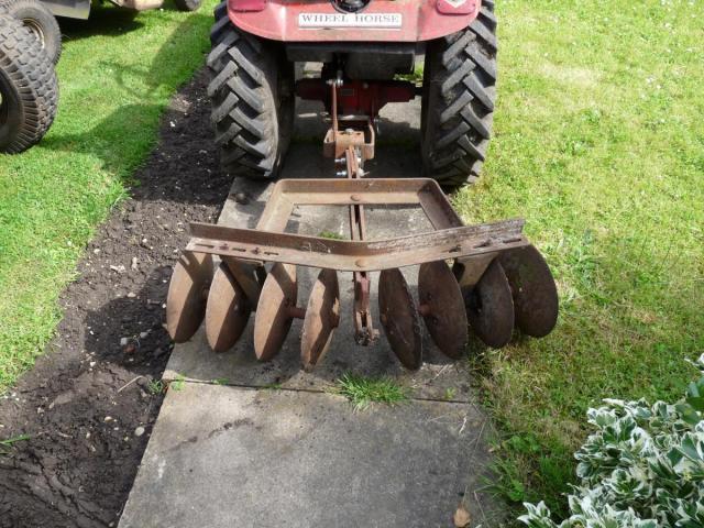

ranger 373 #6 Posted January 4, 2015 Nice job Mark :thumbs: I did mine on the C121 pretty much the same, but used a round bar rod from the lift to the rocker shaft, & used spherical rod ends with left & right hand threads from the R/shaft to the hitch. I think I used flanged 'Oilite' bushes for the R/shaft, the clevis hitch I made myself, You'll never guess where the parts originated from Only photos I can find at the moment 2 Triumph66 and OldBuzzard reacted to this Share this post Link to post Share on other sites
meadowfield 1,901 #7 Posted January 4, 2015 Hey Doug, that's pretty neat... still looking for a set of WHdiscs Share this post Link to post Share on other sites

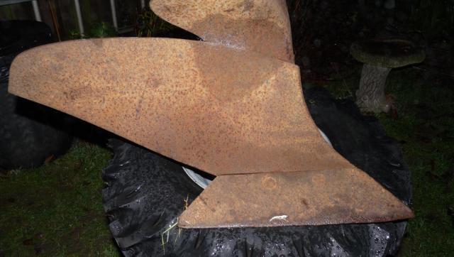

ranger 373 #8 Posted January 4, 2015 This is the one that comes as a three piece set, plough, discs & cultivator. I don't have the plough though, I do have a stubble plough assembly I can modify to fit the frame, when I can find the time. The piece on the top of the mouldboard unbolts. If anyone is interested in one of these,try Westlake plough parts near Peterborough, they may still have some Share this post Link to post Share on other sites
