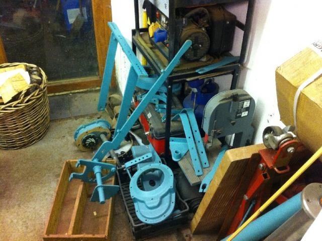

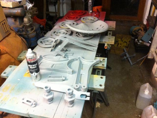

expeatfarmer 591 #85 Posted November 11, 2015 Just working my way through each and every component with final primer coats. I wish I had kept count of just how many individual components there are! Share this post Link to post Share on other sites
Rocboni 257 #86 Posted November 11, 2015 Are you painting everything with a rattle can? You get much better coverage and A better finish with a gun but you have to have everything hung ready to do it all in one go. Share this post Link to post Share on other sites
expeatfarmer 591 #87 Posted November 13, 2015 I have both but choose small batches down on a bench to keep the spray drift under control, I have sprayed many parts outside but now it is too cold. As I tend to work on a couple of components at a time repairing or restoring I take each one to primer stage and then put it away for later re assembly if I use a gun I would be forever cleaning it up. 1 Anglo Traction reacted to this Share this post Link to post Share on other sites

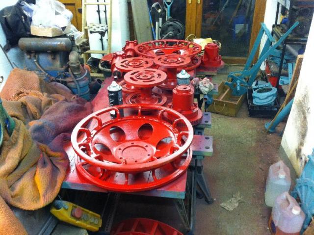

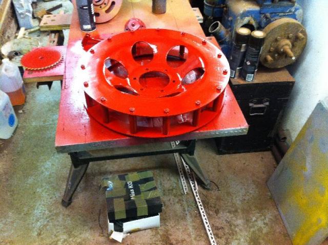

expeatfarmer 591 #88 Posted November 13, 2015 Reached a milestone today finally managed to complete the rebuild and paint of the drive wheels I seem to have been on with them for months. Having to be careful that I dont get carried away with finish I keep looking at other original machines to see what level of marks/gouges etc were sent out from the factory I do not want it to be better than original I just want original and that means defects. Skimming with filler to reduce the pitting is a chore but the effects are very pleasing. 3 nigel, Stormin and Rocboni reacted to this Share this post Link to post Share on other sites

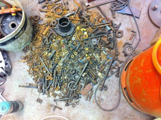

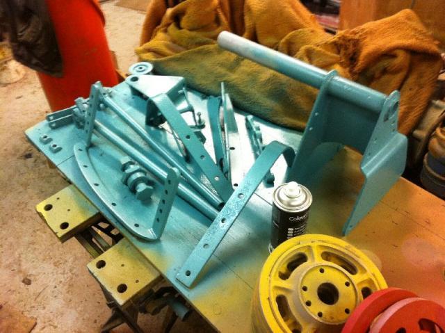

expeatfarmer 591 #89 Posted November 18, 2015 This week so far I have rebuilt the track load rollers with new bearings and seals,, final drive output shafts and hubs new bearings and seals, rebuilt the cooling fan, rubbed down filled and painted all the red bits, finished all the bolt on blue bits, made up some new track tensioners and generally made a mess of my workshop. Gradually sorting through the pile of rusty nuts and bolts that came with 137 matching what I need to the parts list, where practical I am re using clean existing nuts and bolts but any that are badly damaged by rust or past abuse I am replacing with new. Chris at vintage brass plates is making up a new set of id plates for the body and a new plate for the Sturmey Archer engine, Titch is making up a set of decals for the body. 137 had scroll decals on either side which I guess are from lawnmowers and sadly no decal on the tank front so tempting though it is to add a few more for looks I am currently sticking with what is shown in the period photos. The same goes for things like mudguards over the track rollers and wear plates protecting the final drive casings, both of which were added to the 1937 models. 3 Stormin, hpearce and nigel reacted to this Share this post Link to post Share on other sites

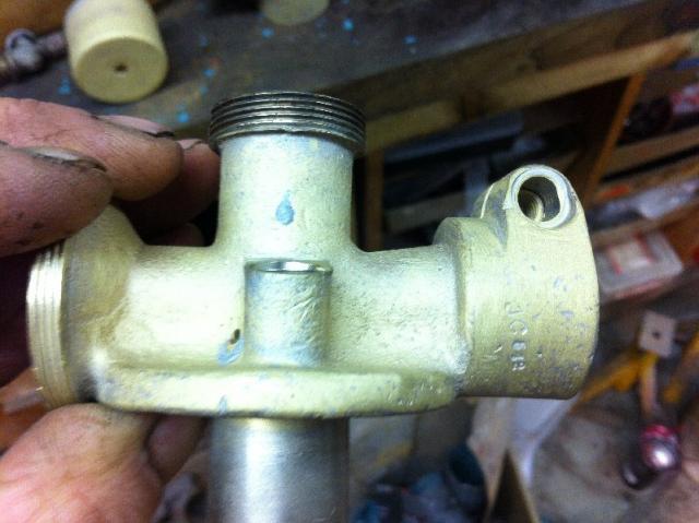

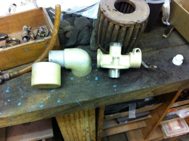

expeatfarmer 591 #90 Posted November 19, 2015 Today I have been restoring the carburettor which is a brass cast Amal nickel plated. Over the years it has been bruised and bashed and had a number of nasty vice marks. I polished these out with my Dremel but did not like the shiny finish as the original would have been peat flour sand cast. After a bit of thought I dug out some brass plumbing fittings and polished them up with the Dremel and then shot blasted them with glass beads to see what effect it produced. Very pleasing effect and by a strange coincidence the carb is stamped "JC 648" must be an omen! Next job is to Nickel plate it . 2 Stormin and hpearce reacted to this Share this post Link to post Share on other sites

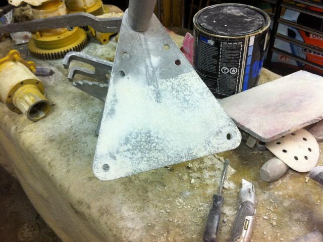

expeatfarmer 591 #91 Posted November 25, 2015 Becoming quite frustrated with my painting, for some reason the areas of filler are showing through on the top coat despite rubbing down with 800 grit, high build primer coat rubbed down again and then top coated twice, anybody have any idea as to what I might be doing wrong? After spending the best part of two days solid on the cowling it is now looking half decent I have sprayed it with a guide coat tonight with a view to a final rub down fill and paint in the morning. I don't want the same to happen on the cowling or it will look awful. Share this post Link to post Share on other sites
Rocboni 257 #92 Posted November 25, 2015 Might be the rattle cans and the light colour? How many coats have you tried? Only thing is its been ok on everything else. Share this post Link to post Share on other sites
Stormin 4,458 #93 Posted November 25, 2015 I was thinking if a light colour was being used, then the filler may show more than a dark one. Maybe some shade of undercoat after the primer? Share this post Link to post Share on other sites
C-101plowerpower 548 #94 Posted November 25, 2015 I have the same on the bonnet of my Horse, bodywork guy said it was because the humidity, cant remember if it was to high or to low, i think it was too high Share this post Link to post Share on other sites
expeatfarmer 591 #95 Posted November 26, 2015 Thanks, it does the same thing on the red paint too and I have a de humidifier running 24/7, it may be because I am using a satin finish rather than a full gloss. I will ring the supplier today and see what they say . Share this post Link to post Share on other sites
Anglo Traction 1,022 #96 Posted November 26, 2015 I've also had problems with delayed isolated reactions under Top Coats from Fillers and Hi build Primers. Never found a reason for it, or why it was so inconsistent. Will be interesting if you get an answer. Share this post Link to post Share on other sites
expeatfarmer 591 #97 Posted November 28, 2015 stangly if i used a gloss topcoat no problem Share this post Link to post Share on other sites
nigel 1,881 #98 Posted November 28, 2015 Got to be the matting agent they put in I would have thought Share this post Link to post Share on other sites

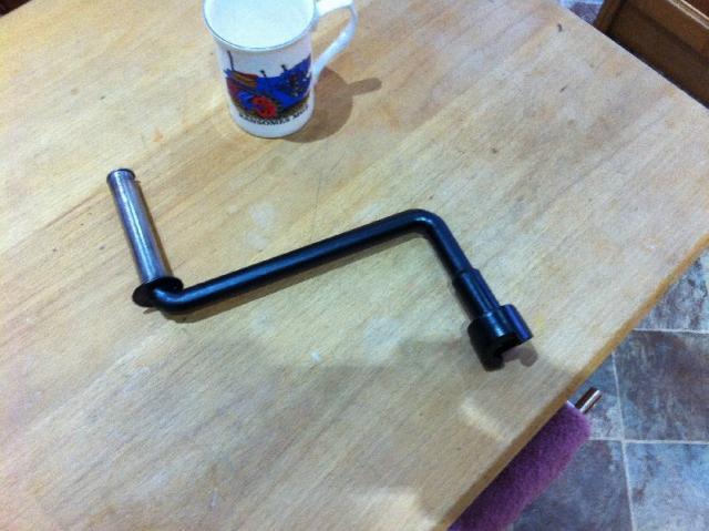

expeatfarmer 591 #99 Posted November 30, 2015 Made a new starting handle yesterday 1 nigel reacted to this Share this post Link to post Share on other sites
