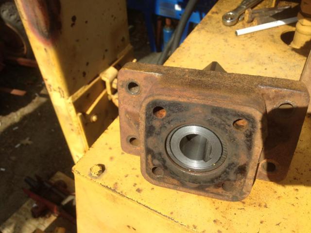

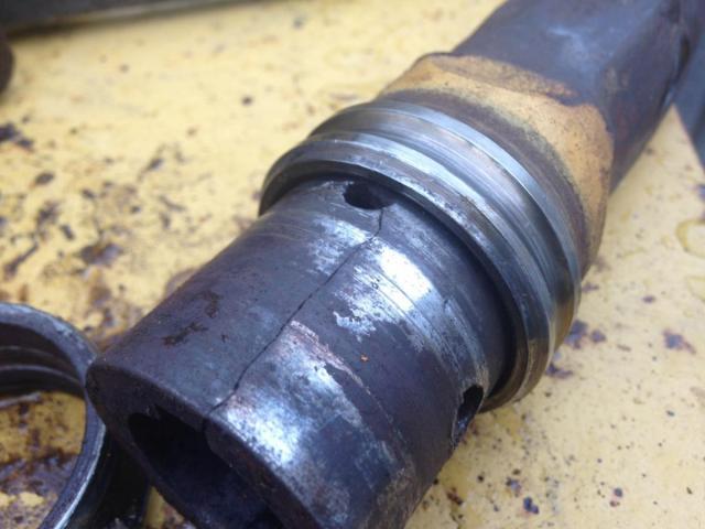

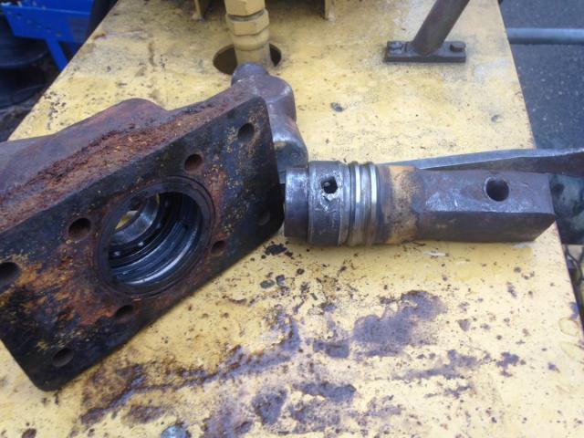

Wallfish 717 #7 Posted May 9, 2015 I discovered some problems with this machine. The channel for the auger drill carriage to ride up and down in was bent and bowed. That needed to be removed and bent back into shape so the carriage would not wobble around while drilling. It was causing the hole to widen out and allow the dirt to fall back into the hole instead of falling out to the sides. Then I noticed a worn bearing in the auger drive. Turned out that one of the bearings was completely blown apart and also discovered the shaft which drives the auger drill is cracked along the length of the keyway. Thought about cutting a V into the crack and welding it but decided to have a new shaft made. Good thing I know a retired machinist with a shop full of machines. Share this post Link to post Share on other sites

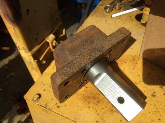

Wallfish 717 #9 Posted May 17, 2015 My friend Jim (usedtoolman) really hooked me up. He is a talented, retired machinist with nice shop full of tools and was able to machine a completely new shaft. Also made a new heavier spacer and installed 2 new bearings. Got it installed but still need to give it a test run, hopefully tomorrow. Share this post Link to post Share on other sites
