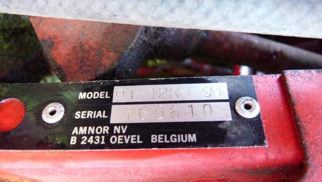

Wristpin 400 #9 Posted May 21, 2015 Think that the Belgian made machines had "Amnor" on their ID plates. Share this post Link to post Share on other sites
ranger 373 #10 Posted May 22, 2015 on my 1979 C 121 Share this post Link to post Share on other sites
mowerdar 98 #11 Posted May 22, 2015 On my 72 raider 12 Share this post Link to post Share on other sites
