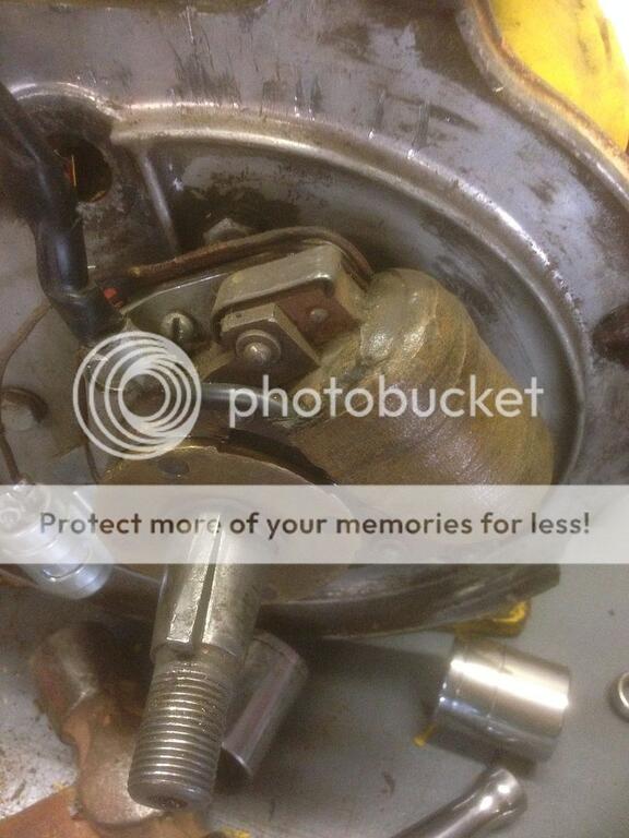

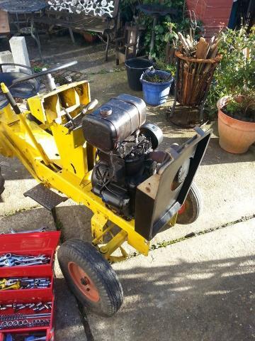

Tom 215 #33 Posted May 26, 2015 Had the engine on the bench today and inspected further into it. Not great news unfortunately, bearing plate is broken on the side; I'm presuming where someone has tried to lever the flywheel off. The flywheel is cracked, again I imagine due to harsh treatment, the magneto also seems to be not working. I tried an OHM test with no results so I'm not sure how else to try it. It makes sense because someone has put a coil on the side of it which makes me think they didn't or couldn't replace the magneto so just tried a coil to get it to work. They have also tried a new condenser. I'm unsure what to do now, I want to keep it original as possible BUT at the same time don't want to spend heaps of money getting all the original parts because like all my other tractors it will be a worker. The best thing would be to get a donor engine but I can't see that happening really.. Any help or advice would be appreciated! Tom Share this post Link to post Share on other sites

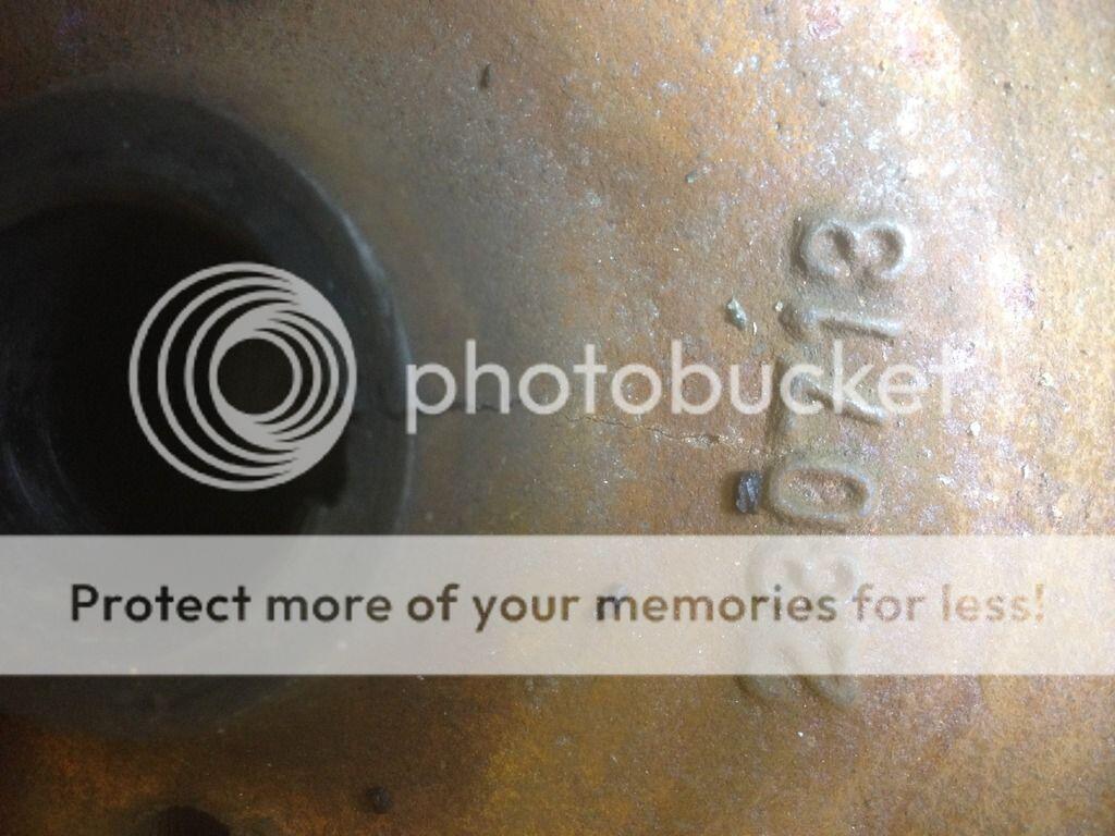

HeadExam 1,783 #45 Posted May 26, 2015 Well in theory one might think so, but that is DEFINITELY not the case. For example, Kohler made dozens of different models each of the k series 10, 12, and 14 hp engines, the 14 hp K321 alone had over 75 different crankshaft applications. To correctly replace any kohler engine you need to match up the SPEC number, that will tell you if it has the right crankshaft, carburetor, starter, oil pan, air breather, and weather it is alternator, generator or battery or magneto ignitions. if you do your homework it will save you from sorrow down the road, if you don't do your homework your shed will turn into the local spares store. BTW, I have a list of spec numbers, crankshaft cross references and such. On a final note, the spec numbers don't always have to match exactly, some overlap in application, some. Share this post Link to post Share on other sites
slf-uk 914 #46 Posted May 27, 2015 I've experienced the fun of Kohler spec numbers whilst ordering parts for the K582 in my Bolens HT23. I've just had another look at your pictures of the damaged parts and I think it would be possible to do a weld repair. For the flywheel I would suggest farming that out to someone experienced with welding cast because you really don't want it to fall apart with the engine running. You may have someone at work who would do it for the cost of a drink. The K161 I have on my bench (that we were looking at on Saturday) has the complete center of the flywheel broken off. The previous owner had glued it back in place and used the engine until the glue gave way, so a good weld repair should work well although it may be slightly out of balance. Before doing that it might be worth finding out if mechanically the engine is sound. We could pull the flywheel, mag, etc. from the K161 on one of my ride-a-matics's to try to get your engine running. Iain Share this post Link to post Share on other sites
Tom 215 #47 Posted May 28, 2015 Well in theory one might think so, but that is DEFINITELY not the case. For example, Kohler made dozens of different models each of the k series 10, 12, and 14 hp engines, the 14 hp K321 alone had over 75 different crankshaft applications. To correctly replace any kohler engine you need to match up the SPEC number, that will tell you if it has the right crankshaft, carburetor, starter, oil pan, air breather, and weather it is alternator, generator or battery or magneto ignitions. if you do your homework it will save you from sorrow down the road, if you don't do your homework your shed will turn into the local spares store. BTW, I have a list of spec numbers, crankshaft cross references and such. On a final note, the spec numbers don't always have to match exactly, some overlap in application, some. Hi HeadExam, I fully understand what you are saying and have noticed many small differences in the Kohlers I have owned. The spec number I have for this engine is: 23493E if that is any help to you.. The only problem I can see me having if I were to put a K141/K161/K181 would be fitting the drive pulley and recoil for the drive belt. I'm not too sure if the other Kohlers would have a hole for the dowel on the pulley.. Tom I've experienced the fun of Kohler spec numbers whilst ordering parts for the K582 in my Bolens HT23. I've just had another look at your pictures of the damaged parts and I think it would be possible to do a weld repair. For the flywheel I would suggest farming that out to someone experienced with welding cast because you really don't want it to fall apart with the engine running. You may have someone at work who would do it for the cost of a drink. The K161 I have on my bench (that we were looking at on Saturday) has the complete center of the flywheel broken off. The previous owner had glued it back in place and used the engine until the glue gave way, so a good weld repair should work well although it may be slightly out of balance. Before doing that it might be worth finding out if mechanically the engine is sound. We could pull the flywheel, mag, etc. from the K161 on one of my ride-a-matics's to try to get your engine running. Iain Hi Iain, It may be an idea, and one that I have thought of. The only thing I would be worried about is would it unbalance the flywheel? I know you wouldn't be adding much weight.. That's a very kind offer of you which I may take you up on as, like you say, I don't want to throw sums of money at it and find out there is something else wrong! We will have to have a chat at the weekend Tom Share this post Link to post Share on other sites

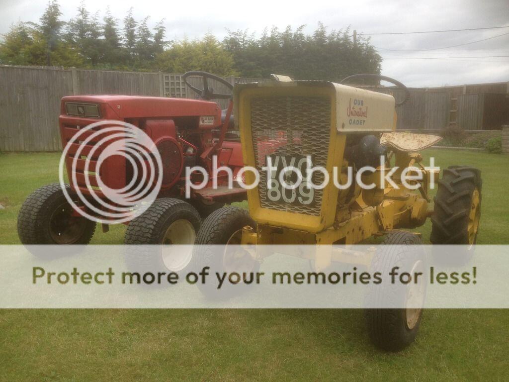

Tom 215 #50 Posted June 1, 2015 Hi all, Not done much on the Cub lately, unfortunately. However, I have picked up some new rear tyres and another K161 engine. Admittedly it is seized but it has been barn stored and looks fairly straight so I can use parts off of it all being well. Has anyone else put 23-8.50 x 12 tyres on a cub before? I mocked it up and I quite like it, not sure what to put on the front though... What do you guys think? Tom Share this post Link to post Share on other sites
