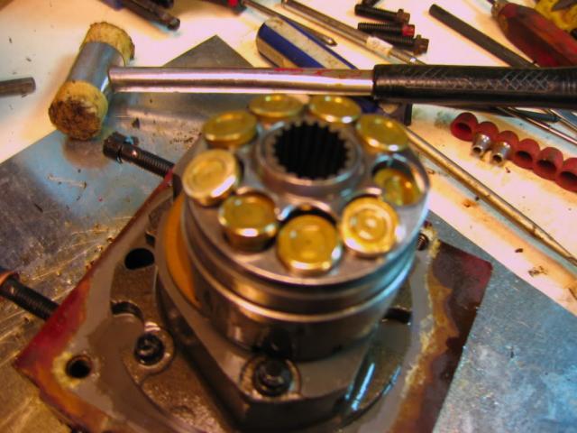

meadowfield 1,901 #22 Posted November 14, 2015 Wow, quite a conversation.... Th uni-drive patent refers to the combined 3 speed transmission and reverse. I've not heard of the autos being referred to as unidrive, but equally wouldn't be surprised if they all fell under the same name... Think Hoover! Personally I would go for an 8 speed, less prone to failure and easier to pull apart. You can rebuild one in a weekend with a few bearings and seals. A hydro can be a pita, and they take some knowledge and patience, a few of us have pulled them apart. Agree with Alain though a good hydro is great, however a weak hydro is not. They can leak, groan, lose power when warm... 2 HeadExam and the showman reacted to this Share this post Link to post Share on other sites
HeadExam 1,783 #23 Posted November 14, 2015 Paul Said, " a good hydro is great, however a weak hydro is not. They can leak, groan, lose power when warm..". The same can be said about a geared tractor in that if the clutch is weak, the gears stripped, or the bearings rotted, it takes rebuilding the whole drive line to get it in order. These tractors are for the most part close to half a century old and whether maintenance has been done or not, getting back to original takes time and money if the tractor is to survive. Again, I really don't see an issue of reliability or durability in geared over hydro, but as others have stated, it is a personal preference. I would really like to see a tractor with a synchronous transmission, like the newer shift on the fly mowers, but more of an automotive quality. Maybe some one could do a custom build hint, hint Nigel, etal 1 nigel reacted to this Share this post Link to post Share on other sites
Stormin 4,458 #24 Posted November 14, 2015 The main problem with the unidrive, probably the hydro as well, is the main ball bearing is now obsolete. Remember what I had to do. Share this post Link to post Share on other sites
HeadExam 1,783 #25 Posted November 14, 2015 The main problem with the unidrive, probably the hydro as well, is the main ball bearing is now obsolete. Remember what I had to do. I do not believe a geared tractor and hydro share any parts. My parts dealer assures me that finding parts for sundstrand/eaton hydros is not a problem, however not the same can be said about the older Vickers T66 hydros, which were not as common in GTs anyway, mostly in early Simp/AC, Ariens, and maybe Wards. The hydrostatic drive is very, very simple if you deal in fluid power much at all. A pulley turns the pump creating pressure with the use of 9 cylinders (sometimes less) that resemble a wheel gun or revolver, by pulling a lever fluid is moved to the gears in the trans axle that propel the machine forward, by pulling the handle the opposite way it reverses the direction of fluid and the machine. The main problem with hydros comes from dirty fluid and the scratching/wearing of the pressure plate. I know of only three geared transmissions in Cub GTs up until 1980,and those had many parts interchangeable with Cub tractors, but some geared tractors like Wheel Horse, Bolens, Simp/AC had many different geared transmission models and therefore parts tend to go NLA, especially those that offered two speed, hi/low, vari-drive, select-o-shift, or shuttle shift transmissions. Below is a picture of a Wheel horse D-200 hydro pump after the outside cover is removed. Of course the transmission/drive train of the Wheel Horse is closer to a Hydraulic drive CASE tractor than a true hydrostatic, but it does use the same pump as the hydrostatics and not a hydraulic pump like the CASE. Share this post Link to post Share on other sites
