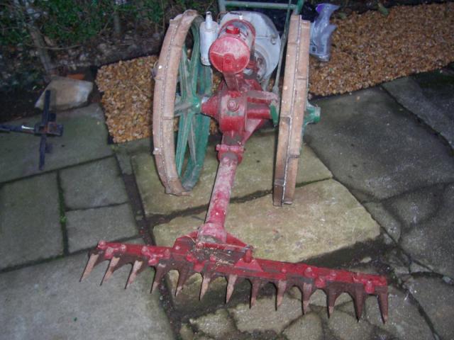

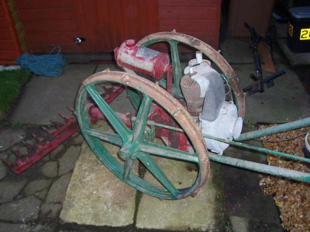

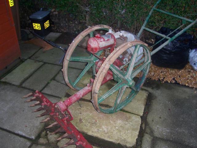

rolloman 123 #1 Posted December 13, 2015 Hi guys today the Fife plooman and me picked up some new exhibits for 2016 I think he has got his sprayer on here already well here is my new toy i like it hope you do I havent seen any up here like this before I know it is a mk1 allen mower but i havent seen those type of handles on them 7 Stormin, Triumph66, Wallfish and 4 others reacted to this Share this post Link to post Share on other sites
Stormin 4,458 #2 Posted December 14, 2015 I like the wheels. What age will it be? Share this post Link to post Share on other sites
meadowfield 1,901 #3 Posted December 14, 2015 Nice find, as Norm says... Nice wheels Share this post Link to post Share on other sites
the showman 4,074 #4 Posted December 14, 2015 Looks to be in good condition, what's your plan with it are you going to get it running and wipe it over with an oily rag or do a full restoration job ? Share this post Link to post Share on other sites
Chris 642 #5 Posted December 14, 2015 Ohh nice find. Yes its a MK 1 Allen Scythe arround 1934/5. Whats the serial number?? I would just clean it up Be careful of the wheels on hard surfaces etc Share this post Link to post Share on other sites
rolloman 123 #6 Posted December 17, 2015 Hi guys not sure what to do with the Allen as yet the engine is seized solid and the coil is dead will try to unseize but i think its going to need patience to do this Share this post Link to post Share on other sites
Chris 642 #7 Posted December 17, 2015 Take then engine off. Remove cowl & mag etc Put it into a bucket of diesel & forget for a month or 2 while you get on with another machine Share this post Link to post Share on other sites
