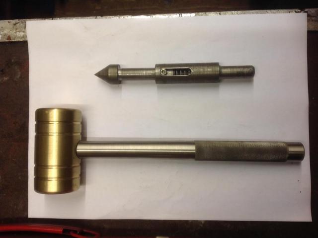

Yesterday's project the spring centre, used in the milling machine or drill press to apply pressure to a tap when threading a hole and also keeps the tap straight.
And this mornings work...a brass hammer with stainless tapered handle, the stainless was difficult to knurl and is shallow but still improves the grip. Almost too nice to use.
