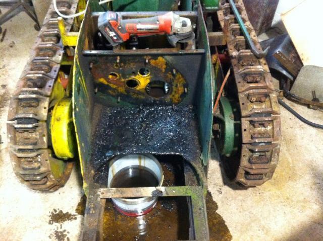

expeatfarmer 591 #8 Posted January 24, 2016 Struggled on today trying to split the gearbox on the skimmer. In the end I removed the original three speed box and the Ford box as one unit only to discover that the modified 3 speed box had most internals removed and a big shaft that went through both boxes with a large nut on the diff end hence the reason the box would not split. I thought I had a spare three speed but turns out I don't so having to remove the box from 311. The combination of sand and presumably sewage effluent has not done the nuts and bolts any favours so have resorted to cutting most of them off with a battery angle grinder ( wonderful tool Milwaukee ) Share this post Link to post Share on other sites

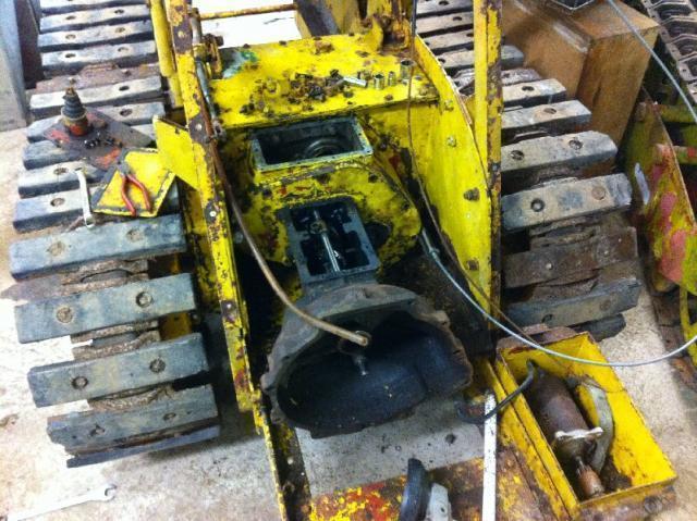

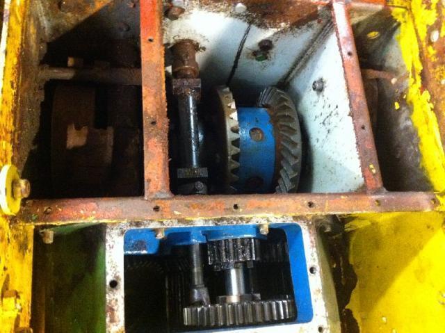

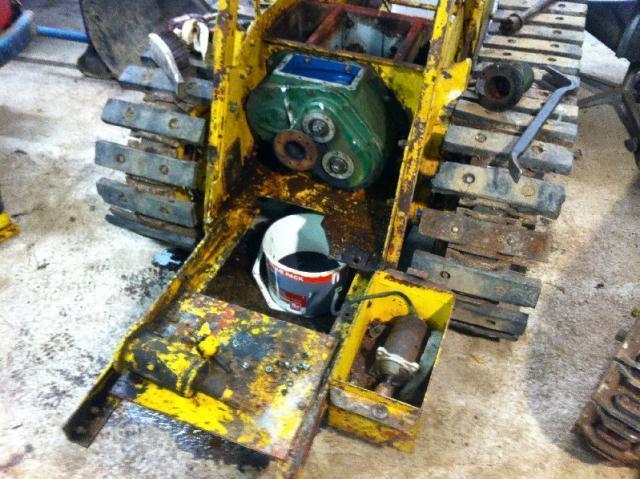

expeatfarmer 591 #14 Posted January 25, 2016 Which seal do you mean Rhys? Managed to swap the three speed gearbox over from 311 to 310 today discovered that the two bearings on the pto output shaft were shot hopefully Neil will have some spares. Gear change cable from 310 is snapped, cable from 311 has a 1/4" tail instead of 3/16" as 310. May be able to trim it down and cut a new thread to fit. Both gearbox sump plugs are seized solid so had to dismantle with oil in boxes hence the mess!! In the photo you can see the double final drives of the skimmers which reduce the travel speed to 25ft/min 1st gear, 50ft/min second gear and 1mph third gear. Could take me about an hour to get from the car park at malvern to the stand!!! Next job is to swap the petrol engine from the ITW to the skimmer and fit original Drayton back on the ITW. 2 diggerjames and hpearce reacted to this Share this post Link to post Share on other sites

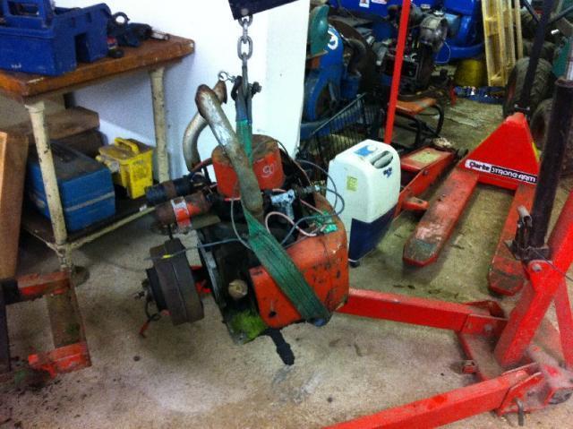

expeatfarmer 591 #24 Posted January 26, 2016 I wish ! Had a good day today though, gear change cable on 310 had snapped so took the one off 311 only to find gearbox end was 5/16 thread not 1/4,managed to grind it down and re thread it to fit so fingers crossed I can change gear. The flexible coupling on the petrol engine off the ITW was shot so stripped out the clutch to change the coupling, clutch is brand new as is drum. Then went on to strip the engine just to make sure all is ok, removed the head, bore and valves are absolutely perfect. Gave the valves a spin just to take off any surface rust. The chap who owned it before was an ex Massey Ferguson engineer and as such I expected it all to be good but needed to make sure looks to me as if it has only run for an hour or so since a complete rebuild albeit 25 years ago ! I have removed the mag again brand new inside, condenser is non original and not fixed well so will change that , points are new but furry so a clean up should be all that is needed. The engine is fitted with an Amal 356 carb. Again great condition but full of white powdery corrosion due to having been left dry for so long I will polish it up and should be fine. I am just hoping that the Drayton engine for the ITW is in the same condition as it came from the same guy, we will see in the morning! This machine will be displayed at Malvern come what may complete with 25 years of chicken poo in parts I have not reached yet, it will move under its own power but that is all there are loads of bits missing and aprt from the magic seat it will certainly not win a concours prize and neither will the ITW or the MG40N but these machines are rare and special and I would like as many people as possible to see them and hopefully others will feel inspired to bring along their machines in whatever condition they are. So inspiring that I have even got a Wheelhorse fanatic as number two ! 2 diggerjames and hpearce reacted to this Share this post Link to post Share on other sites
