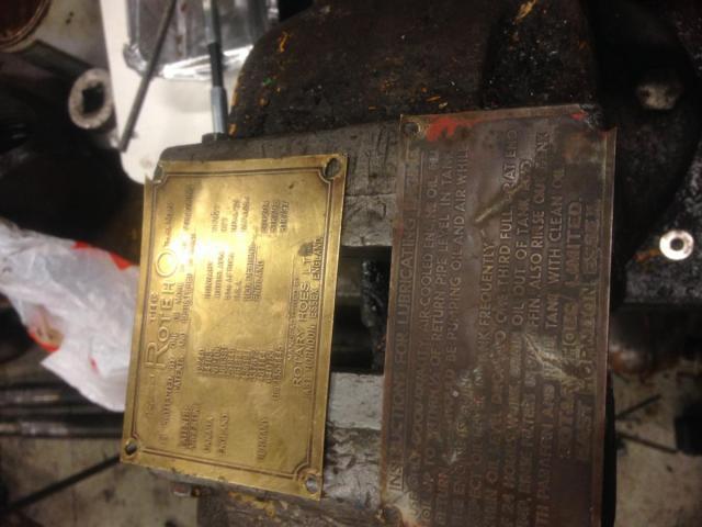

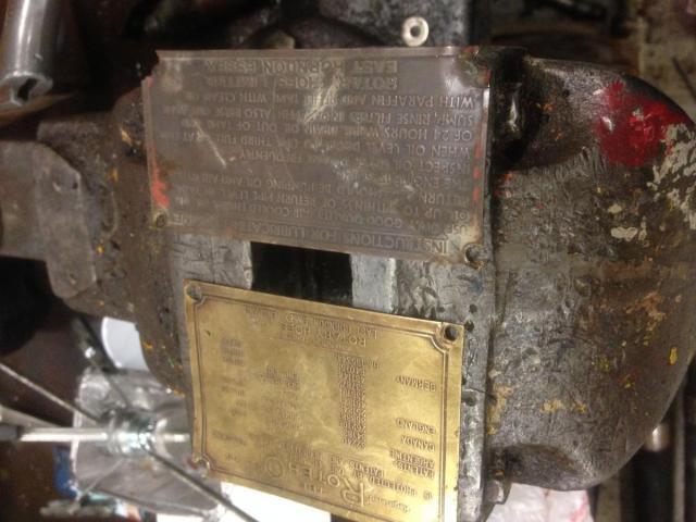

S1g 579 #26 Posted March 5, 2016 Don't know if these shots will come out the right way up, but heres the 2 brass plates that im having reproduced. Ive been digging through my notes on these early spec gems today, and have come to the conclusion that its probably the second oldest Gem left. G358 is the lowest that ive ever heard of. I own what is left of G367, but as its too far gone it will only ever be a doner so doesn't really count as its not a survivour. This one is G621 which is next. Then comes G667, after which ive seen 2 in the 900's (one is G927). I would love to hear of any more with a number below G951 (when the more common type handlebars were introduced.) Share this post Link to post Share on other sites

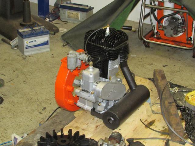

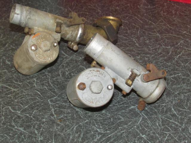

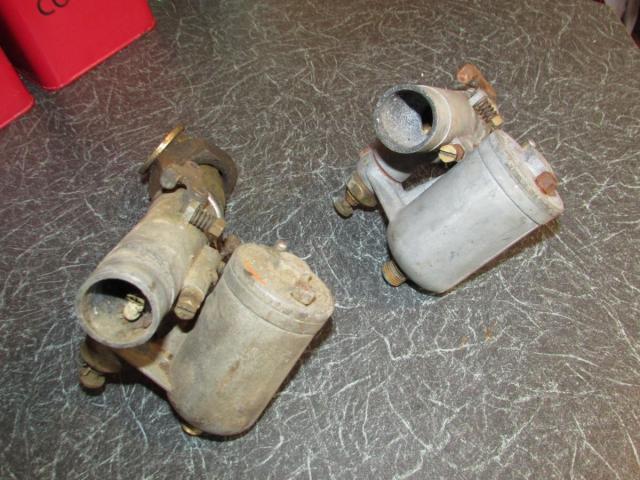

S1g 579 #28 Posted March 6, 2016 Modern technology. Hopefully these taken with my proper camera will come out the right way up.Dug these 2 Carbs out my shed today to make one good one out of them as the tattier one has a lot of wear on the butterfly spindle, and the one on this machine was missing. 1 nigel reacted to this Share this post Link to post Share on other sites

expeatfarmer 591 #30 Posted March 6, 2016 I repair worn butterfly spindles by drilling oversize and using a sleeve of silicone pipe over the spindle it gives a good seal and moves freely. 2 Stormin and S1g reacted to this Share this post Link to post Share on other sites
S1g 579 #31 Posted March 6, 2016 I repair worn butterfly spindles by drilling oversize and using a sleeve of silicone pipe over the spindle it gives a good seal and moves freely. Thanks for the suggestion, in the past I've had a mate drill the hole over size and fit a brass bush. However I like the idea of a silicone pipe, should be a lot easier to do. Share this post Link to post Share on other sites

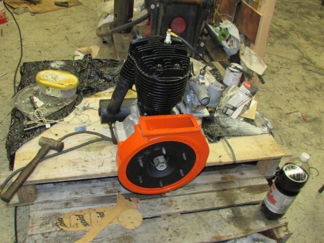

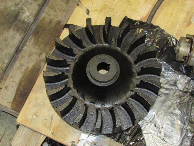

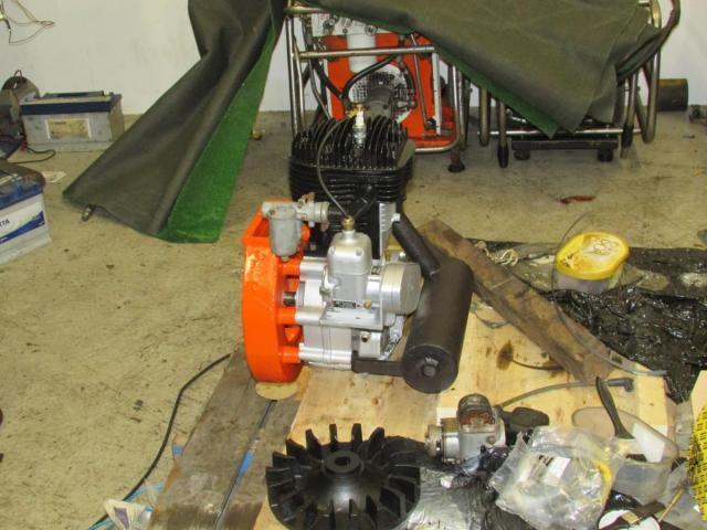

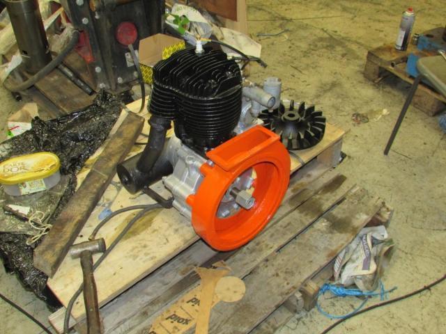

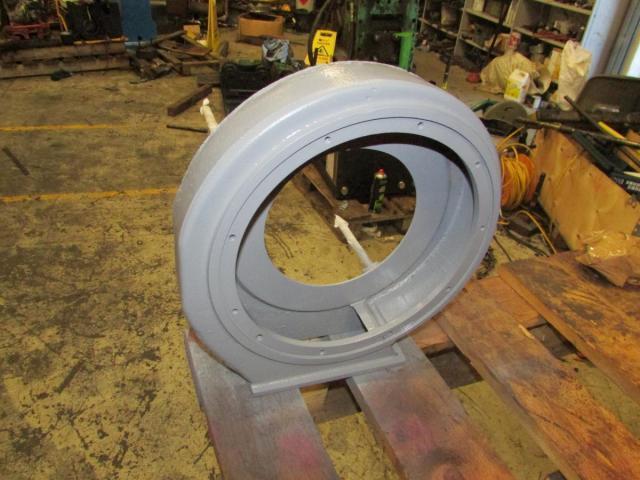

S1g 579 #32 Posted March 7, 2016 Todays job was to clean up the flywheel and fan shroud. Ive noticed in the past that war time Gems often had poor qualityfan shroud castings, probably due to shortages of good quality materials. As i'm aiming for a factory finish, I resisted the temptation to fill in the flaws. 1 nigel reacted to this Share this post Link to post Share on other sites

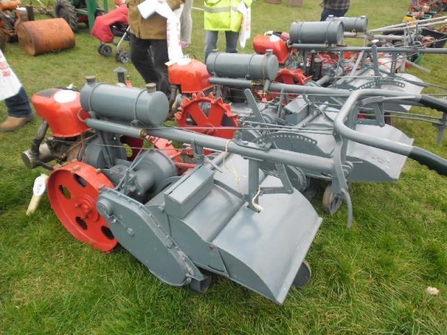

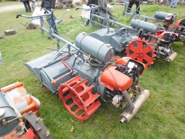

S1g 579 #35 Posted March 7, 2016 Gareth did they do a v twin rotorvaterYes, prior to the gem there was a v twin, I sure there was a jap and a British junior version. Attached is a photo of one in the 2013 tractor world auction were sadly I was the under bidder- but the I did purchase the 5 and 6 in the background.The really gutting thing was this twin had the engined removed for a motorbike and the remains sold on ebay later in the year. 1 nigel reacted to this Share this post Link to post Share on other sites
nigel 1,881 #36 Posted March 7, 2016 Cori like that is there still any around or have they all gone now, and why is it not orange and what age would it be 1 S1g reacted to this Share this post Link to post Share on other sites
S1g 579 #37 Posted March 7, 2016 Cori like that is there still any around or have they all gone now, and why is it not orange and what age would it be I know to a couple of examples but not many. The age is probably mid to late 30's. The colour of early Howard's is a bit of a controversy. The chap who restored these had been in contact with me for a few years prior to the auction trying to sell them( they cost x amount of thousands to restore so therefore they were worth this price in his opion) and he said that he found grey as the base coat. I've heard from a couple of sources that grey was used and even green before howard settled on orange. The far end one is a howard junior 5 imported from Australia ( I've still got this example) and the 6 is from the uk but I have scince moved it on as I needed the space and the money. 1 nigel reacted to this Share this post Link to post Share on other sites
nigel 1,881 #38 Posted March 7, 2016 Thanks for the info Gareth very interesting I would like to know where that engine is now, it looks the dogs dodars 1 S1g reacted to this Share this post Link to post Share on other sites

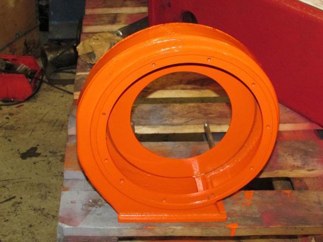

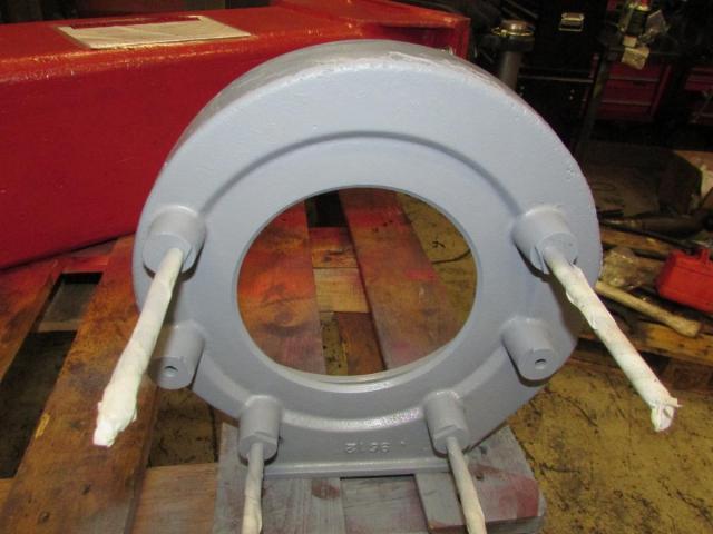

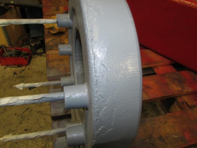

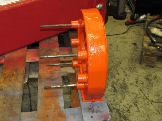

S1g 579 #39 Posted March 8, 2016 Ever had one of those mornings when you wish you hadn't bothered? Even though I'm suffering from exhaustion I got to work at first light after checking the forecast to top coat the fan shroud. Guess what?, the forecast lied. I was just putting the final coat on when it started to pee down, then in my rush to get it back inside quick it fell off the forklift. Using every trick I know I think I've managed to salvage it. Photos to follow tonight as otherwise if I upload now with the iPad Nigel will have to do another hand stand, lol. 1 nigel reacted to this Share this post Link to post Share on other sites
S1g 579 #40 Posted March 8, 2016 Heres a few shots. I also repainted the spacer plate. 5 Triumph66, Stormin, expeatfarmer and 2 others reacted to this Share this post Link to post Share on other sites

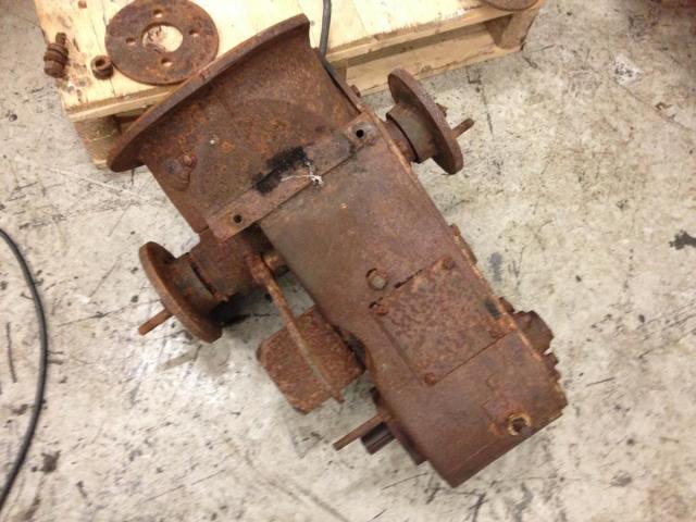

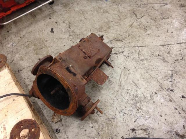

S1g 579 #41 Posted March 11, 2016 Next stage is to redrop the gearbox out of the frame. Share this post Link to post Share on other sites

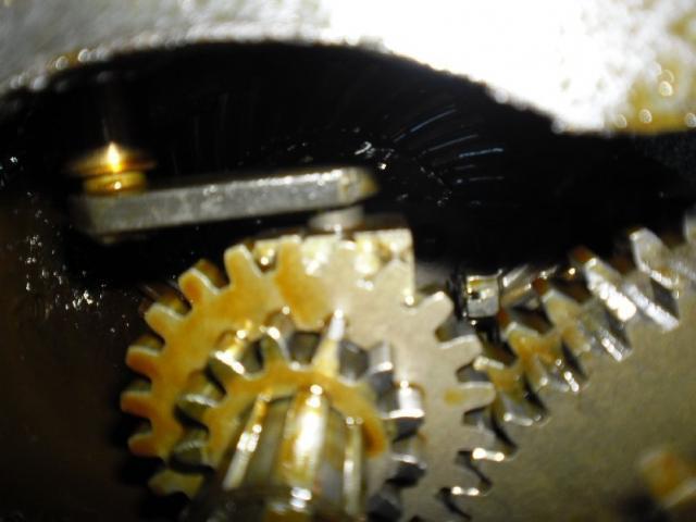

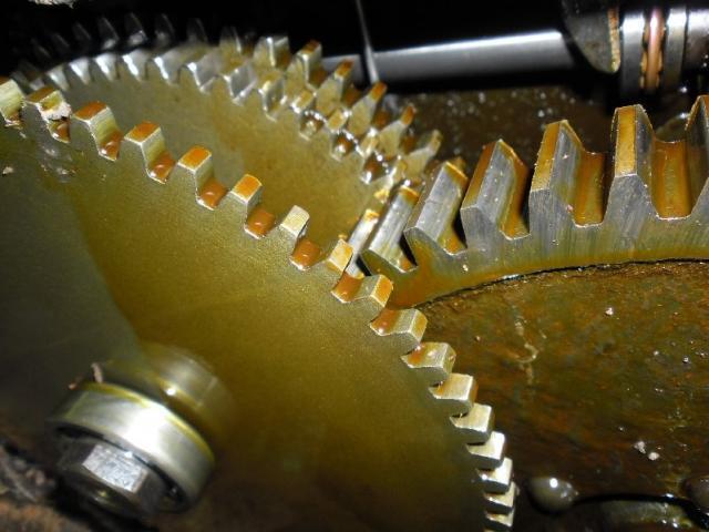

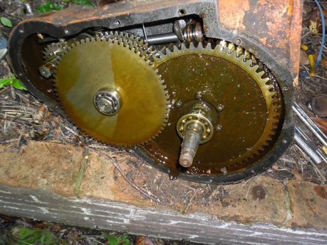

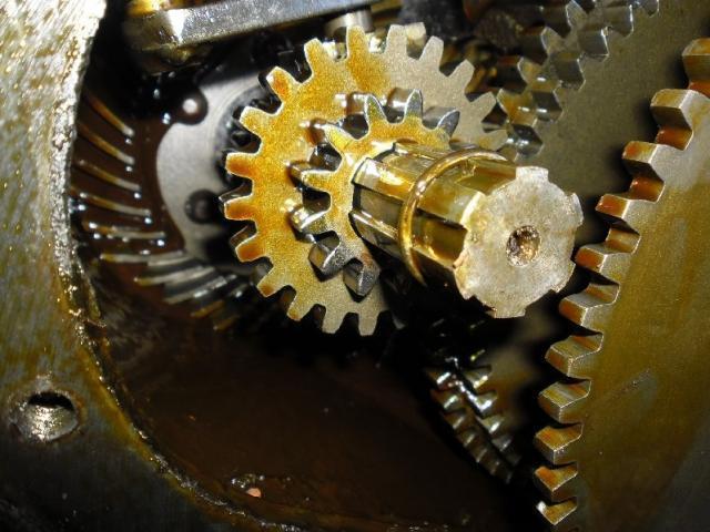

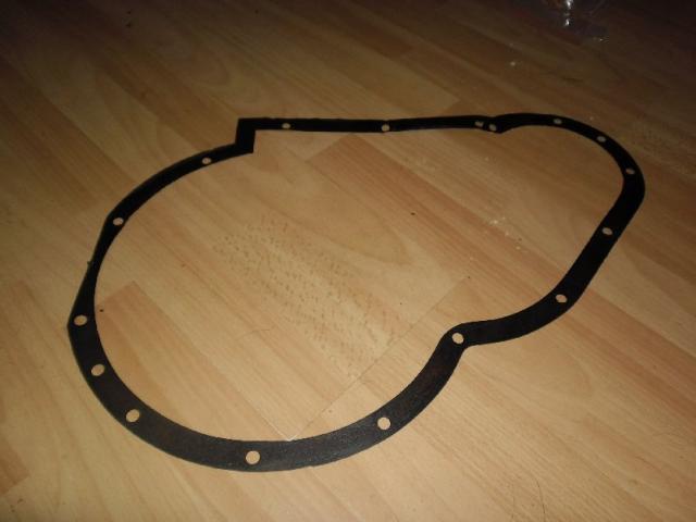

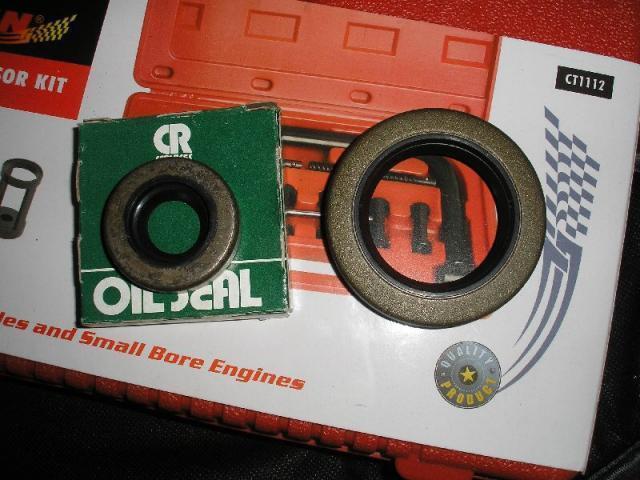

S1g 579 #42 Posted March 11, 2016 Here's some of when I stripped and checked the box when I was working on it a couple of years ago. New seals and a gasket was fitted as a precaution, apart from that it was in very good condition. 2 Stormin and nigel reacted to this Share this post Link to post Share on other sites

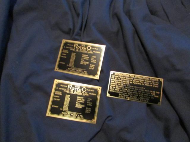

S1g 579 #43 Posted March 14, 2016 When I arrived home today, these brass plates were waiting for me. Am absolutely delighted with them. 3 Triumph66, Stormin and pmackellow reacted to this Share this post Link to post Share on other sites
pmackellow 2,738 #44 Posted March 14, 2016 Very nice, the finishing touch(es) !! 1 S1g reacted to this Share this post Link to post Share on other sites
nigel 1,881 #45 Posted March 14, 2016 very nice gareth can i ask the cost 1 S1g reacted to this Share this post Link to post Share on other sites
S1g 579 #46 Posted March 14, 2016 very nice gareth can i ask the costSingle plates usually come out at £45-£50 each. Chris did me the 3 for £120. Very nice, the finishing touch(es) !!As overall the spend on this machine is on track to be quite low( just an awful lot of time needed) I felt it was worth while spending a bit on taking it back to as close to new as I can get, the originals as can be seen earlier on in this project were badly damaged. The second roteho plate is for another project that I hope to reveal at some point in the next few months. 1 nigel reacted to this Share this post Link to post Share on other sites

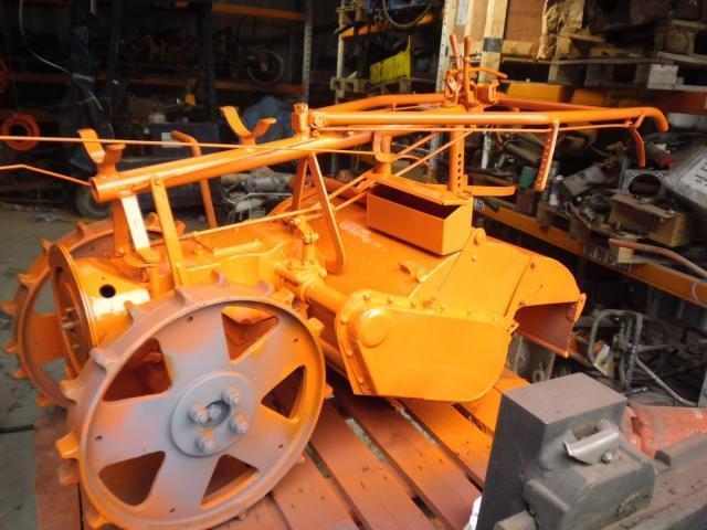

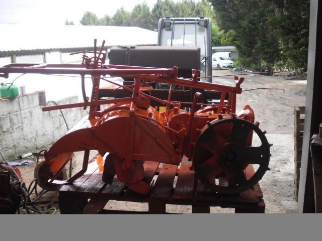

S1g 579 #47 Posted March 15, 2016 Here's a sneak peak at my 1946 series 1 gem that the other plate is for. It's hardly ever been used scince new, but was suffering the ravashes of time from living outside in a open ended shed that wasn't big enough to properly house it. 2 Stormin and nigel reacted to this Share this post Link to post Share on other sites

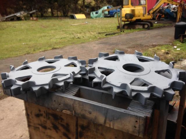

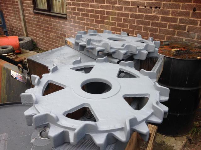

S1g 579 #48 Posted March 15, 2016 Tonight I painted the wheels in etch primer. As tempting as it was to fill in all the flaws in the castings, I again left it as factory finish. 2 nigel and Stormin reacted to this Share this post Link to post Share on other sites

S1g 579 #50 Posted July 29, 2016 Whilst im waiting for a puller to arrive to set the timming on my other gem and with a view that the blaster may get round to doing the top frame sometime soon ( its only a week after he said it would definatley be ready at the moment) I wire brushed and etch primed the gearbox. 1 Stormin reacted to this Share this post Link to post Share on other sites
