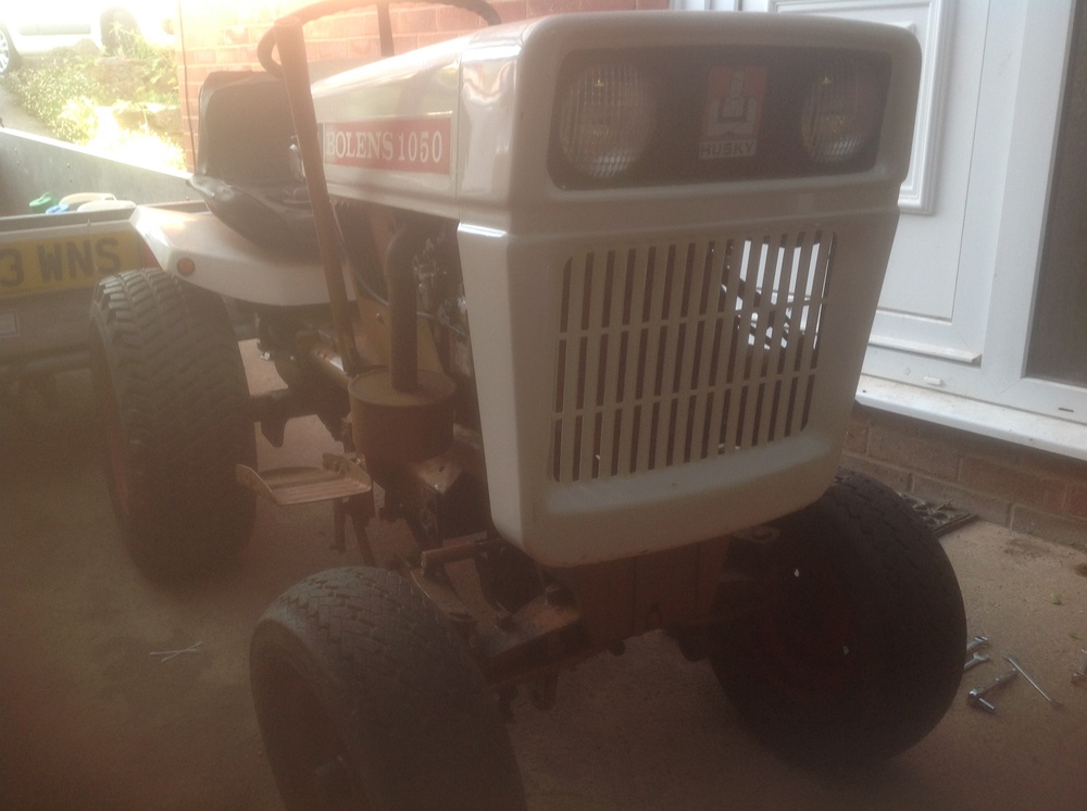

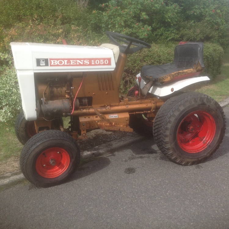

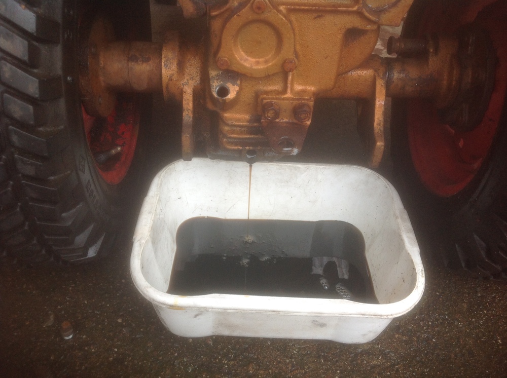

Triumph66 1,256 #26 Posted September 10, 2016 I collected the 1050 from the lock up this morning and bought it back to my house where I gave it a a quick wash to get rid of the grime. I drained the transmission oil and it wasn't as bad as I thought. After a an hour, I used my air line to blow out any excess oil into the container. It was replaced with new oil. I think the previous owner, a mechanic, serviced it from time to time. I emptied the fuel tank of cider vinegar and was impressed with how clean the inside of the tank was. I rinsed it out with cold water and then added carbonate of soda to neutralise the acids. I also rinsed the tank with petrol for good measure. The tank was installed with a new fuel line. I poured in fresh petrol and cleaned the spark plug and ensure everything was in place, I turned the key. Unfortunately, the battery was weak even though the engine turned over slowly. I am now charging the battery over night and hopefully I can fire up the engine to warm her up in order to drain the engine oil. 3 minky, wurzel and slf-uk reacted to this Share this post Link to post Share on other sites

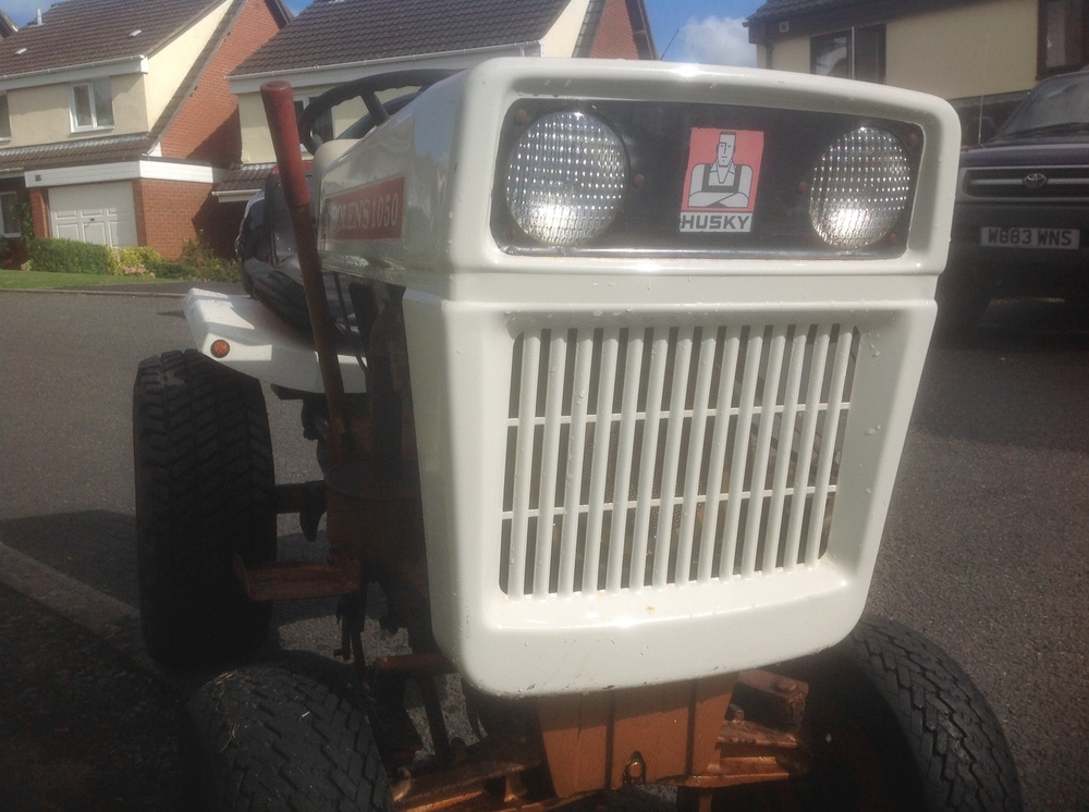

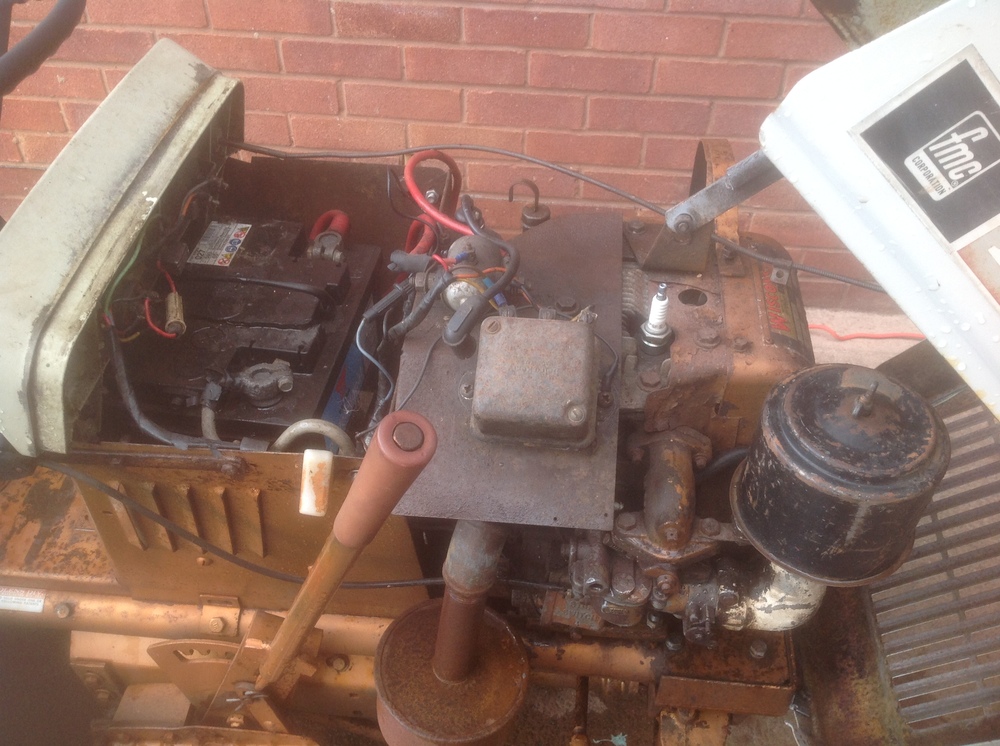

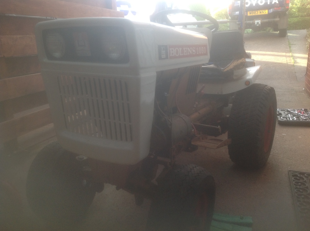

Triumph66 1,256 #30 Posted September 11, 2016 I charged up the battery yesterday evening and then rigged it up to the 1050 this morning. She started first time but was quickly enveloped in blue smoke! The pepper pot exhaust is well loud and it was exaggerated by the proximity of the surrounding houses. I think that will have to come off and a stack exhaust installed at some point.. It was difficult to run it smoothly as there's no choke cable connected so it kept spluttering and stalling. However it was enough to tell me it's alive with vigour. I let it ran for several minutes before draining the oil. It was thick black oil with some sludge in the bottom. Leaving it for several hours to drain, I greased up where necessary. On filling her up with fresh oil, I fired her up again and I am pleased that there is a lot less smoke but it still obvious. Chris thinks it sounds like piston rings so maybe that something else that will need doing at some point. I did engage gears and it moved under it own power very slowly but there was a lot of screeching which I thought was my wife but wasn't. I think a set of belts are on the cards too plus a new red seat cover. There is some surface rust here and there but I can live with that. Some more photos with a better backdrop this time. 1 Stormin reacted to this Share this post Link to post Share on other sites
HeadExam 1,783 #31 Posted September 11, 2016 Andrew, If you believe that the rings have worn, do yourself a huge favor and do not fool yourself into thinking that the cylinder and ESPECIALLY the connecting rod has not worn as well. Often with a fresh set of rings the newly added compression can snap a connecting rod and end up doing extensive and possibly permanent damage to the engine. I know many people have replace the rings alone with claimed success, however I would be very leery of not doing a complete rebuild if the cylinder wall and crank diameter are not within specified clearances. In addition to the above concerns, do not overlook valve guide wear, as this is where much oil can get into the combustion chamber and cause the smoke you have described. 1 Triumph66 reacted to this Share this post Link to post Share on other sites

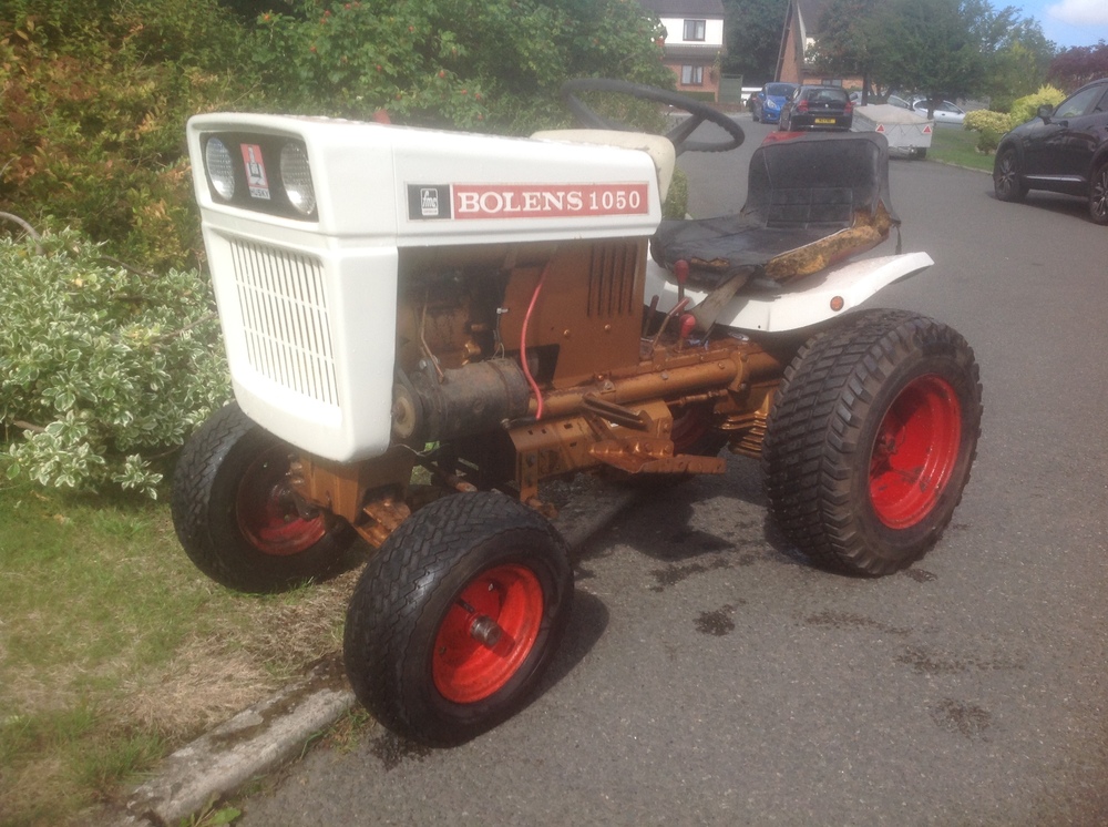

Triumph66 1,256 #34 Posted August 18, 2018 Update. Back in 2017 I replaced the seat cover with a red cover. I tried to fir it up but to no avail. I put in a new battery and though it turned over it just did not fired up. In 2018 I took it to my mate Chris who swapped the engine over with another Wisconsin. He swapped the carbs over and a few ignition components plus replaced the exhaust with another pepper pot one. It turned over but would just not fire but hampered by time and lack of space I collected it back off Chris and displayed it at Tractor Fest today. The smell of stale petrol was noticeable and the chap who was running the Howard's parts store suggested that I drain the stale fuel. With his help the fuel was drained (golden yellow) and with the help from Scott who is a member of MOM and a Bolens 850 owner, replaced the plug and reset the gap. I refilled the fuel tank with fresh petrol with added Redex. It spluttered and farted but came alive with clouds of smoke which eventually cleared. The long and short of it is that it fired up and runs very well and all the gears moves smoothly. A few tweaks such as inserting a new choke and throttle cables for example. Up to date photos will follow shortly. 2 Alan and HeadExam reacted to this Share this post Link to post Share on other sites

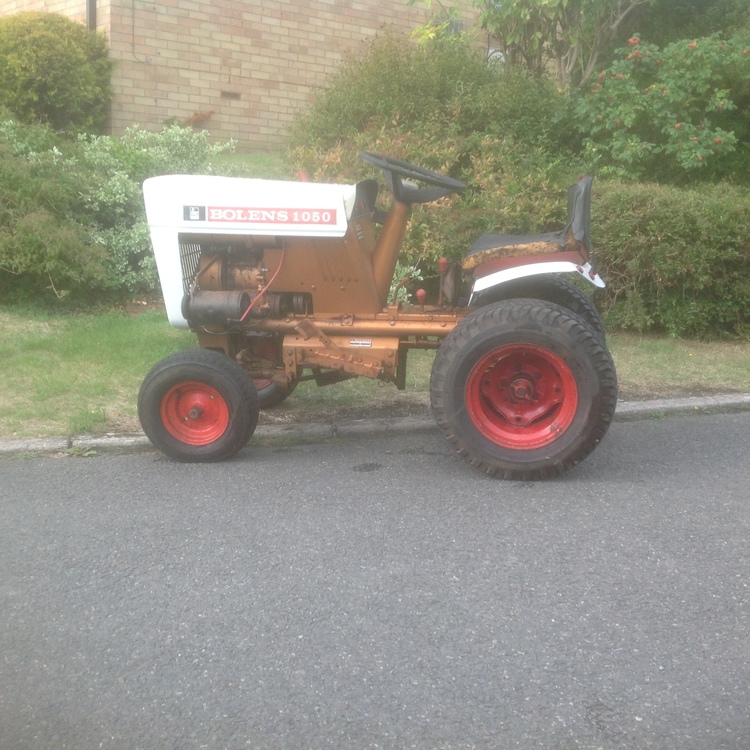

Triumph66 1,256 #38 Posted August 21, 2018 A few more photos back at the yard after I unloaded the old girl back from Biddenden. I also attach a video too. Share this post Link to post Share on other sites
