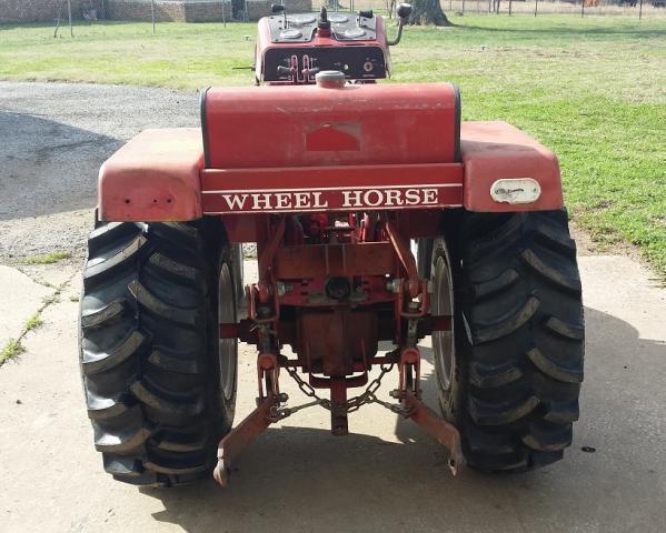

HeadExam 1,783 #1 Posted March 17, 2016 Going with the electric clutch rather than the manual clutch on this D-160 for the rear PTO and will put the manual clutch with the double pulley on the other D that will run a mower if I get another rear PTO. 6 meadowfield, Triumph66, nigel and 3 others reacted to this Share this post Link to post Share on other sites
C-101plowerpower 548 #2 Posted March 17, 2016 looks good! but, aren't those rears a bit narrow for those rims? looks like they bulge out a bit 1 HeadExam reacted to this Share this post Link to post Share on other sites
HeadExam 1,783 #3 Posted March 17, 2016 looks good! but, aren't those rears a bit narrow for those rims? looks like they bulge out a bit They do bulge a tad. As you might, or might not know there are two D series rim sizes, 12" and 15", I have both, but it is almost impossible to find an AG tire in 15 inch. There are two choices 6.7-15 inch wide (which is actually a implement or pedestrian tractor tire), which would also bulge on a 7 inch wide 15" Wheel Horse rim, REALLY look stupid, The next 15 inch tire available is the 30x12-15 Carlisle Tru Powers which wont fit, because the tires would be too tall. The 30" tires I have are on the wide 10" rims and because of the wide rim they only measure 29" tall, the wide rim pulls them down, just like a pinching in on narrower rim would push them up. If I had opted for the 30x12-15 Tru-Powers on the 7-15 wheel Horse rims it would have pushed them up over 31", wouldn't fit. I really had no choice unless I wanted to lift the rear fenders and have it jacked up in back like a Serbian Yugo. I could have kept the same size all around, but the tires on most GTs were designed for mowing, wide/short tires all the way around, I wanted these tractors to have some ground clearance. To give you a good example of what I mean, other than setting to plow next to George and his Gutbrod look at the last picture in my post of my other D-160 with the the 27x9-15 Maxxis Ceros tires, they measure out at almost 28" tall because they are 9 inch wide tires on a stock wheel horse 7 inch wide rims that pushed the tire upward almost an inch. Now glance at the middle of the tractor to the angle adjustment on the snow plow, see how low it is to the ground even with 27x9-15 rears and 4-10 fronts, it is 1-1/2" inches closer to the ground with stock tires. Interco offers a 27x7.5-12 and -14 tire just like this one, but I would have to find a 6 hole narrower rim. Can you start to see my dilemma? 2 Triumph66 and nigel reacted to this Share this post Link to post Share on other sites

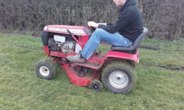

dubscum 38 #4 Posted March 19, 2016 I have 15x9 rears with turf tyres. I long for AG tyres. Even coincided pupping 15.3 x 9 with a inner tube and hope for the best 1 HeadExam reacted to this Share this post Link to post Share on other sites
HeadExam 1,783 #5 Posted March 19, 2016 I have 15x9 rears with turf tyres. I long for AG tyres. Even coincided pupping 15.3 x 9 with a inner tube and hope for the best The Maxxis Ceros 27x9-15 is a great AG alternative, that works on turf as well, its the tires on my second D-160, the last picture. 1 dubscum reacted to this Share this post Link to post Share on other sites

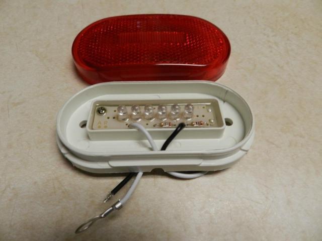

HeadExam 1,783 #9 Posted March 20, 2016 I bought 4 of these rear lights for my D's, they look almost like the OEM lights, but are 6 LED models, 5.39 each and free shipping. 2 Triumph66 and Joe the small engine man reacted to this Share this post Link to post Share on other sites

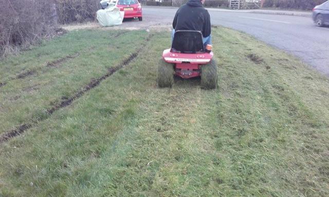

4x4forks 258 #12 Posted March 20, 2016 I have used The LED lights and attached them over the original reflectors whch are much larger. Looks great and works well in the dark 2 nigel and HeadExam reacted to this Share this post Link to post Share on other sites
HeadExam 1,783 #13 Posted March 20, 2016 I have used The LED lights and attached them over the original reflectors whch are much larger. Looks great and works well in the dark What are the ruts in the yard for? Looks like the grass was a tad high, I think the grass gauge was at bale, not mow, lol. Looks like the WH is doing fine. 1 4x4forks reacted to this Share this post Link to post Share on other sites
