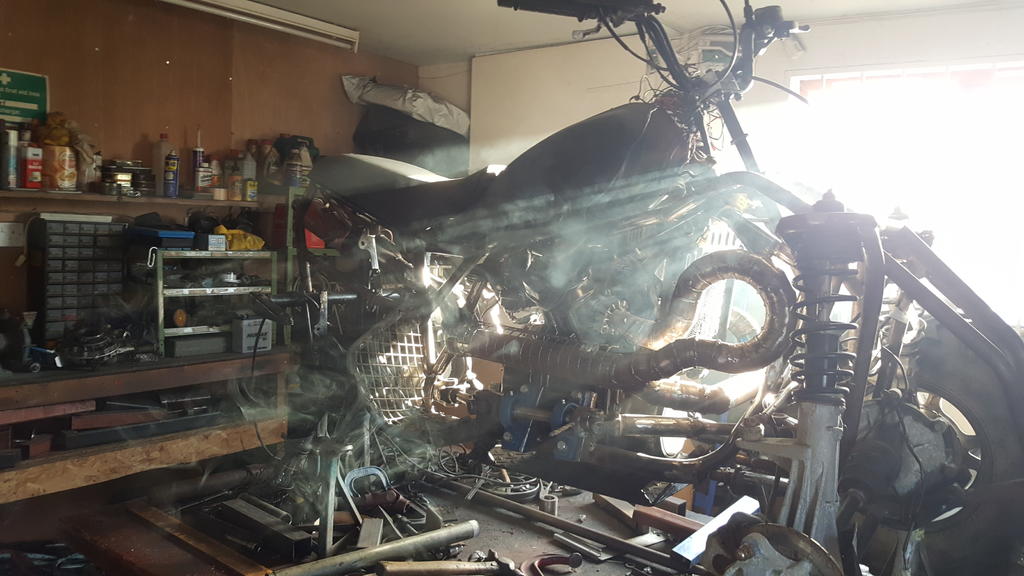

Ian 2,417 #116 Posted December 13, 2017 Owdo all, time for an exhausting update Having short stubby pipes sticking out the engine I needed to make them a bit longer and join together. The first bend, Im going for a more agricultrual look with the exhaust system to make it stand out a bit from the swoops of the frame, so lots of pie cuts going on. Plenty of penetration which is good to see The N/S pipe almost done. The long bit that goes across the frame was welded in place first the couple of bits of box were there just to keep it in the right place, below the radiator.. The rest was made up to fill the gap. Before doing the O/S pipe I needed to know how it was all going to fit into the main pipe which runs along the side of the engine.. Sooooo, how to fit two of the smaller pipe into the bigger one!! Some measuring and cutting later.. The pipes are over length as I knew I'd need to trim them just not quite sure where yet. Welded up and slotted in place. And joined to the N/S pipe.. Before you ask.. Yes the welding rubbish was cleaned from the inside of the pipe sticking out the engine before anything else was welded to it.. Share this post Link to post Share on other sites
Ian 2,417 #117 Posted December 13, 2017 These CX/GL 500 Honda engines only run at their best if both cylinder/header pipes are the same length each side... The N/S pipe came in at 30 1/2 inches, so I had to try and fit that length into a rather small space on the O/S and still have good gas flow!! A long bit of pipe with lots of pie cuts marked out.. Can you see where I'm going with this? A shorter bit of pipe.. Lot's of hollow metal pies.. And lots of blue power coating on my bench from cleaning the pies.. This bit of cardboard was used to work out some angles to cut, the metal version will fit about here. So I didn't end up welding up a bit hollow Polo mint I added a bit more cardboard to the mix. As long as the loop follows the spiral it should not end up hitting it's self But.... Your going to have to wait to see how the exhaust comes out as I'm off out to lunch Share this post Link to post Share on other sites
Ian 2,417 #118 Posted December 13, 2017 A bit of lunch and lot's of welding later the result is some what curvy Some bit's could not be welded in situ so to make sure nothing could move during welding I added a couple of braces before taking the exhaust off. Fully welded up, just a lot of welds to grind down.. Funky shape eh? With the exhaust bolted back on.. I could start on the next part of the puzzle, the rear exhaust section.. It's going to be interesting trying to join these cans.. To the bit of big bore pipe you can see below the tank in the triangular bit of frame.. As someone has put a transfer box right in the way and there isn't really enough space between the TB linkage arms and the frame.. Yep, it's going to be interesting for sure 3 1 nigel, Alan, Cub Cadet and 1 other reacted to this Share this post Link to post Share on other sites
