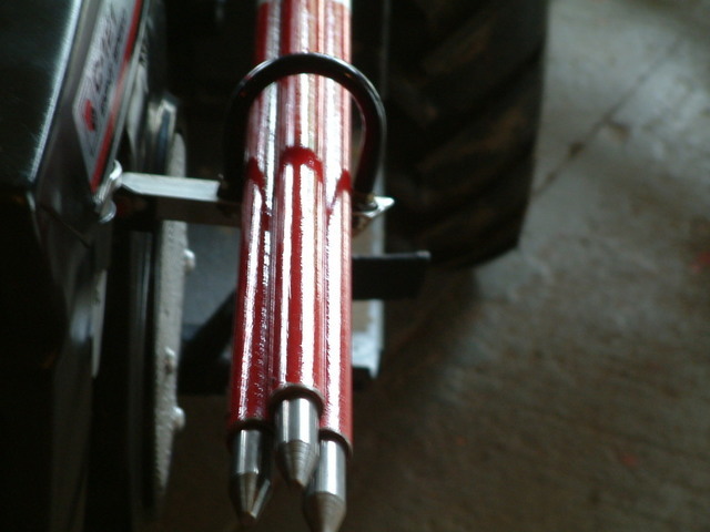

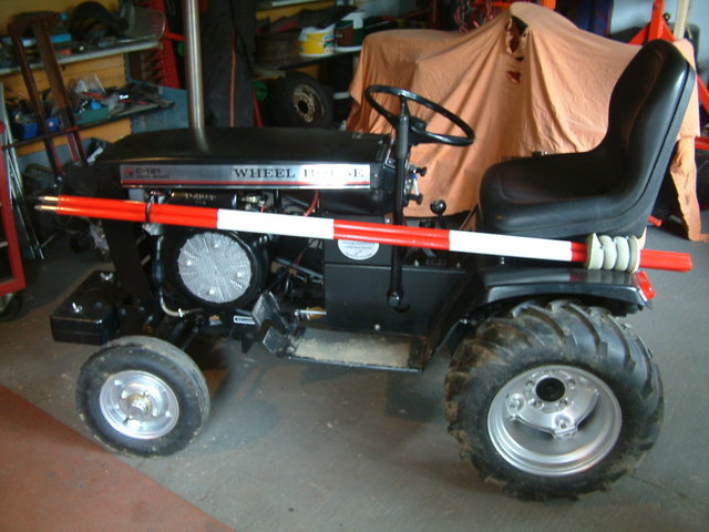

Stormin 4,458 #1 Posted June 19, 2016 The Showman kindly made up three ploughing sighting poles for me, which he brought up to Newby. I've been thinking of how to transport them when at a match. Today I set too to see what I could come up with. Some aluminium 1" angle, U bolt, plastic pipe and a couple of pieces of cushion foam and two hours later the result. Yesterday I made up some points for them. Held in place with split dowels. Didn't want to damage Chris's paint work. The poles rest on a rubber strip and another piece of foam goes 'tween poles and U bolt, to stop them rattling about. BTW. I can still operate the clutch. . 6 nigel, Alan, the showman and 3 others reacted to this Share this post Link to post Share on other sites
pmackellow 2,738 #2 Posted June 19, 2016 Proper job Norm that looks really good mate Share this post Link to post Share on other sites
the showman 4,074 #3 Posted June 19, 2016 That looks good Norm, ive got a mate to carry mine . Share this post Link to post Share on other sites
neil 524 #4 Posted June 21, 2016 Your gonna have to change your name now to the Black Night. Norm . 1 Stormin reacted to this Share this post Link to post Share on other sites
Ian 2,417 #5 Posted June 22, 2016 A neat solution to carrying the poles Norm, now you just need to work out how to "fire" them out and stick in the ground where you want Share this post Link to post Share on other sites
Stormin 4,458 #6 Posted June 22, 2016 I did think of using a drain pipe with a button at the back. With a label saying, "Press to Fire". Share this post Link to post Share on other sites
