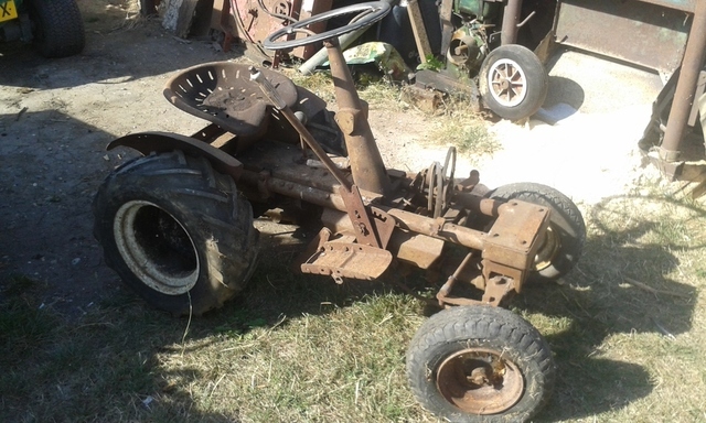

Chris 642 #10 Posted September 3, 2016 Its a project alright . Its been in parts for along time. Its looks to me its got WH rear wheels. The correct ones came with it though 3 Stormin, Triumph66 and slf-uk reacted to this Share this post Link to post Share on other sites
Stormin 4,458 #11 Posted September 3, 2016 I think Alain over in the states, said somewhere that several manufacturers of GT's used the same wheels. I like the style of the steering column. 2 Triumph66 and slf-uk reacted to this Share this post Link to post Share on other sites
Triumph66 1,256 #12 Posted September 3, 2016 2 hours ago, slf-uk said: A very worthwhile project, looking forward to the pictures. Something to keep you busy in the cold winter evenings? Iain The 600 will be in the queue as I would like to get the 1050 up and running and then the H16. Plenty to keep me out of mischief! 9 minutes ago, Chris said: Its a project alright . Its been in parts for along time. Its looks to me its got WH rear wheels. The correct ones came with it though Thanks Chris for collecting it and good to see better photos on the Ipad. Doesn't look too bad; I seen worse. Share this post Link to post Share on other sites
slf-uk 914 #13 Posted September 3, 2016 1 hour ago, Stormin said: I like the style of the steering column. This is a great picture because it shows what a Bolens looks like with the panels removed. The design started with the 600 in 1962 and very little changed right through to 1978 with the last G14. The chassis tubes were shorter on the 600 and they had a dog leg on the hydros. The steering column is a work of art although the top bush can be a pain. The cast front axle and cradle are unbelievably heavy. The body panels changed over the years and various gearbox, clutch and engine options were available. Everything is widely over engineered which is why I love them so much. Just as well it is really considering the weight of some of the attachments. This big boy for example weighs in at 550lbs (250kg). Have I got one - no, do I want one - you bet! Iain 2 Triumph66 and Stormin reacted to this Share this post Link to post Share on other sites
