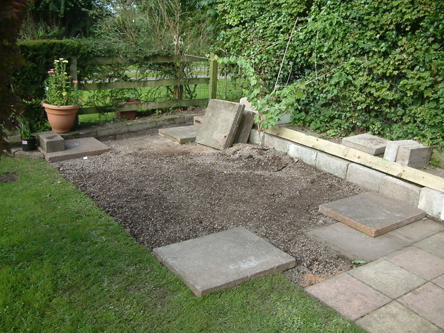

Stormin 4,458 #1 Posted August 29, 2016 Carol has an artistic streak and wants a new studio. So the greenhouse had to go. Over the last few days, I've dismantled the greenhouse and transported it to eldest daughters. Son-in-law wanted it and was a great help. Conspicuous by his absence. The breeze block base the greenhouse was fastened too, also removed. Hollow blocks are quite heavy, especially when someone has filled the hollows with concrete. These have been taken elsewhere with the C-81 and Saxon trailer. Site levelled up and some 2-1/2 x 24 x 30 inch slabs that have been hiding behind the workshop, placed and levelled at the four corners. More slabs have to be laid yet for the floor supports and that's the next step. The new studio is to be 8ft x 12ft and construction of the will start sometime later in the week. . 6 the showman, ranger, HeadExam and 3 others reacted to this Share this post Link to post Share on other sites

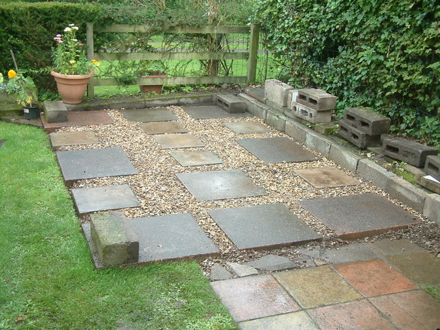

Stormin 4,458 #8 Posted September 5, 2016 Bit of progress on the studio. Base finished. 3 Alan, the showman and slf-uk reacted to this Share this post Link to post Share on other sites

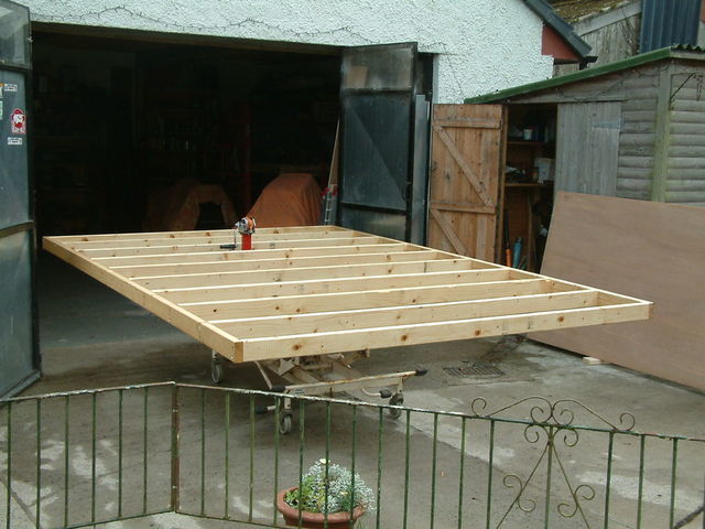

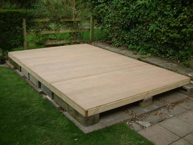

Stormin 4,458 #13 Posted September 7, 2016 More progress today. Floor frame treated with two coats of preservative over the last couple of days. Put in place today and levelled up. Underneath of the ply floor treated then laid and screwed down. Roof frame with it's first coat of preservative. A neighbour is doing the joinery work. He has all the gear. Frame work we carried round. Ply sheets came round by C-81 and Saxon. And the hospital bed/lift being useful once more. 3 Alan, Triumph66 and slf-uk reacted to this Share this post Link to post Share on other sites
