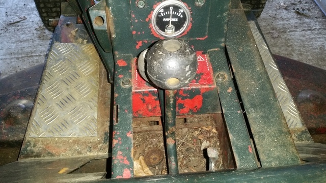

John keen 4 #1 Posted October 3, 2016 Hello, I'm new to this site so please be gentle with me. I've just brought my first wheel horse c101 but it has a 12hp engine in it. where can I get a manual for it as I want to restore it? Thanks John 1 HeadExam reacted to this Share this post Link to post Share on other sites
Anglo Traction 1,016 #2 Posted October 3, 2016 Hello John, Welcome. Wheel Horse started using C-101 on their 10hp Model from 1978 with a Model Number of 81-10k801. So depending on which year yours is, will depend on what Manuals you will need. Once you know your model number (on a small black Plate under left side of dash usually) and then the year, you can search for them on the WH sister site here- -Redsquare- Many of us here are also members on that Forum. As you have a different sized Engine fitted, you will need to note the Model, Spec and Serial number (if it is a Kohler) and search this site link- -Kohler- Any problems, come back with the details required above and we'll see if we can fit you up with what you need. If you have any pics you can post, we like pIcs. Regards 1 HeadExam reacted to this Share this post Link to post Share on other sites
HeadExam 1,783 #3 Posted October 3, 2016 Here is the owners manual for the Kohler 12hp K301 and the service manual for the K91 through K321 engines Kohler_K91_K141_K161_K181_K241_K301_K321_Serv_Man_0472.pdf kohler10hp12hp14hp16hpOwners.pdf Share this post Link to post Share on other sites
John keen 4 #4 Posted October 3, 2016 Thanks very much for that information and help. On the plate it only says, model number 1-036D. serial number 128598.... The thing I'm not sure about is where the two gear sticks are there is no H plate ? I will try and upload some pictures. Thanks again for your help. John 2 HeadExam and Stormin reacted to this Share this post Link to post Share on other sites
Anglo Traction 1,016 #5 Posted October 3, 2016 No problem with the info. There are lots of Members in the Home Counties. It is a 1973 10hp 8 speed as they are known in the U.S. (Also No Name Tractors). Model number will be 1-0360 (Belgium continued to call them Raiders). Here's the Link to Toro Parts Diagram for it -LINK- The serial number also points to 1973-ish and your Tractor was assembled at the European WH works in Belgium with parts shipped from the U.S. Your seat and Steering Wheel were made in Britain and also fitted at the Belgium factory. Around that time, they used 2 types of PTO Clutch Linkage and either 1 or 2 Pedals, as surplus parts were still being shipped from the U.S that were no longer fitted to U.S Models. Flat top Gear Knobs look post 1974. Earlier ones were Spherical. There wasn't an 'H' Gear Lever Plate fitted on many 'C' Series before late '73' in Europe. Look's in fairly good condition. Way better than I get . 1 HeadExam reacted to this Share this post Link to post Share on other sites
Stormin 4,458 #6 Posted October 3, 2016 John. Tidy looking tractor and I like the colour. Gears are quite simple. Short lever on the right is high and low. H right. L left. The left hand lever is for the 3 forward and reverse. Reverse back to and and to the left. 1st back and right. 2nd forward and right with 3rd forward and left. Engage gears when stationary, not on the move. Share this post Link to post Share on other sites
