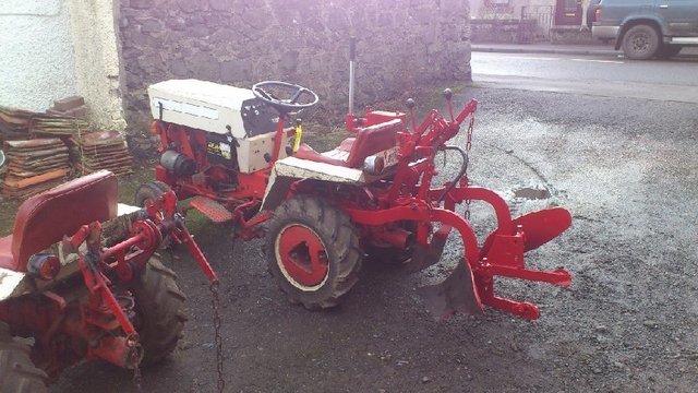

The Fife Plooman 632 #1 Posted October 10, 2016 Hi All What a difference a day makes. Local ploughing match very hard dry ground I could make nothing of it in fact made a mess with capital M The brain was put in gear fitted a bracket for a 56 lbs weight fitted a Scotch skimmer from the horse day,tried it on Sunday the-9th October different field different area different result although my finish let me down I still managed first place I was very happy with the changes that were made . little more tweaking and it will be fine As I was saying what a difference a day makes Hope you enjoy 6 Stormin, Triumph66, the showman and 3 others reacted to this Share this post Link to post Share on other sites

HeadExam 1,783 #4 Posted October 11, 2016 Yes, very nice plowing George, but if I may, can I ask a question about the workings of these ploughs? The Brinly and many other ploughs have a screw adjustment to change the landing of the plow, and while I see your tractor can go up and down on depth I don't see an adjustment for the suck. Am I missing something? Share this post Link to post Share on other sites
The Fife Plooman 632 #5 Posted October 11, 2016 Hi HeadExam Here are some points for you to look at, the winding handle below the steering wheel gives you control over entry into or out of the ground also notice the slotted heel piece ,this can be moved to maintain the suck required hope this helps Thanks for your comments George S 1 HeadExam reacted to this Share this post Link to post Share on other sites
HeadExam 1,783 #6 Posted October 11, 2016 That is a great place for the adjustment knob, never thought to look there Share this post Link to post Share on other sites
