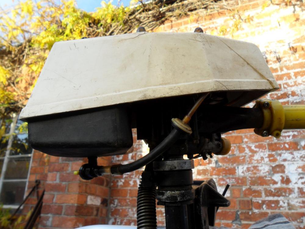

factory 487 #5 Posted March 23, 2017 Welcome to the forum, your Aquabug looks in nice condition, I have a pair of them rebranded by Perry in the UK, both the plastic covers are in poor condition. There are quite a few joins in the fuel line, the clear tubing can become brittle and crack, also one of mine has a hole in the plastic fuel tank. David Share this post Link to post Share on other sites

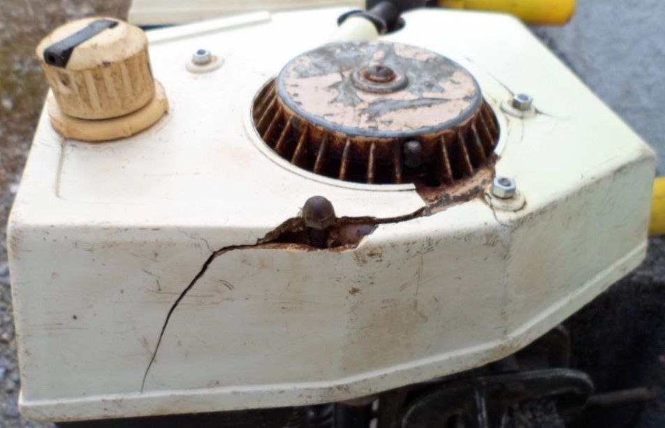

factory 487 #7 Posted March 24, 2017 Good advice on the plastic fuel tanks. This is the the other one I have, is the cover beyond repair? Here is a picture of the Perry Aquabug label on the better one of the two, I seem to have lost the "supplied by Perry's yacht centre" sticker (maybe it fell off before I got it). They were imported by R Perry & Company Limited of Monks Ferry Works, 90 Church Street in Birkenhead, I've looked it up on Streetview but it looks like they are long gone. David Share this post Link to post Share on other sites
Wallfish 718 #8 Posted March 25, 2017 You can probably repair it with fiberglass resin and cloth. Over here it is sold at Automotive parts stores. Share this post Link to post Share on other sites

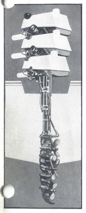

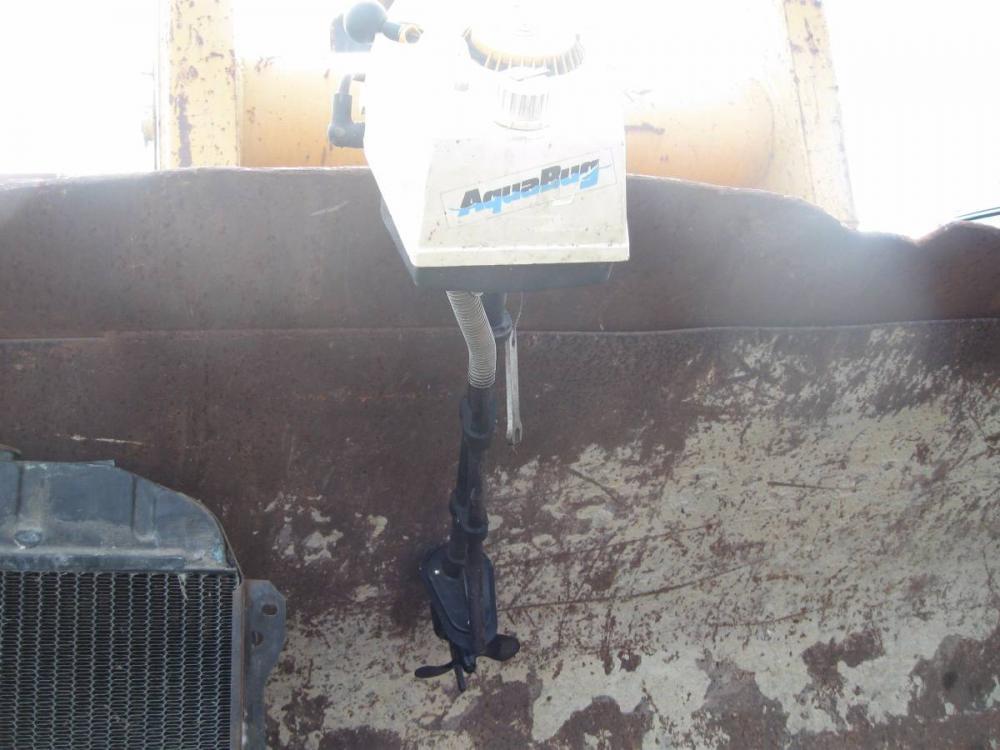

factory 487 #11 Posted April 1, 2017 Talking of surprises, I found this special triple engined Aquabug when doing some research this week, it's rated at 4HP, has anyone got one? David 1 nigel reacted to this Share this post Link to post Share on other sites
Webhead 95 #12 Posted April 2, 2017 I have a hard time believing that one! Do you have a link? 1 nigel reacted to this Share this post Link to post Share on other sites
Webhead 95 #13 Posted April 3, 2017 Ahhhh! I get it! April Fools! 1 nigel reacted to this Share this post Link to post Share on other sites
factory 487 #14 Posted April 3, 2017 You got me, it was indeed an April Fools. I do wonder if engines could be linked together though. The picture is actually a diagram showing the Aquabug being raised or lowered for shallow water operation, from my Perry Aquabug owner's manual. The book does lie about the power of the O&R, it claims it's 1.2HP, not sure I believe that the carb was electronically setup at the factory either. The full manual will be added when I've scanned it all and created a pdf. David Share this post Link to post Share on other sites

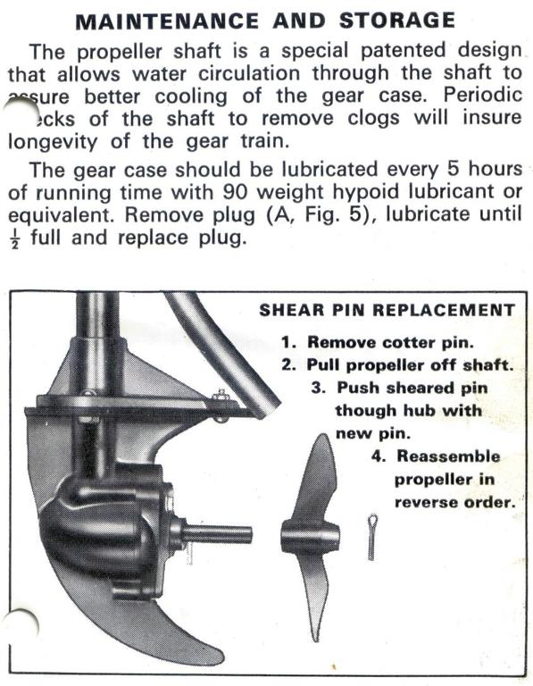

factory 487 #17 Posted April 7, 2017 I saw the triple stack picture and thought it was perfect for fools day. No fools now, here is my scan (second attempt) of the Perry Aquabug Owner's manual, the quality isn't great as the original was only a small book (pages 4" by 5.1") but it's better than nothing. Perry Aquabug Owner's Manual.pdf David Share this post Link to post Share on other sites

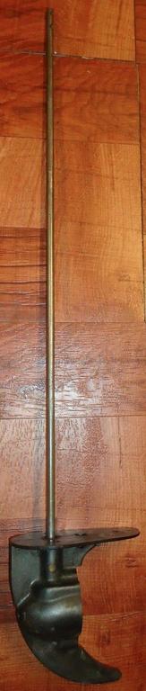

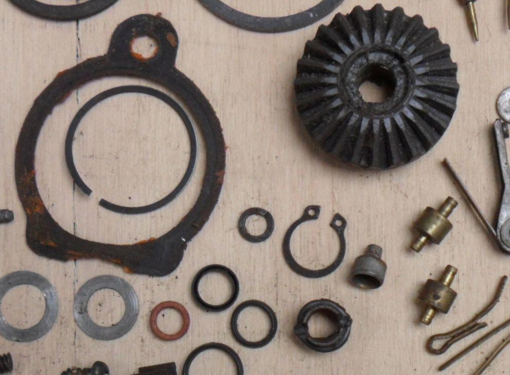

neons 16 #18 Posted January 4, 2019 Nice looking motors. The decals are pretty good shape and could be copied to make vinyl replacement decals. The manual is a nice plus also. I have my motor for sale but no price on it as I have not figured what it may be worth yet. I looked at the lower unit and it appears the oilite bronze shaft bushing may be frozen on the shaft. If it can be released and lubed it may be okay. It is a simple part for a good machinist to make a new one. It turns over fine otherwise. An exploded view would answer the question if it is a frozen bronze bearing It could be released if so. Thanks Bob Share this post Link to post Share on other sites
factory 487 #19 Posted January 4, 2019 I take it you have already separated the engine from the propeller & shaft section to confirm the lower section is seized? I actually store mine separated to prevent further damage to the fragile plastic engine covers. Sadly the manual doesn't have a exploded view of the propeller section or a parts list. One of mine has the opposite problem to yours, the engine doesn't turn the propeller (which is free to turn on it's own) , I hope it's just the shear pin that needs replacing, the pair I bought also came with some bits that may have come out of a third Aquabug. Maybe I should have a look inside the gear-case when I investigate the problem & add some pictures. David Share this post Link to post Share on other sites

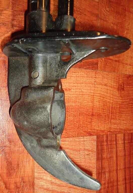

neons 16 #20 Posted January 5, 2019 I had to take it apart to find out why the motor would not turn over. I found the motor is fine with good compression. The shaft was froze in the propeller gearbox. It all came apart very easily. It had plenty of grease in there. I looked at the Oilite bronze bushing and where it meet the angle gear it appears to be a seam. The gear is what appears to be metal also. All I did was clean it up some and greased it. It is all free in the housing. But the bronze has evidently slipped in the housing. The bronze can be removed and a new bearing machined slightly oversize with some reaming the housing and make the bronze bushing a tap in bearing fit. It will be fine then. A new gasket also will need to be made. I used this motor for a few years to run ashore in harbors I sailed to. It always ran well. I also use my Tiny Power generator on my boat at times. Share this post Link to post Share on other sites
factory 487 #21 Posted January 5, 2019 I found some pictures of an incomplete one, showing the inside of the gearbox. I think it confirms where this bevel gear & broken gasket in my spare parts came from. David Share this post Link to post Share on other sites
neons 16 #22 Posted January 5, 2019 That is the bushing inside the housing . I can see the bronze tint and shoulder.. I am not sure if that bevel gear is pinned or pressed on though. So that bearing has to be freed on my shaft or cut off and the housing checked as it may have spun and enlarged the seat. The bearing would need to be made oversize for a bearing fit.. Not a hard job for a good machinist. Thanks Bob Share this post Link to post Share on other sites

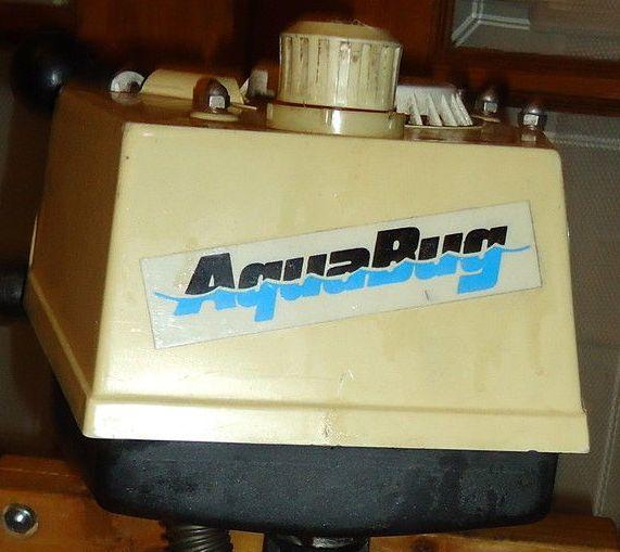

factory 487 #23 Posted January 21, 2019 This isn't mine, but here is what a new (almost) one of these Aquabug outboards would have looked like. Note it has a brass gauze instead of the normal air filter assembly. David Share this post Link to post Share on other sites

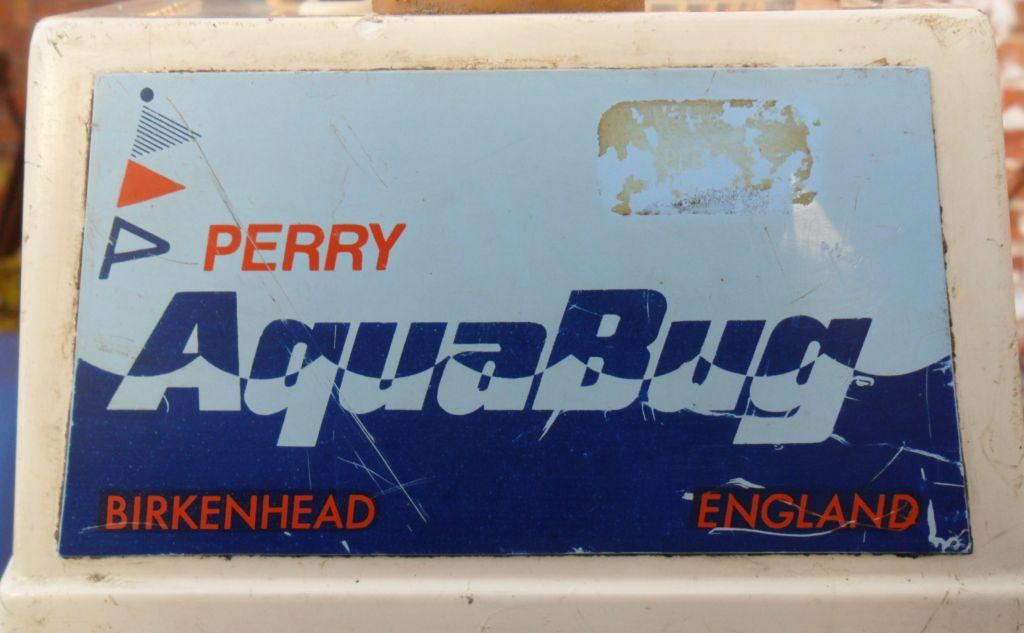

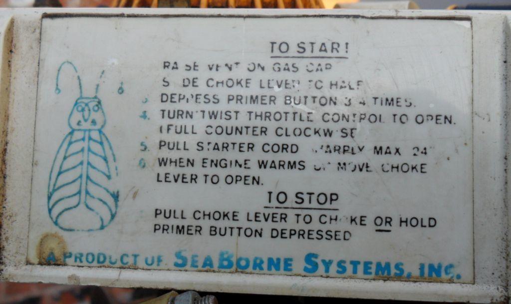

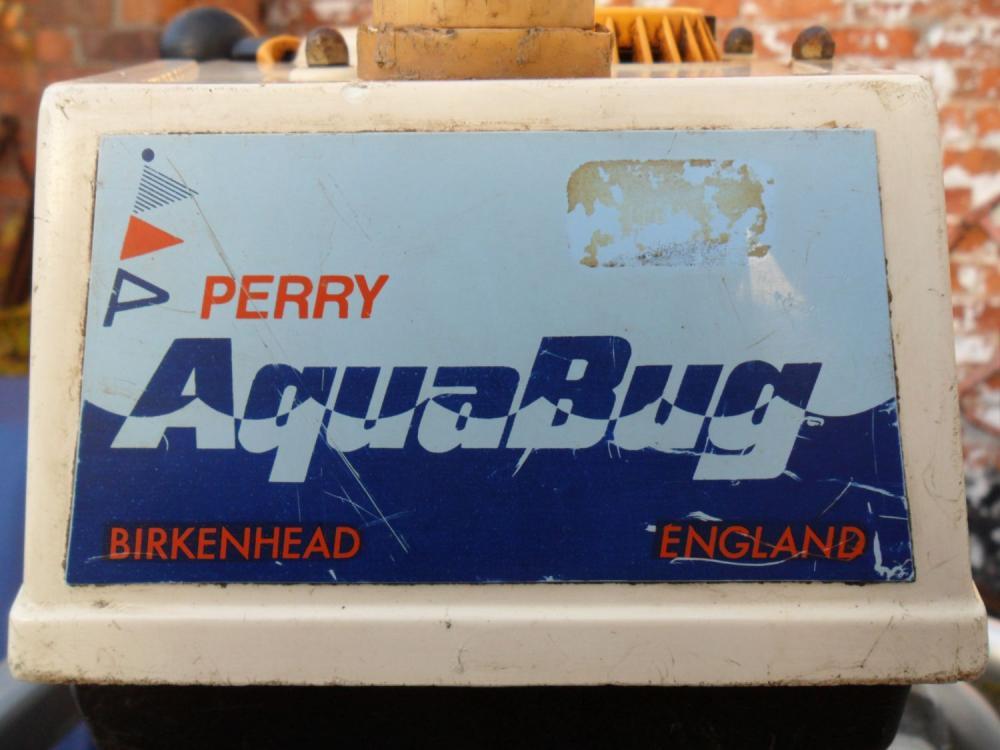

neons 16 #24 Posted January 22, 2019 Now that is a great example. It looks like it never was used. The decals would be nice to copy into a computer for restoration. They could be laser printed on vinyl stick on stock to replace worn out logo and instructions. All my motors are still in my possession waiting for an interested person to pick them up some day.When I go they will all most likely get junked. Share this post Link to post Share on other sites

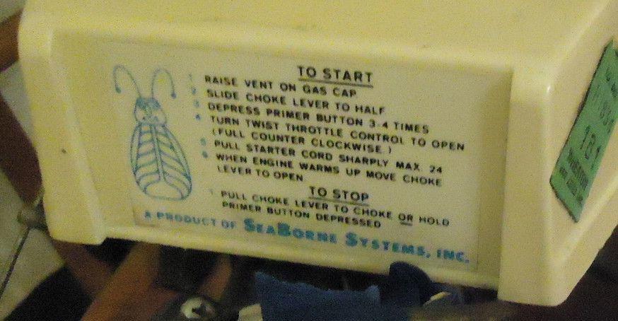

factory 487 #25 Posted January 22, 2019 There are at least three versions, each with their own decal/sticker, the Aquabug (& the UK version Perry) and the Mini Motor version, sadly none of my saved pictures are very clear for making a copy of the instructions decal. Here are pictures of the two best surviving decals on the pair of Perry Aquabug outboards from my collection, if anyone wants a better picture of these I can take some more. 7 hours ago, neons said: All my motors are still in my possession waiting for an interested person to pick them up some day.When I go they will all most likely get junked. I hope it works out with CNew & your O&R collection doesn't get junked. David Share this post Link to post Share on other sites
