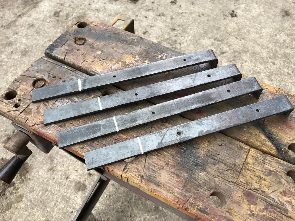

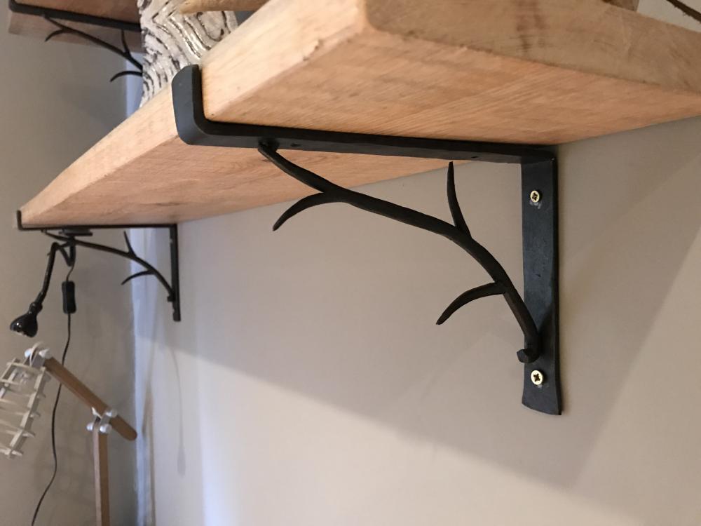

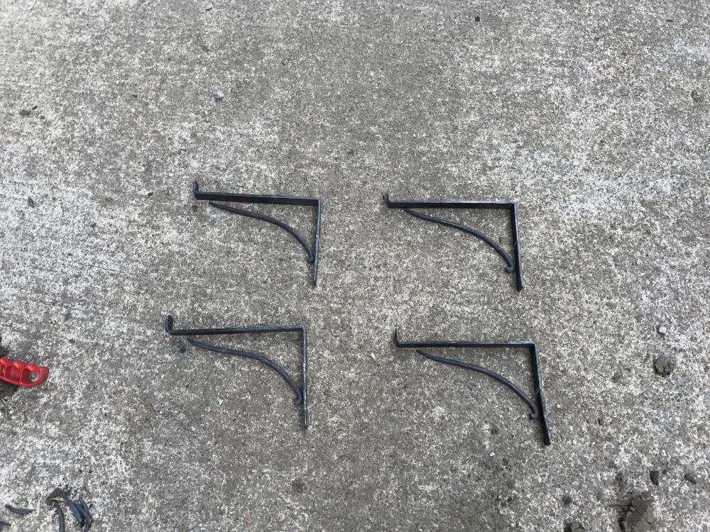

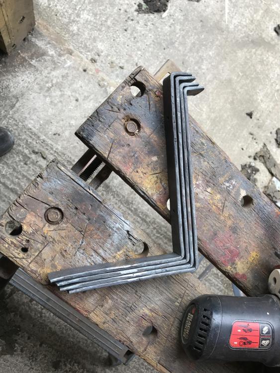

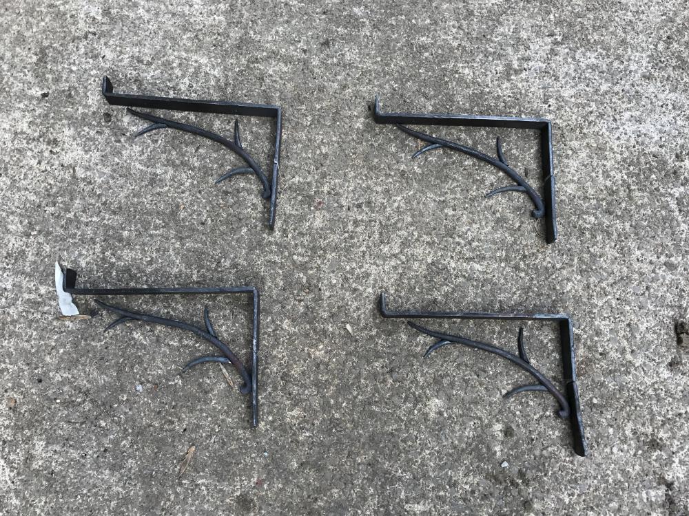

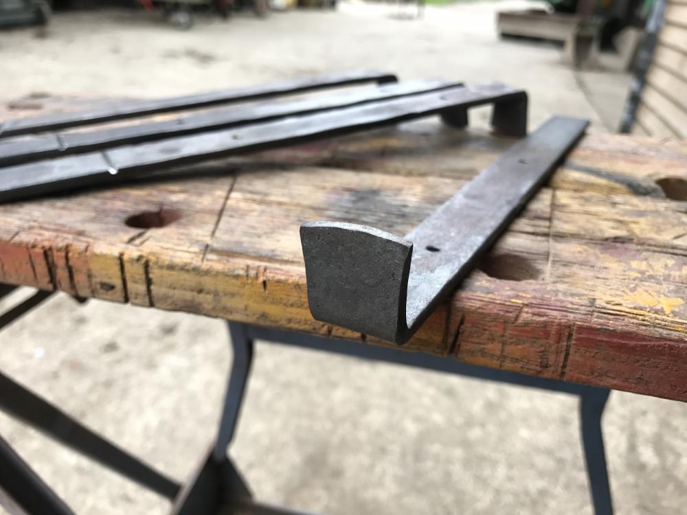

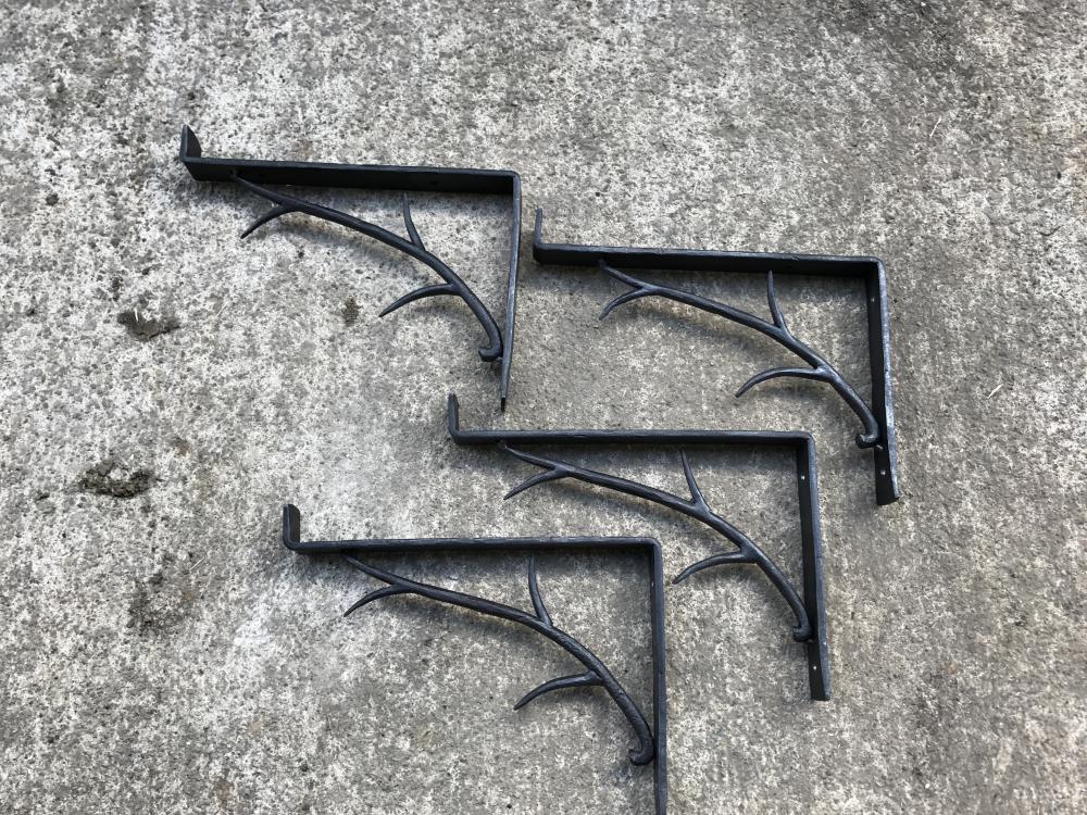

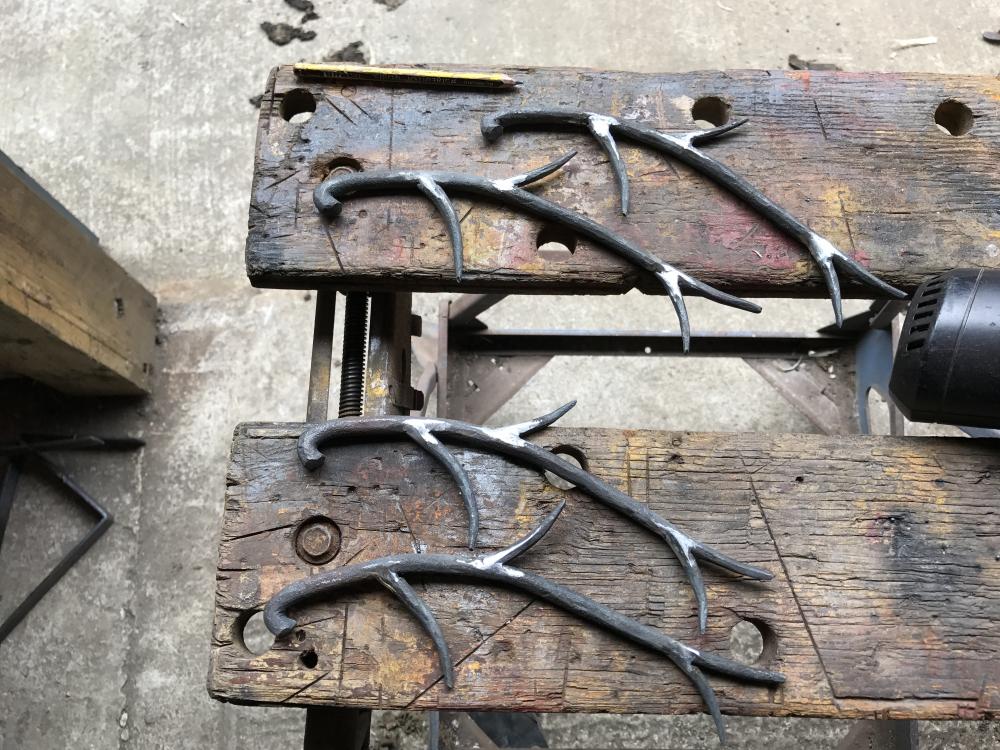

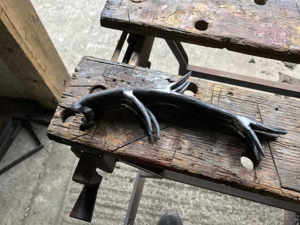

Cub Cadet 613 #1 Posted May 19, 2017 Last year I made a forge out a gas bottle we had laying around, i've made a few little things but nothing of much significance so I thought i'd make some shelf brackets. Slight cuts were put in them so I could bend them in the same place. All the components before bending, not bad to say they were done by eye Above the photo shows them with all the welding complete and a coating of wax. And the finished thing, the screws will get replaced eventually with black ones. 5 meadowfield, Stormin, nigel and 2 others reacted to this Share this post Link to post Share on other sites

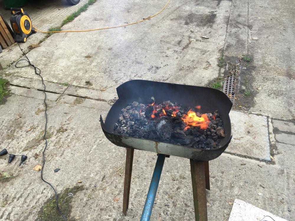

Stormin 4,458 #4 Posted May 19, 2017 I've got an anvil. May make a forge one day. The tube going under on yours and the extension lead, make me think there's a fan somewhere. 2 Cub Cadet and S1g reacted to this Share this post Link to post Share on other sites
Cub Cadet 613 #5 Posted May 19, 2017 40 minutes ago, Stormin said: I've got an anvil. May make a forge one day. The tube going under on yours and the extension lead, make me think there's a fan somewhere. I keep looking at anvils but they seem to be expensive, yes i've got an air bed pump thats rigged up to it, works well in my opinion 1 S1g reacted to this Share this post Link to post Share on other sites
