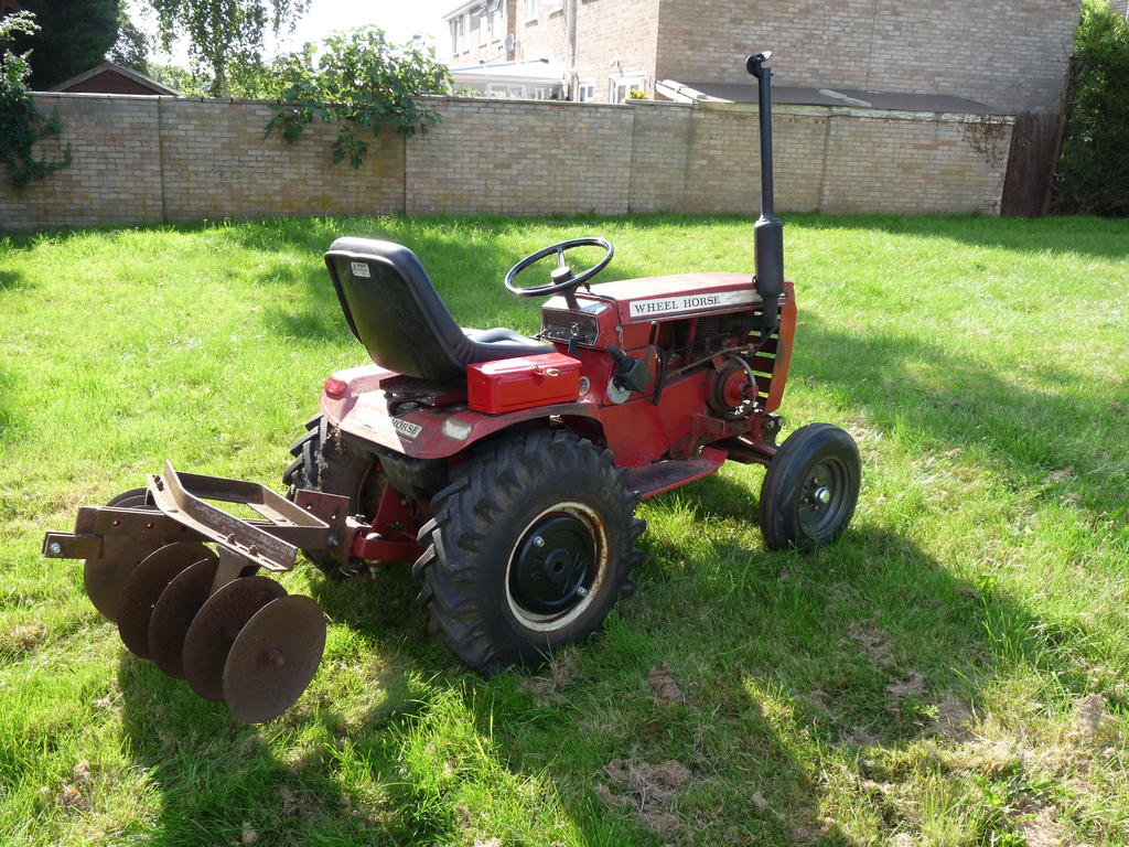

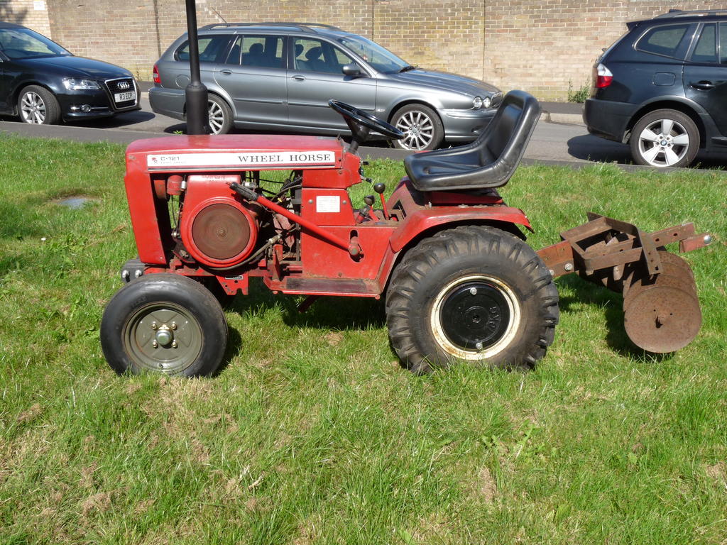

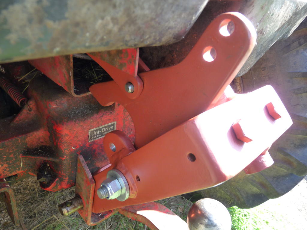

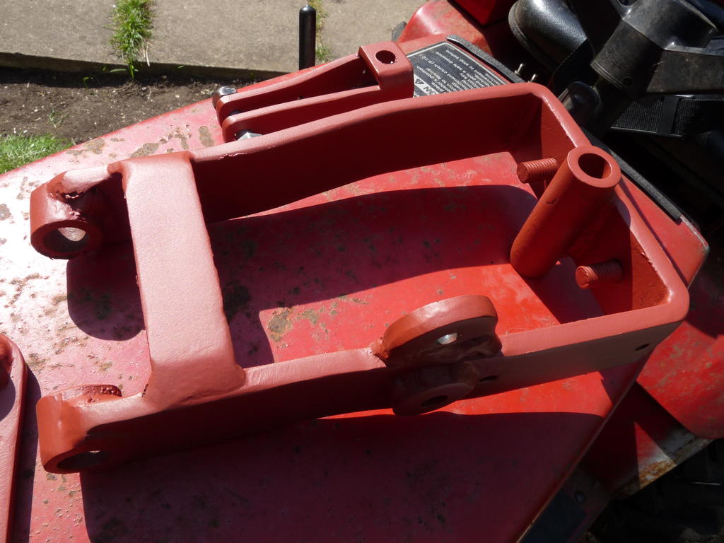

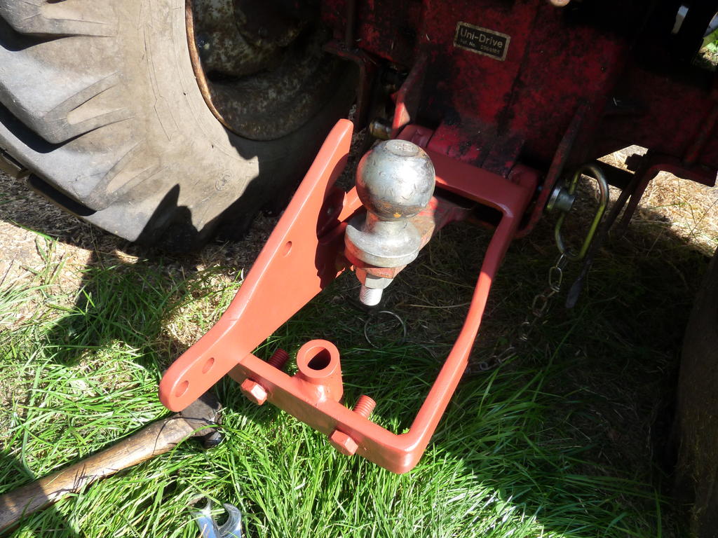

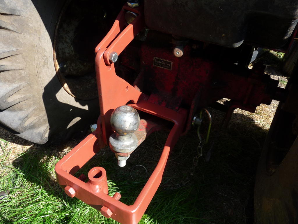

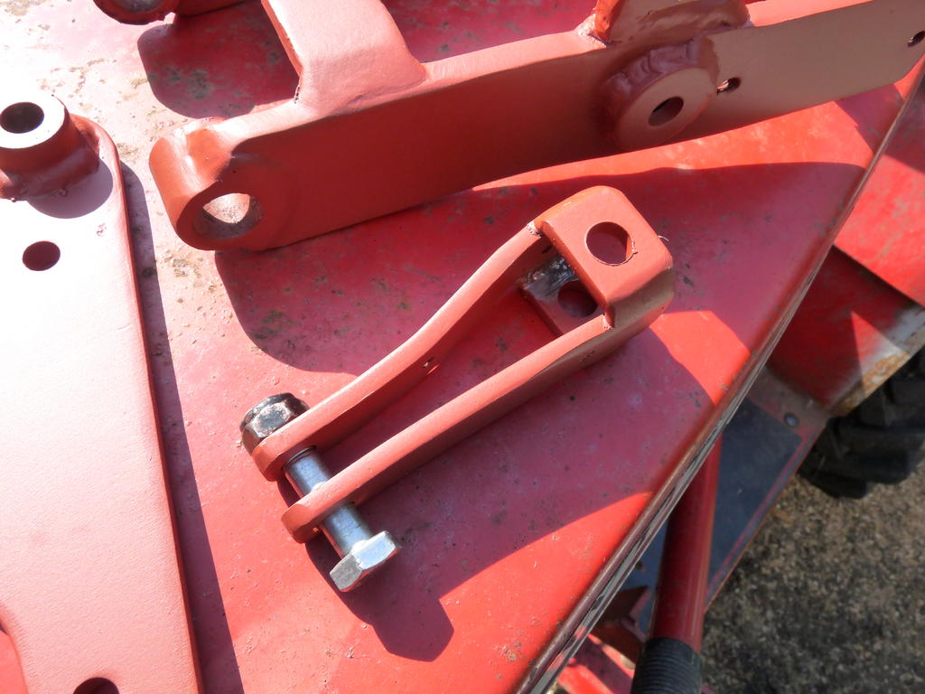

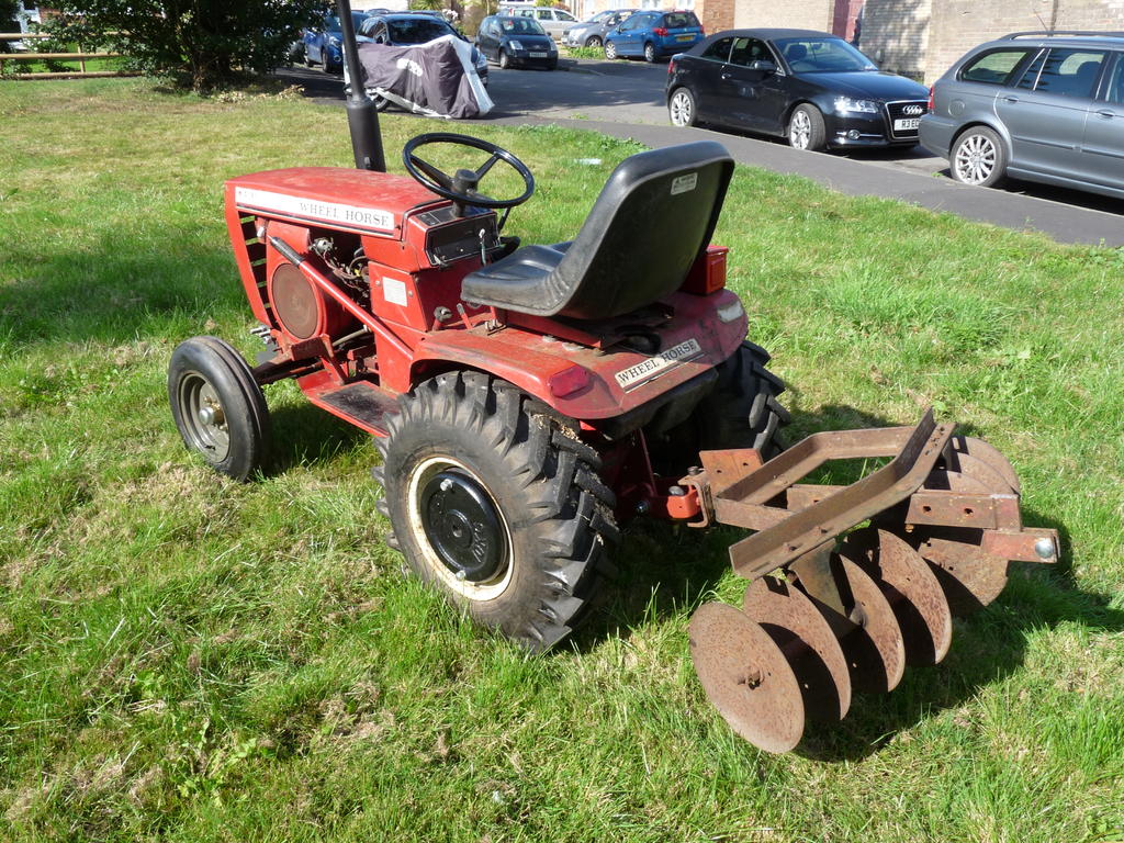

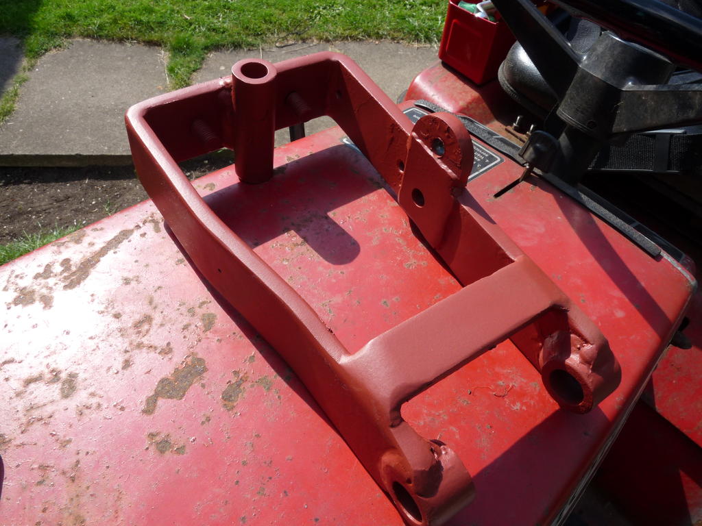

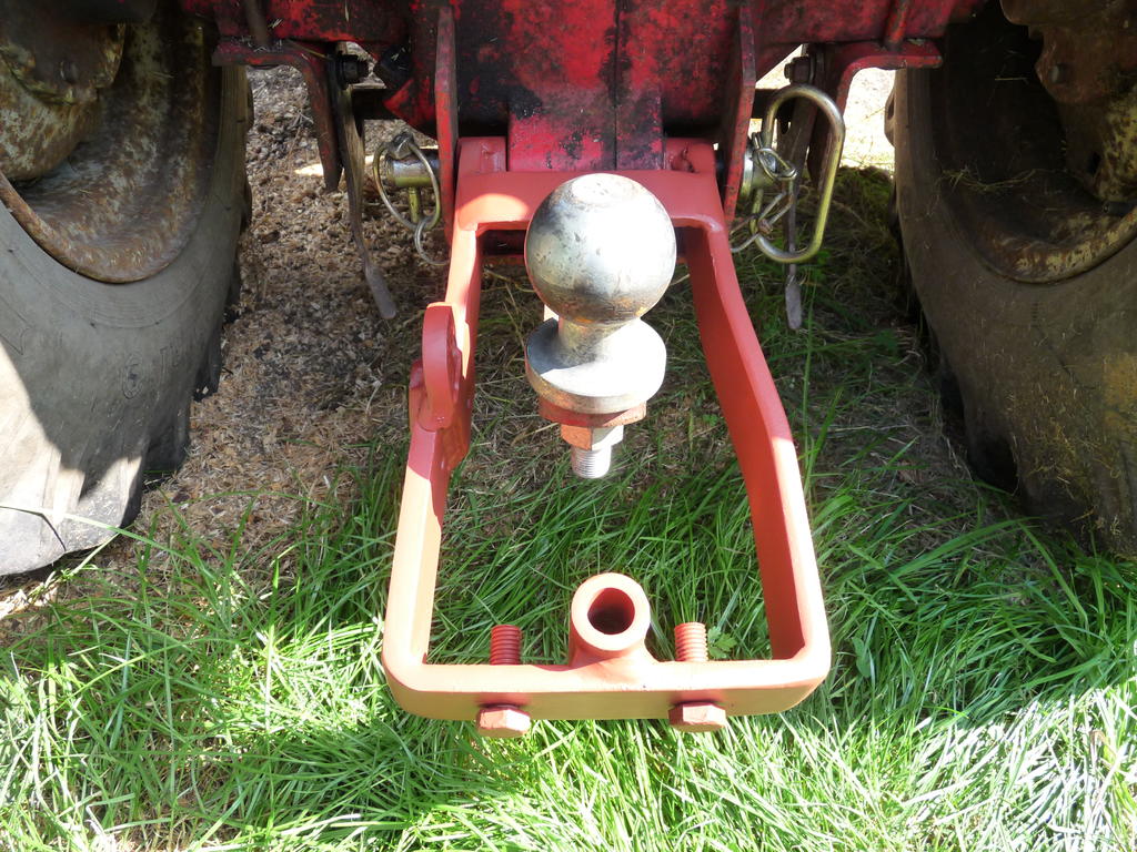

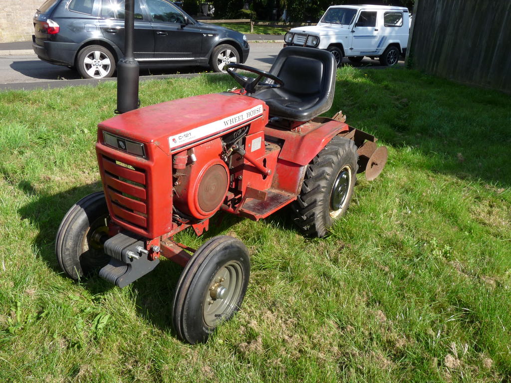

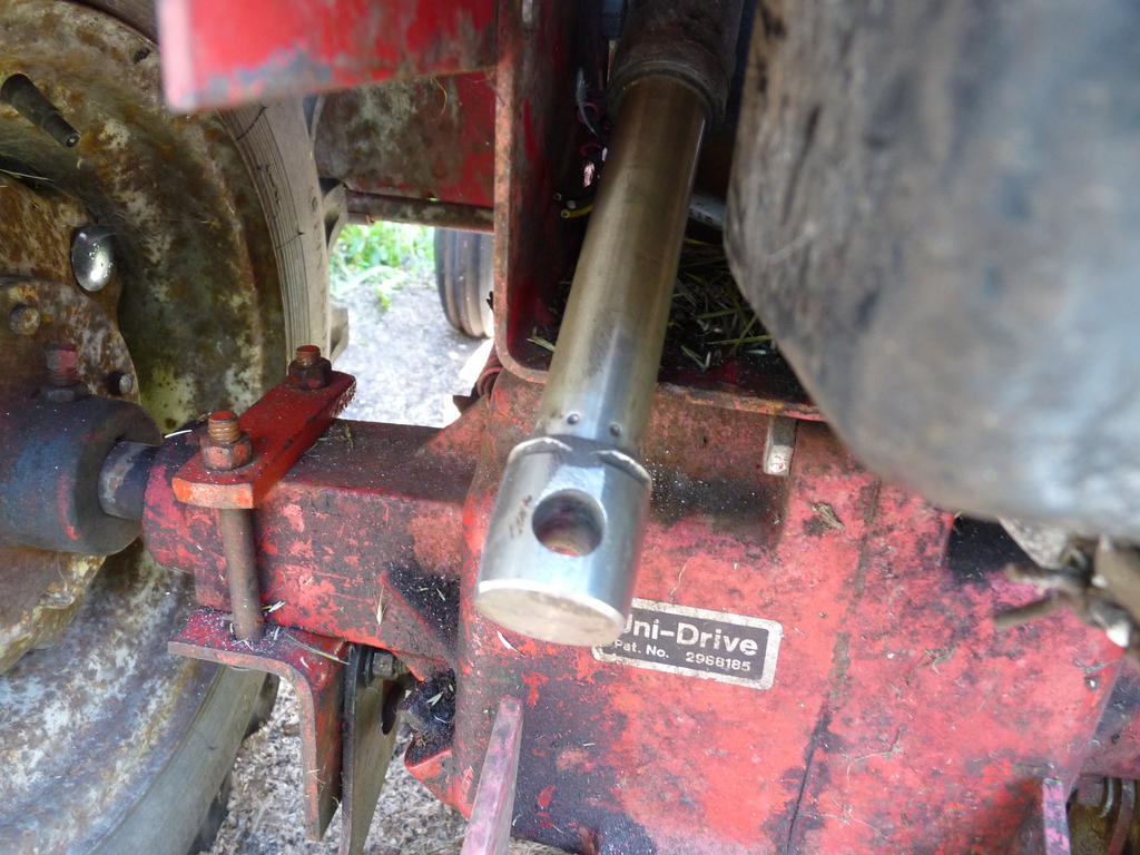

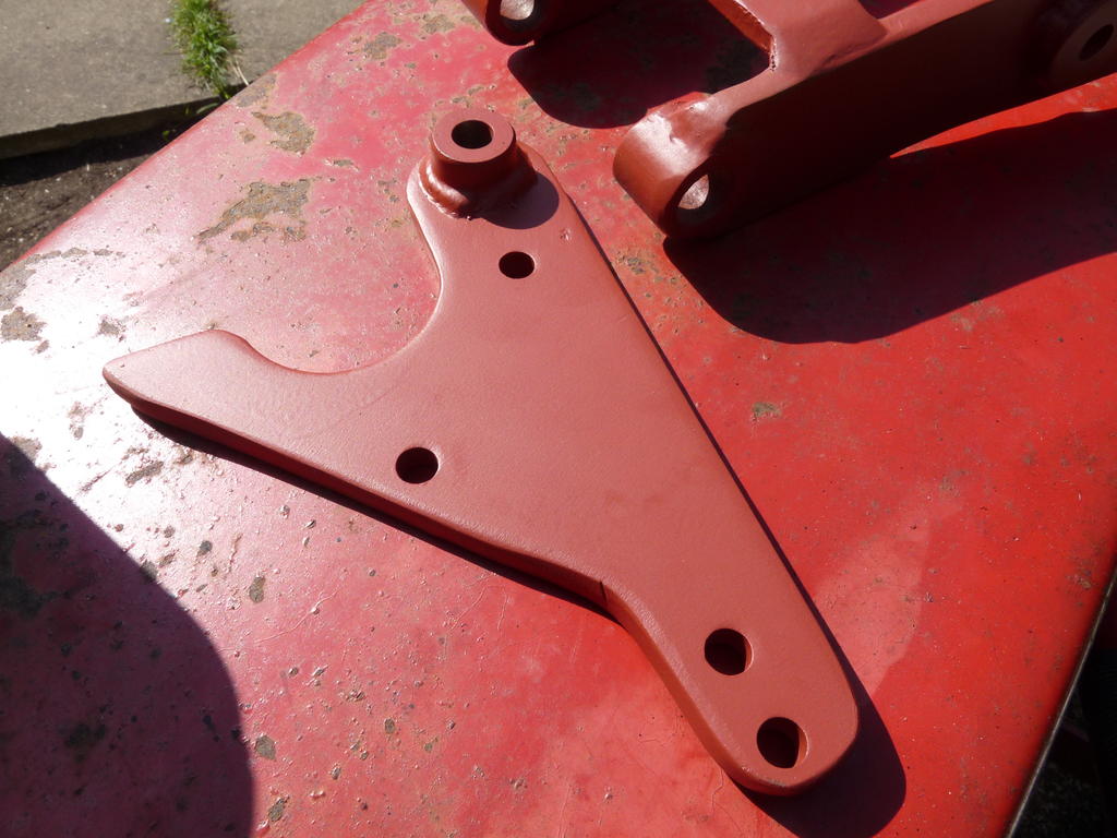

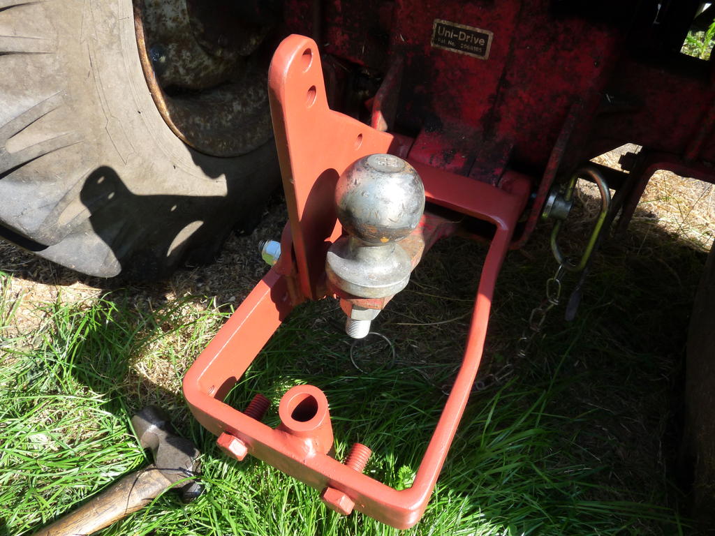

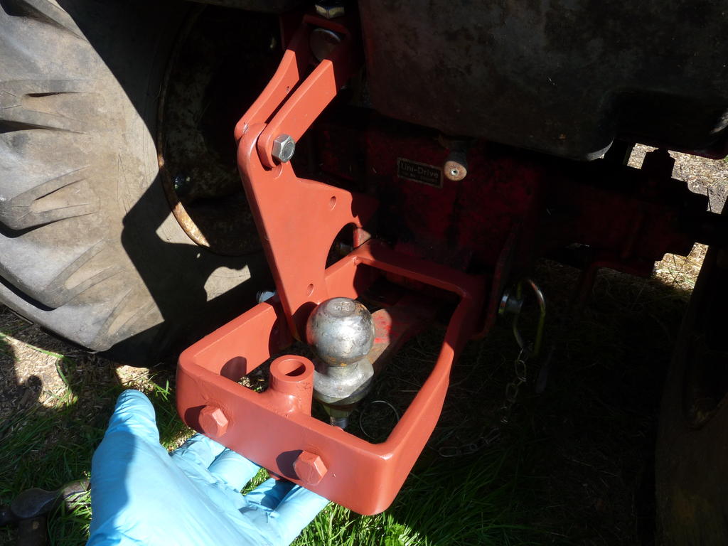

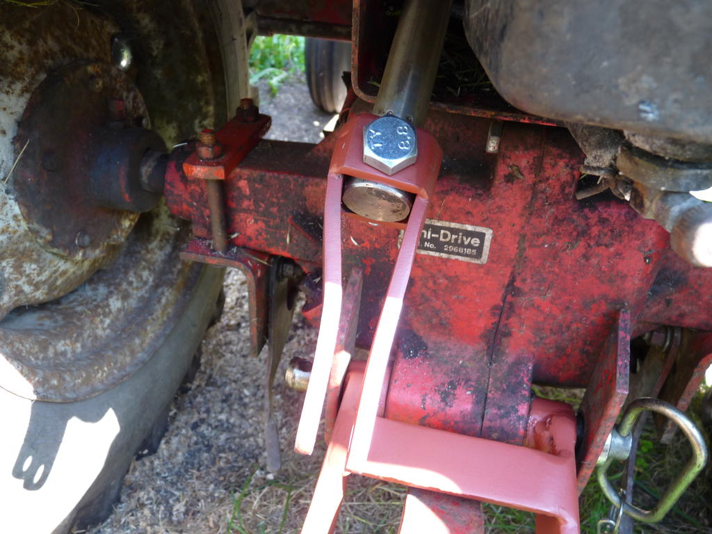

ranger 373 #1 Posted September 3, 2017 Having a bit of spare time, I decided to modify my clevis hitch. When I fitted the 'Linack' motor to operate it I used a solid link, this meant at times, the discs or cultivator would lift the back wheels off the ground. Changing the solid link to a chain solved this, but I was not happy with it. If I wanted to use the tow bar, especially with a tow ball, I had to take the hitch off. The modification allows me to have a solid link, selectable floating or not, and the hitch can be raised high enough to allow the ball hitch to be used without removing anything. I also got around to fitting the 480 x 10 tri rib front wheels and tyres they compensate for the 7 x 12 rears and level the tractor. Must clean up and paint the discs. Sorry about the extra photos, I don't seem to be able to delete them. 2 the showman and Stormin reacted to this Share this post Link to post Share on other sites

HeadExam 1,783 #5 Posted September 5, 2017 Excellent work, by adding the taller tires you allowed the tractor better ground clearance as well. 1 ranger reacted to this Share this post Link to post Share on other sites
