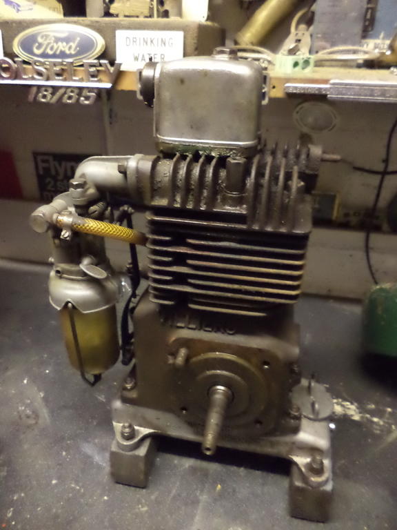

mattblack 76 #1 Posted November 24, 2018 I picked this engine up on ebay back in the summer as a winter project. After cleaning and setting the points and changing the HT lead and plug I got a good spark (much to my surprise, was sure the coil would be dead) so I have started stripping it for restoration. As you can see one thing I need is the air filter oil bath, however all the pictures I've found of other engines show it held on by 2 metal strips, rather than the wire retainer mine has. Does anyone know if they are interchangeable? I will take some pictures of where I am at now and post them up. Share this post Link to post Share on other sites

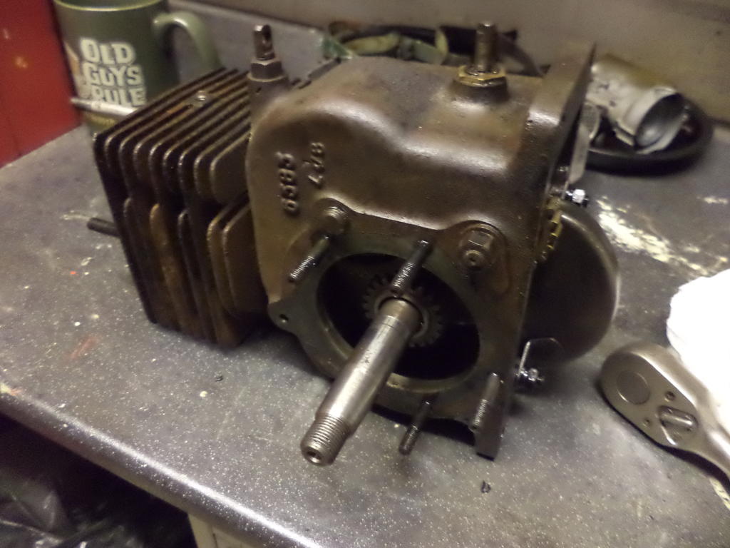

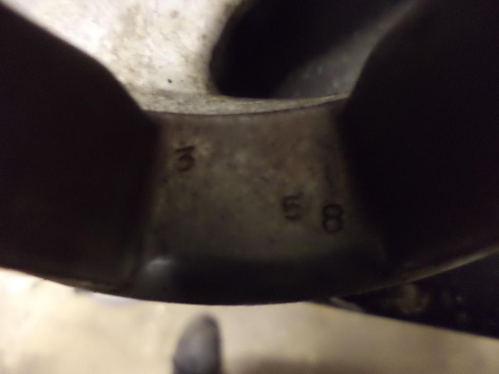

mattblack 76 #2 Posted November 25, 2018 Engine has obviously had some attention in the past, bore still looks good with no wear ridge. Someone cared enough to do this brazed repair to the pulley, maybe to to get a bit more life out of it when it was a working engine? ...on the other hand, whoever made the new seals for the fuel cap and air filter only had cork effect vinyl floor covering to hand, and their teeth for tools. Valves look OK. Is this the date code? (IE March 1958) 1 Fix'em all reacted to this Share this post Link to post Share on other sites

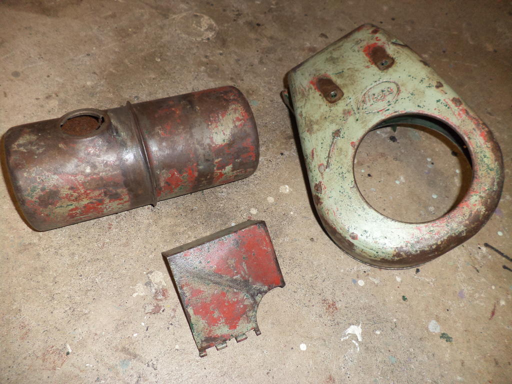

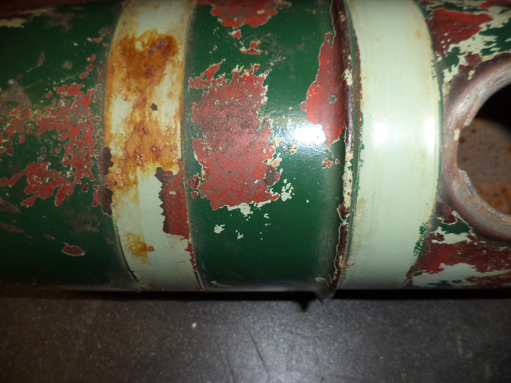

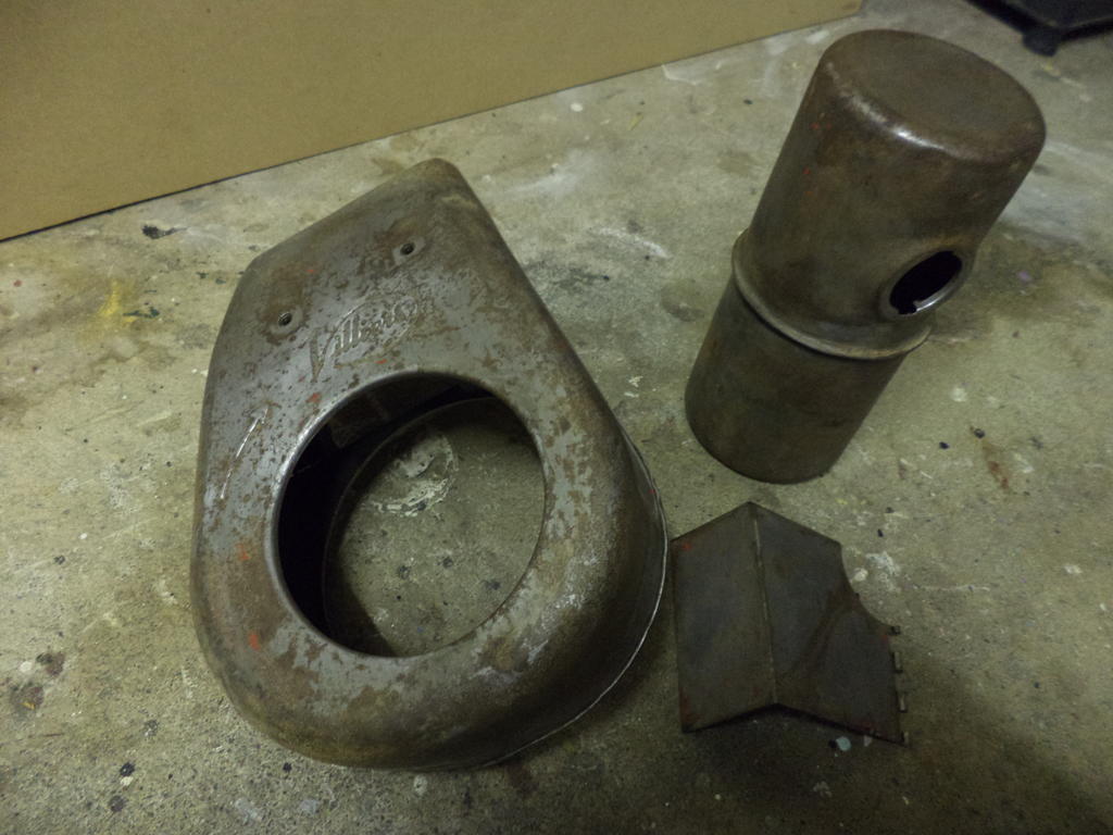

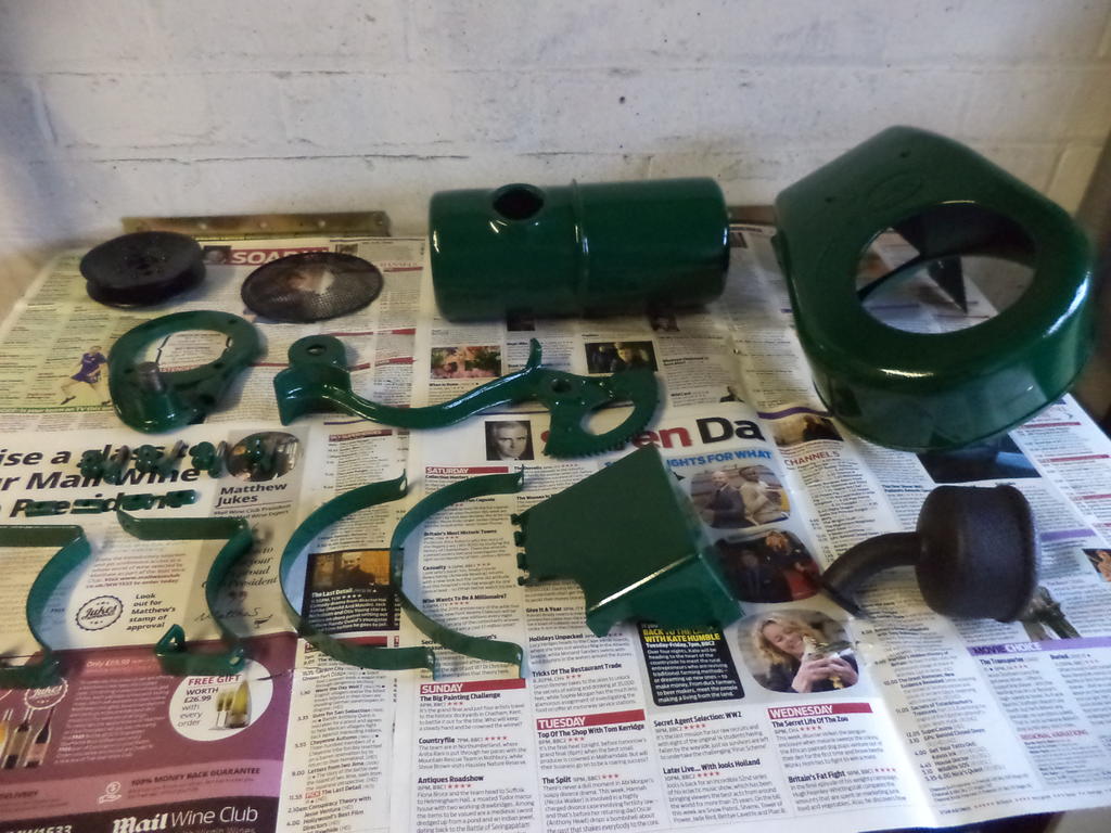

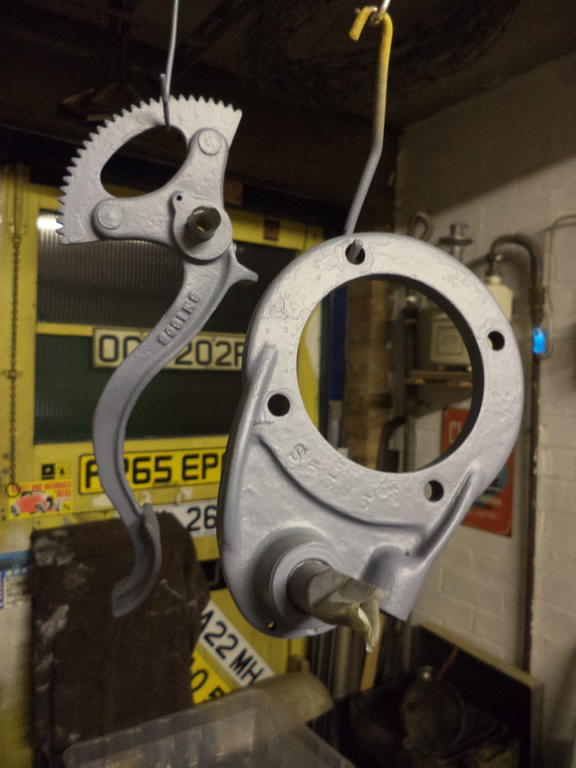

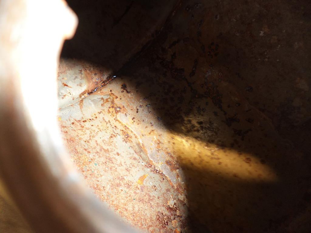

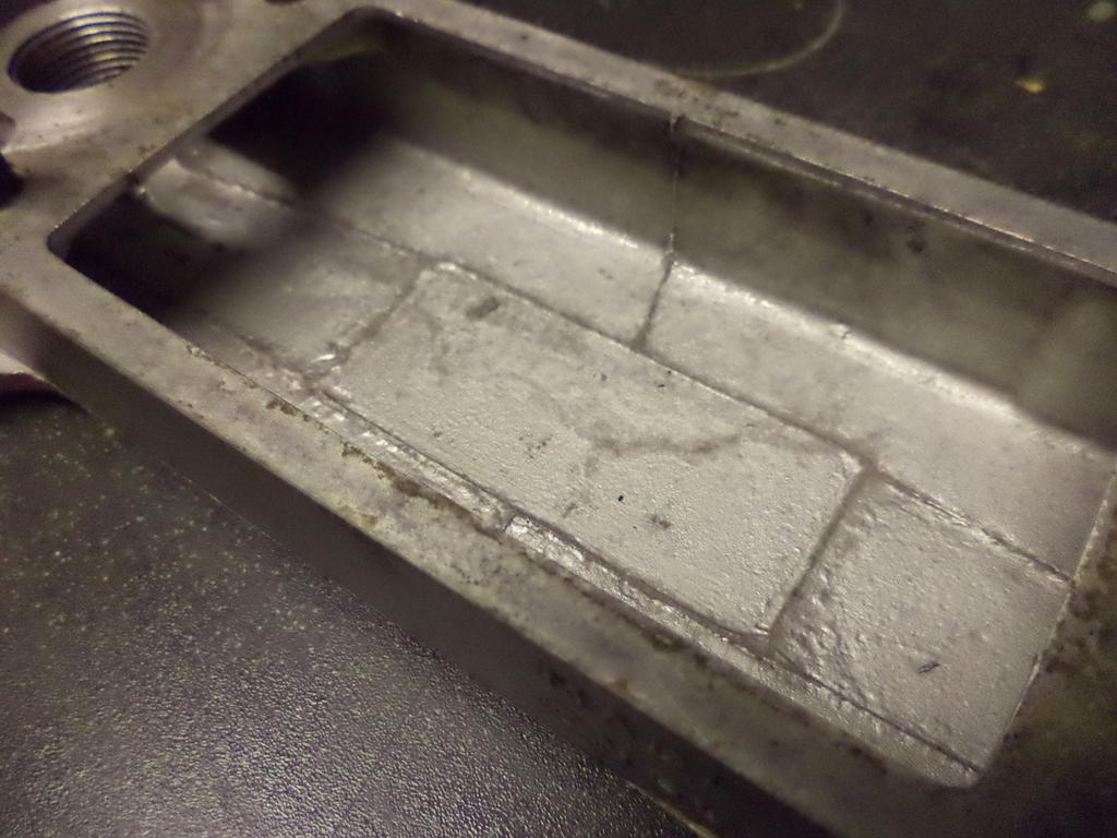

mattblack 76 #6 Posted November 30, 2018 Had a week off work, so between changing the servo on my van, changing the oil and filters, pruning the plum tree at the allotment and picking up my MK12 engine I did a bit more... Stripped the paint off the tank and cowling, is the light green an undercoat or the original colour? (cowling is dark green inside) Tank will need a clean inside, a few nuts, some brake cleaner and a good shake should do it. Sump cleaned out (oil was clean, but there was a bit of sludge in it) Can't upload anymore photos in the this post so I will continue tomorrow... 1 Fix'em all reacted to this Share this post Link to post Share on other sites

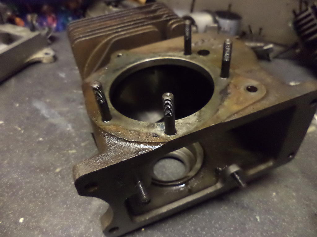

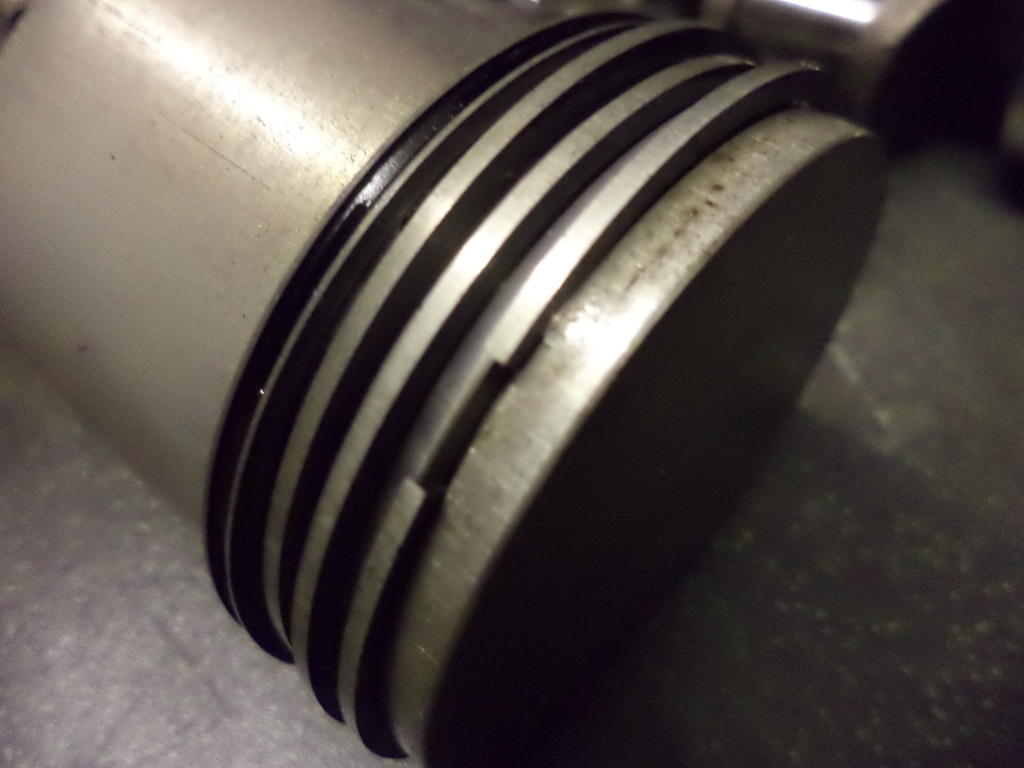

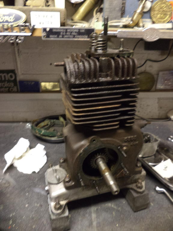

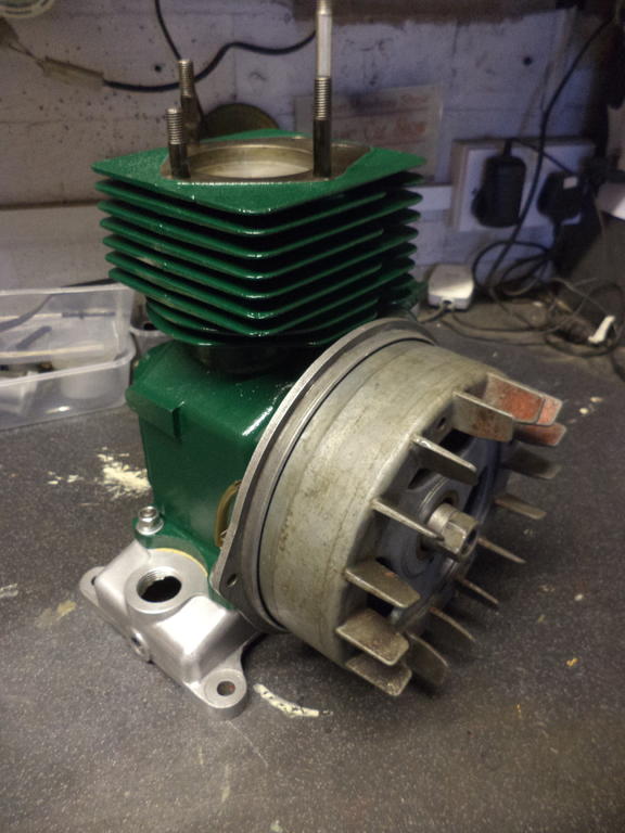

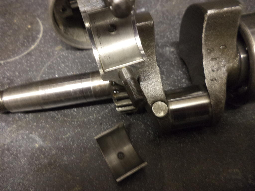

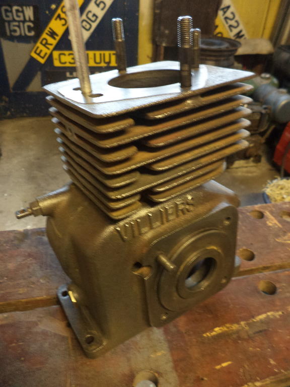

mattblack 76 #8 Posted December 1, 2018 Oh well, it has survived about 10 years of me hacking away at it in November, and in my defence it's really the O/H's allotment... Anyway, back to the important stuff... I was in 2 minds whether to strip the engine down further, but as I want to give the block a good clean and check the bearing shells I decided to at least take the piston/conrod out. Then I decided to take the crank out so I could change the oil seal, which was when the fun started... the bearing stayed on the crank, so it wouldn't come out the other side without taking the camshaft out... which wouldn't come out without taking the governor out... Piston rings rings look good, I hope my piston ring compressor goes down small enough. Shells and crank are good as well. Block ready for a good clean and paint. Will sort out a shopping list for Meetens next... 1 Stormin reacted to this Share this post Link to post Share on other sites
Stormin 4,458 #9 Posted December 1, 2018 Looks like someone's done it up at some time and it hasn't done much since. Share this post Link to post Share on other sites

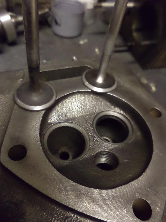

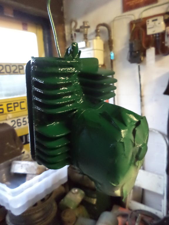

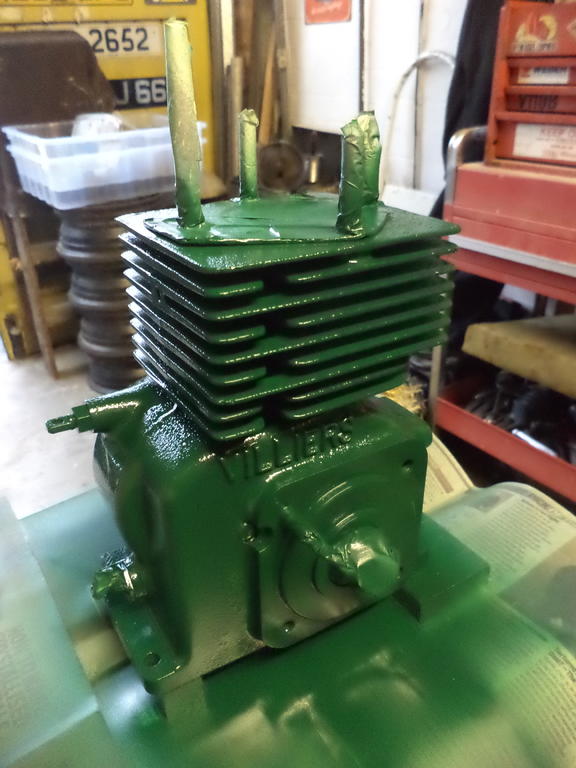

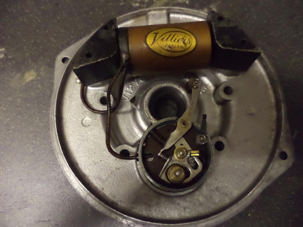

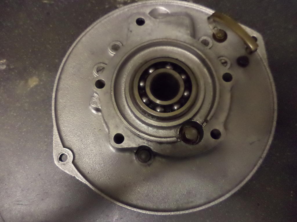

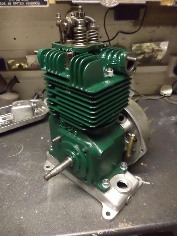

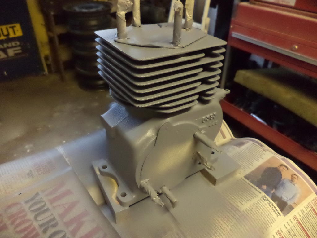

mattblack 76 #10 Posted December 23, 2018 Got a bit more done over the last few days. Head decoked and valves ground. Mag backplate cleaned up and new oil seal fitted. Block and head all cleaned up and painted. 1 Stormin reacted to this Share this post Link to post Share on other sites
Stormin 4,458 #11 Posted December 24, 2018 Looking good. Share this post Link to post Share on other sites

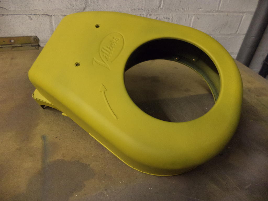

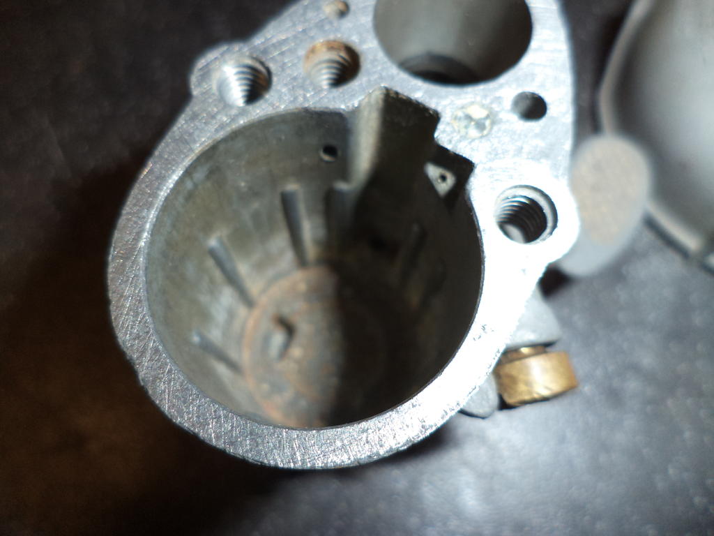

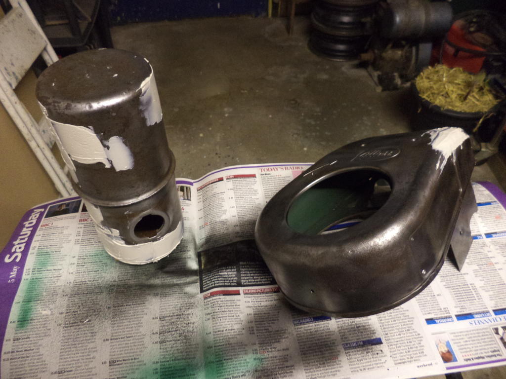

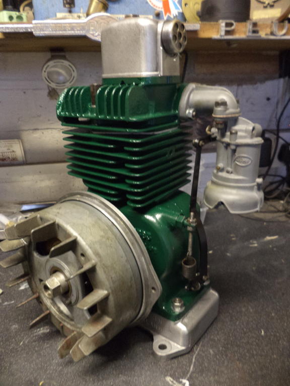

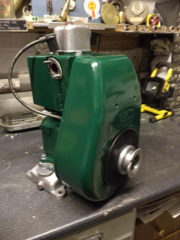

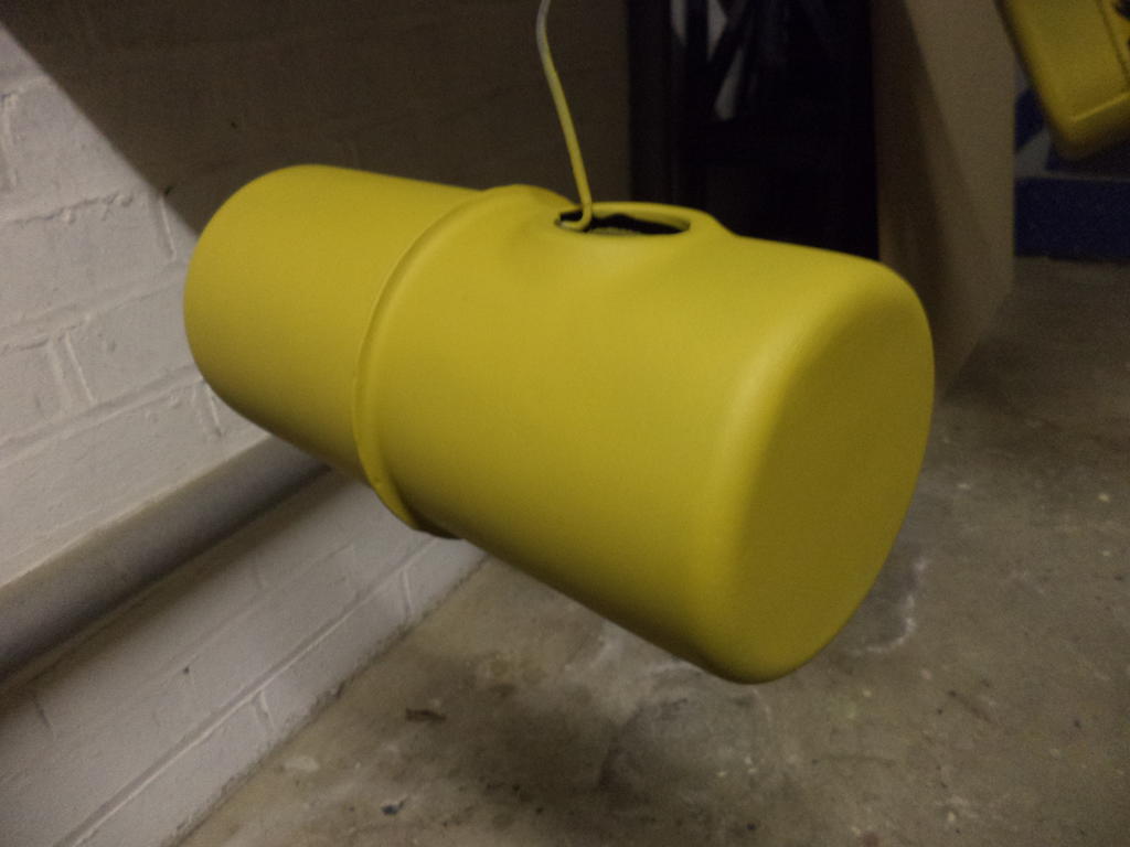

mattblack 76 #13 Posted January 20, 2019 Made a bit more progress. The carb was a bit crusty inside. looked like it may have had water sitting in it but it cleaned up OK. coming back together. Cleaned up the tank and cowling and filled the dents. 1 Anglo Traction reacted to this Share this post Link to post Share on other sites

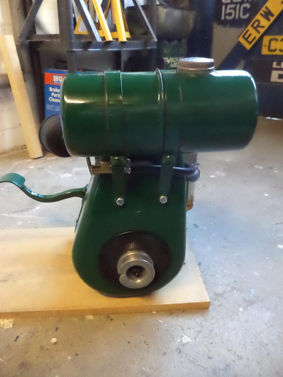

mattblack 76 #14 Posted February 15, 2019 Slowly coming together. 3 Anglo Traction, S1g and Stormin reacted to this Share this post Link to post Share on other sites

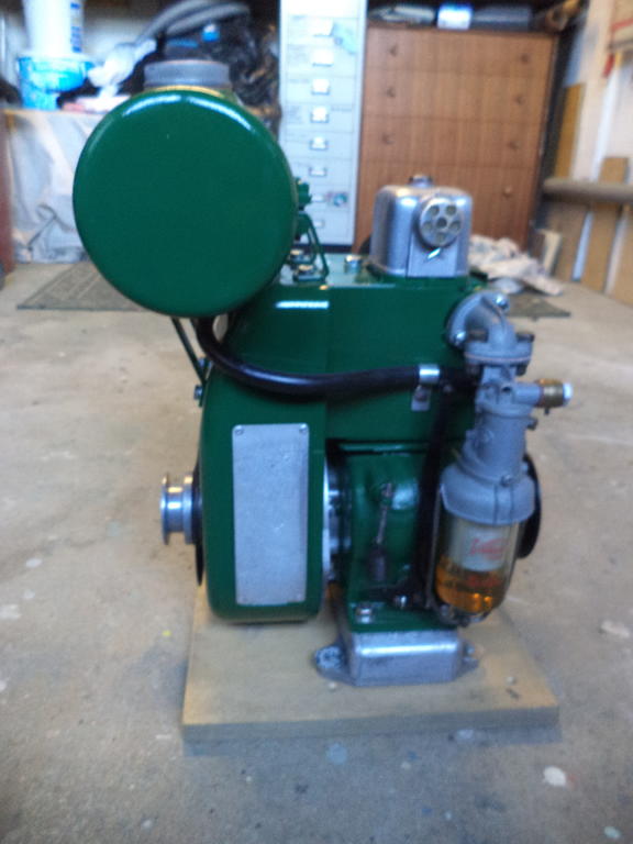

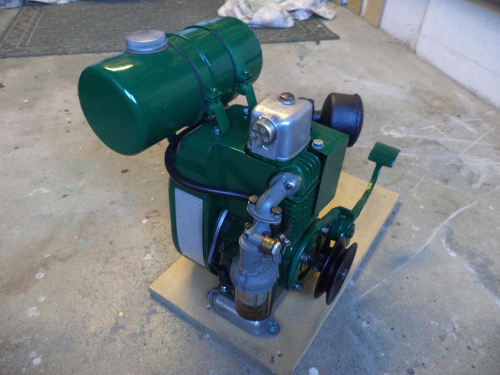

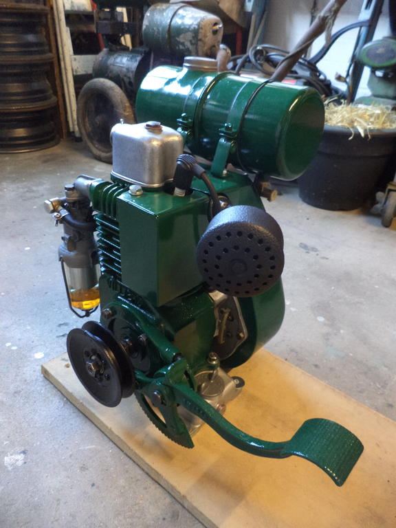

mattblack 76 #17 Posted February 27, 2019 Well, I'm calling this (sort of) finished... I screwed it to a bit of scrap MDF as a temporary measure to run it, and much to my surprise it started on the third kick. However, it was 'hunting' badly and after playing with the governor setting with no real improvement I called it a day. Yesterday I had a closer look at the carb and checked the manual re: setting and discovered that the mixture screw is missing! Looking at the 'before' photos it was missing when I got the engine. I have emailed Meteens so hopefully I will be able to get it running properly. If so I will try to post up a video. 2 Fix'em all and Stormin reacted to this Share this post Link to post Share on other sites
Stormin 4,458 #18 Posted February 28, 2019 That looks really nice. Well done. Share this post Link to post Share on other sites
nigel 1,881 #19 Posted February 28, 2019 Fantastic job Share this post Link to post Share on other sites
mattblack 76 #20 Posted February 28, 2019 Thanks for the kind words, there are a couple of bits where the paint coverage is poor (probably didn't have my glasses on!) and some petrol splashed out of the cap when I ran it (my fault, it wasn't tightened right up) so I've touched the tank up with a brush. But overall I'm pleased with it and have enjoyed doing it. Share this post Link to post Share on other sites
mattblack 76 #21 Posted March 6, 2019 I re-did the bits with the poor paint as I knew it would bug me, and I couldn't resist the decals when I saw them on ebay... NOW I'm calling it finished. Share this post Link to post Share on other sites
