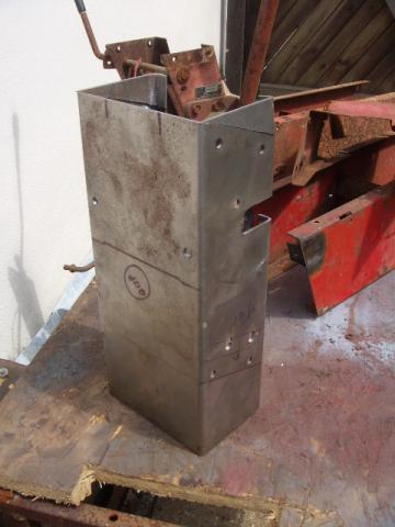

the showman 4,074 #1 Posted February 25, 2014 This build is one I did a while ago, but for those who hav'nt seen it I thought I would share it with you. We often say we have enough parts to build another one so here we go. as you can see I started with the chassis but all the old ones have a lot of holes in so I decided to make a new one, out with chop saw and stick welder , next was a transmission. 1 neil reacted to this Share this post Link to post Share on other sites

the showman 4,074 #5 Posted February 26, 2014 next on the list is front wheels, I want to use early narrow one's and the early narrow rear's as well. the engine iam going to use is an 8 hp kohler with electric start. using a 8 speed tranny the 8 hp will be plenty. next the bonnet and for looks I went for the charger 12. the dash stands that I have are a bit rusty so I bent up a new one 1 ranger reacted to this Share this post Link to post Share on other sites

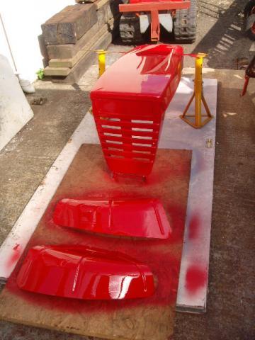

the showman 4,074 #22 Posted March 2, 2014 here's some red bits Share this post Link to post Share on other sites
