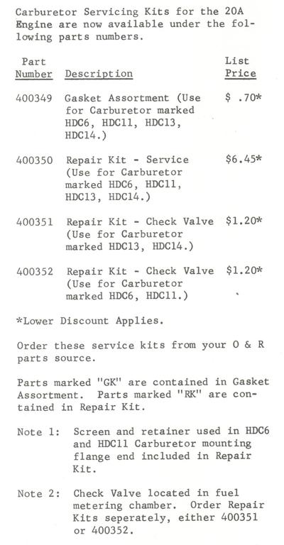

CNew 408 #4 Posted July 14, 2019 Nice saw, that should definitely clean up well. I got the carb kit off eBay. I went with a genuine Walbro K10-HDC carb kit. They’re pretty common and run anywhere from $9-15. Oregon and Rotary brand also appear to have kits. My saw has a Walbro HDC-14 model carb. I think the K10-HDC kit covers several of the HDC carbs. It was actually much easier to rebuild than I was expecting. This kit only came with gaskets, diaphragms, screens and needle valve. Hope that helps! 7 hours ago, HeadExam said: Using modern 2 stroke oil you can safely run them at 40:1 or even 50:1. I use Amsoil Saber at 50:1 in old saws(1965-1975) and 100:1 in my new big Husqvarna strimmer for the last year or so. Amcoil maybe the best two stroke oil out there. Very nice shape. Thanks HeadExam. I’ll have to try to find some of the Amsoil (that’s a synthetic correct?). I’ve heard great things about it. I’ve had good results so far with the Stihl oil, been using it at 32:1. Share this post Link to post Share on other sites

factory 487 #8 Posted July 14, 2019 41 minutes ago, JUST O&R said: THE DIAPHRAGMS FOR MY OLDER ONE ARE HARD TO FIND I THINK THE # IS 400102. That is an O&R or AEP number, you will only find new-old-stock of those as AEP (Advanced Engine Products Inc) closed down in 1978. Edit: Where did you find that number (#400102)? As it is a replacement carb diaphragm assembly for the smaller 1HP Compact & Series 13 engines, no use whatsoever for the Series 20A engine used in these chainsaws. 25 minutes ago, JUST O&R said: I WOULD LOVE T HAVE AN ORIGINAL . HOW DO I GET ONE ? This may help with part numbers for the O&R repair kits if Webhead still has any (send him a private message). David 1 HeadExam reacted to this Share this post Link to post Share on other sites

factory 487 #20 Posted July 15, 2019 21 hours ago, CNew said: I attempted to tune up the Mark II this afternoon with no success. After rebuilding the carb and resetting the H, L and Idle settings per the manual I thought it would fire up and at least idle for a bit. No such luck. All it does is fire and run for maybe 1-2 seconds. I also put in a brand new spark plug. So at this point I can’t keep it running long enough to do any tuning. Is it difficult to start as well? Here is what the service bulletin has for 'will not idle' (HeadExam has already mentioned most of them); Edit: Also found the service manual mentions blocked fuel tank vent, as a possible cause of only running for a short time. Or there may be a cracked fuel line to the carb. David Share this post Link to post Share on other sites
