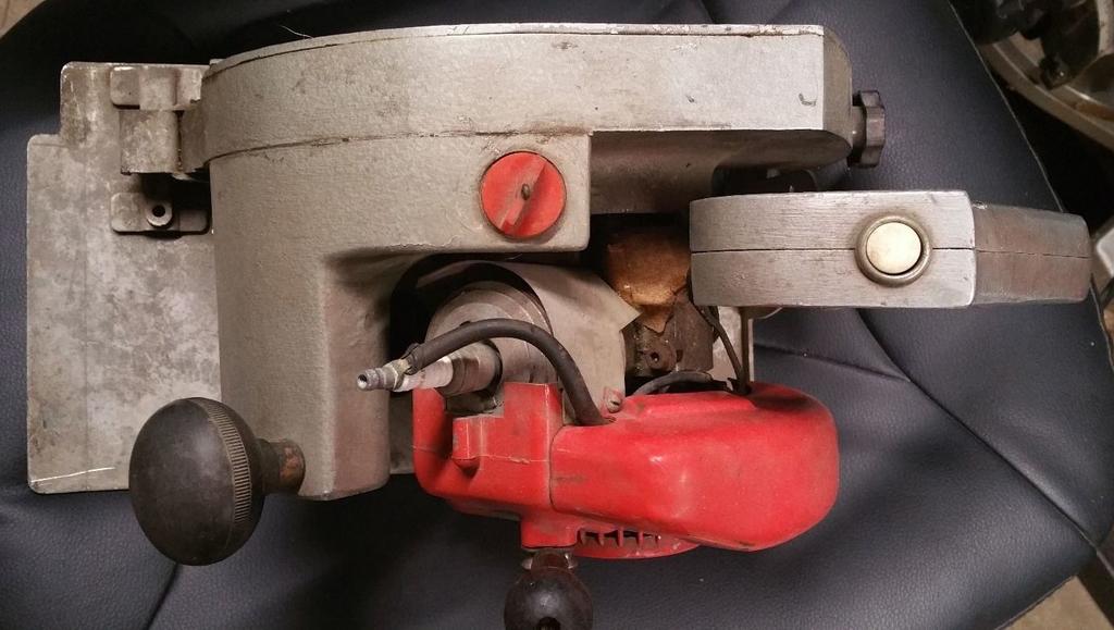

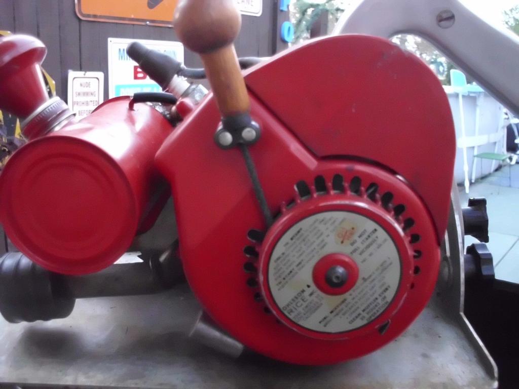

JUST O&R 237 #1 Posted July 21, 2019 Well here is the project I'm working on now. This is the first O&R I acquired it was about 35 years ago my brother worked at a mower shop in Florida. His boss was going to threw it out and I said I will take it . I took it apart and was going to get it running but life gets in the way I was only about 16 maybe 18 not sure . Its been in a box for a long time 6 to 7 moves 3 states . I found it in a box a few years ago and this it what started it all . Missing a few parts must have got lost in the moves but well get it together . For the last few years I have been buying them when I can. thanks to a few good people I now have a few diaphragms to get it going and a few more. Missing the clamp to hold blade and blade. Just found a blade on ebay 8" is not on all the store shelves. 2 1 CNew, factory and Wallfish reacted to this Share this post Link to post Share on other sites

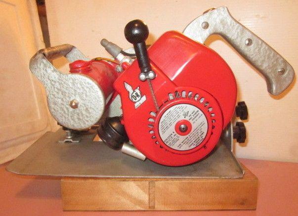

factory 487 #2 Posted July 22, 2019 Nice that's an early one with the starter housing screws in the back, I've seen several new looking engines for these C-Saws on eBay over the years, no idea what people did with the rest of the saws. Are 8" blades obsolete too? I've found 4" grinding discs are no longer made too, they must do it deliberately to get people to buy more tools they don't need. David Share this post Link to post Share on other sites
JUST O&R 237 #3 Posted July 22, 2019 I'm sure this is an older unit it is one of the only ones Ive seen with this tank. I think you had a posted about popular science 1962 I think its about the same. I have not seen one of this saws with the same tank . the one Ive seen have a aluminum tank with a knob on it this one has a round tank with a handle over the top . I will get the ser # maybe someone can tell me the year p.s I was looking for a 4" grinding wheel went three places to find some . Its like every thing, make it for a few years and change it. Then discontinue it. Share this post Link to post Share on other sites
Wallfish 718 #4 Posted July 23, 2019 35 years, and I thought I was a procrastinator. I'm lightning fast now compared to you. LoL The blower housing is an early version as David noticed but the coil isn't. I have a couple of the earlier saws with the can style tank like yours. Think the other tank style is branded under a different name Share this post Link to post Share on other sites
JUST O&R 237 #5 Posted July 23, 2019 ya I'm a little slow. The wires on the original coil are coming apart can't seem to find one like that. The only one I have that's is about the same is on my pump and not taking that apart. Has anyone tried to replace the wire I have considered trying some unscrew out and some don't. Share this post Link to post Share on other sites
CNew 408 #6 Posted July 23, 2019 I wonder if you could use heat shrink tubing to repair the old wire, either over top of the existing broken wire or maybe pull of the old brittle wire insulation and add heat shrink or something? I attempted a combo fix like this on an old Briggs motor that had wires that looked like the ones in your photo. Nice pump by the way! Share this post Link to post Share on other sites
JUST O&R 237 #7 Posted July 23, 2019 Thanks was like that when i got it. a considered shrink wrap but this is the wire that goes around by the cylinder. I think I'm going to try to take it out its no good the way it is. it looks to be sealed in with something. absolutely would like to use this original if I could but the A-149-3 is the replacement. Share this post Link to post Share on other sites
factory 487 #8 Posted July 23, 2019 8 hours ago, JUST O&R said: ya I'm a little slow. The wires on the original coil are coming apart can't seem to find one like that. The only one I have that's is about the same is on my pump and not taking that apart. Has anyone tried to replace the wire I have considered trying some unscrew out and some don't. Those early coils often have crumbly insulation on the wires, heat-shrink sleeving works OK, just be careful not the overheat the plastic casing of the coil. David Share this post Link to post Share on other sites

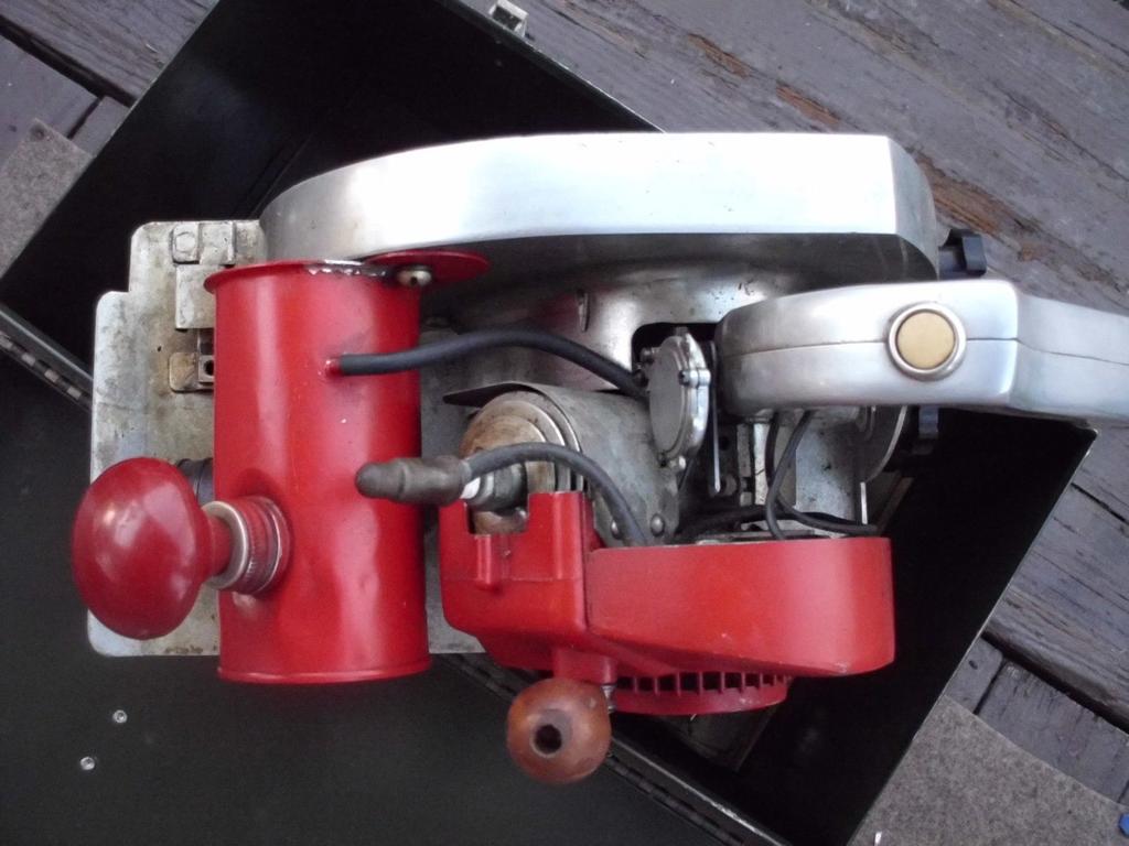

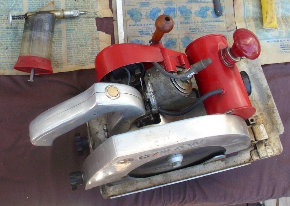

factory 487 #9 Posted July 23, 2019 21 hours ago, JUST O&R said: I'm sure this is an older unit it is one of the only ones Ive seen with this tank. I think you had a posted about popular science 1962 I think its about the same. I have not seen one of this saws with the same tank . the one Ive seen have a aluminum tank with a knob on it this one has a round tank with a handle over the top . I will get the ser # maybe someone can tell me the year p.s I was looking for a 4" grinding wheel went three places to find some . Its like every thing, make it for a few years and change it. Then discontinue it. 19 hours ago, Wallfish said: I have a couple of the earlier saws with the can style tank like yours. Think the other tank style is branded under a different name There are three different versions of the Comet circular saw that I know of; The first & earliest (1961 or earlier) branded Comet C/Saw, I can't imagine many survived for long without the tank getting damaged; Second version same as yours, also branded Comet C/Saw with improved tank handle; And finally the later version, branded Comet Tote'N Tools, with cast tank; Have you got the special cover that Comet used for the magneto coil? David P.S. None of these are mine, I only have a Comet pump myself. 1 CNew reacted to this Share this post Link to post Share on other sites
CNew 408 #10 Posted July 23, 2019 David, thank you for adding the other photos, it’s neat to see the various generations of this saw. Clint Share this post Link to post Share on other sites
JUST O&R 237 #11 Posted July 23, 2019 The one I have looks like the second set of pics that is the same handle I have .no I don't have the cover for the coil. Do you know if the wires will come out would love to put in a new wire. I try to keep them original if I can some time it doesn't work out . This one I had to paint the lower plate And I will need to paint the handle on the tank . I'm sure that I will never find one of this old coils but it will run again!!! Share this post Link to post Share on other sites
factory 487 #12 Posted July 24, 2019 17 hours ago, JUST O&R said: Do you know if the wires will come out would love to put in a new wire. I try to keep them original if I can some time Unfortunately the wires don't come out of those coils (not without destroying them anyway), they will probably be soldered inside too. They often have perished rubber wiring, hence why I sleeve them, never seen a new coil for sale over here either. I have seen the the plug wire fallen out of several later coils, exposing a pin at the bottom for the connection, but this won't help with the earlier ones. David Share this post Link to post Share on other sites

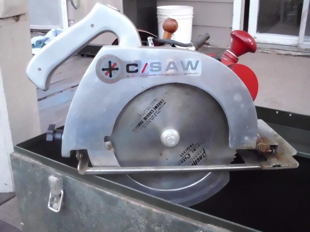

Webhead 95 #13 Posted July 24, 2019 Here’s my version. Pretty much unused. 2 1 CNew, factory and pmackellow reacted to this Share this post Link to post Share on other sites
Wallfish 718 #14 Posted July 24, 2019 1 minute ago, Webhead said: Here’s my version. Pretty much unused. Show off! I've never seen that early type David posted before. Even the coil cover is old school. Share this post Link to post Share on other sites

JUST O&R 237 #21 Posted July 25, 2019 Post correction I probably should just sell them . Will it can be done it wasn't easy but it works NOT I CAN USE THE ORIGINAL COIL. Cut the original wire off about 1/2 " from the coil used a dremel with a extra small bit and dug out the around the steal wire. Then soldered in a new wire in when took a heat gun and heated the insulation on the wire and kind of slid it down into the coil. (It may be hot) Share this post Link to post Share on other sites
factory 487 #22 Posted July 25, 2019 Good to see you sorted it out . I didn't suggest that method as sometimes you can make coils, transformers or other wound components worse, if a soldered joint further inside goes open circuit as a result. I have done delicate surgery on (unobtainable custom wound) potted transformers at work, using a heat-gun to gently soften the compound, then digging a little bit out at a time to find the failed solder joint(s), again I had to be careful not to use too much heat to avoid disturbing other joints. As parts can be scarce, you sometimes have to resort to either figuring a way of repairing it or making a new part from scratch. David Share this post Link to post Share on other sites
JUST O&R 237 #23 Posted July 25, 2019 Will john said it was the wrong coil for the year so I just thought I would try to fix it . Can't be leave it still works Ive never been good with soldering things. Sims to work has good fire only time will tell. Ill get the carb done and see how she run. Share this post Link to post Share on other sites
factory 487 #24 Posted July 25, 2019 (edited) 22 hours ago, Wallfish said: I've never seen that early type David posted before. Even the coil cover is old school. Here is another picture showing the back of the coil cover, which unlike the later ones is completely open, I guess something in that style could be made to replace the missing one. Something else I've noticed is the extended tube for the muffler, I've checked through my other saved pictures and a few other early ones (with the round tank & larger handle) have this too, including the C/Saw K-TRON repaired earlier this year. Also interesting to see they put the air filter in the other handle too (carb side). David Edited July 25, 2019 by factory Extra Info Share this post Link to post Share on other sites
