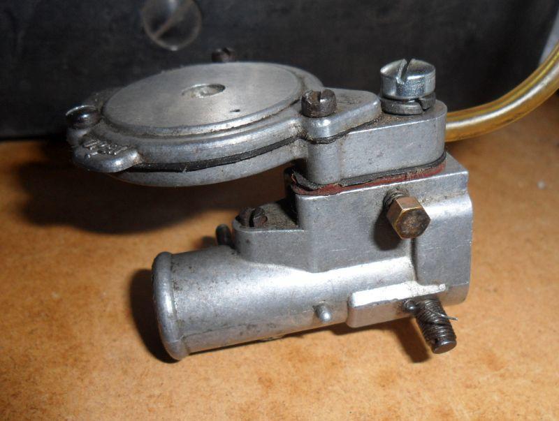

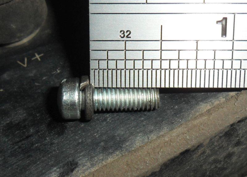

factory 487 #51 Posted August 2, 2019 Probably too late but here are some pictures of the carb I found today, the screw is 1/2" long after the spring washer, the needle will be useful as I have an early engine that needs one. If the screw is of any use I will find out how much it would cost to send over. On 8/1/2019 at 9:15 PM, K-TRON said: I am honestly shocked that this saw was fit with such an aggressive blade from the factory. I had tried a carbide tipped blade much like that and the belt continued to slip no matter how I adjusted the drive belt, and how slow I fed it wood. I suspect that the reason for this was due to the inherently wider cut made by the style of blade that I used. The teeth are very closely set on the blade I currently run, and it works well. The fine toothed blade looks a much better choice than, is belt the original? I guess it still works well because the Comet C/saw doesn't use a gearbox, the early gears were made of cast alloy which quickly ended up with stripped teeth, probably not helped if the gearbox oil escaped through poor gearbox seals, O&R changed to using grease later on, anyone rebuilding one should use grease too. 23 hours ago, Wallfish said: On 8/1/2019 at 6:59 PM, factory said: I'm also surprised that so many of these Comet Saws appear to have had very little use. Because they don't work that great and the lack of power. Not to mention the carbs suck (except for gas and air) so I'm sure many people just gave up. Certainly good for us collectors many years later! I have a Homelite XL100 saw that will power through a 4x4 easily with an aggressive blade at full depth. Fun to use but it's heavy. Does the Homelite have belt drive? The Orline circular saw also has belt drive and I noticed the advert showing a similar aggressive blade (one of two blade/disc types supplied with it). David Share this post Link to post Share on other sites

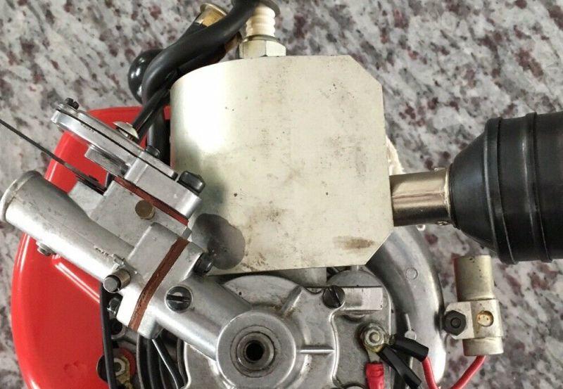

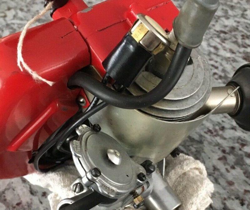

JUST O&R 237 #56 Posted August 10, 2019 Been working a lot this week just found some time to work on my saw . Made a cardboard stencil of a cover then cut it out of some tin. Then brazed it together a little sanding and I have a cover. came out ok for the first one. now I might need to paint the rest. 4 1 factory, pmackellow, Fishnuts2 and 2 others reacted to this Share this post Link to post Share on other sites

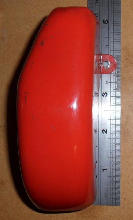

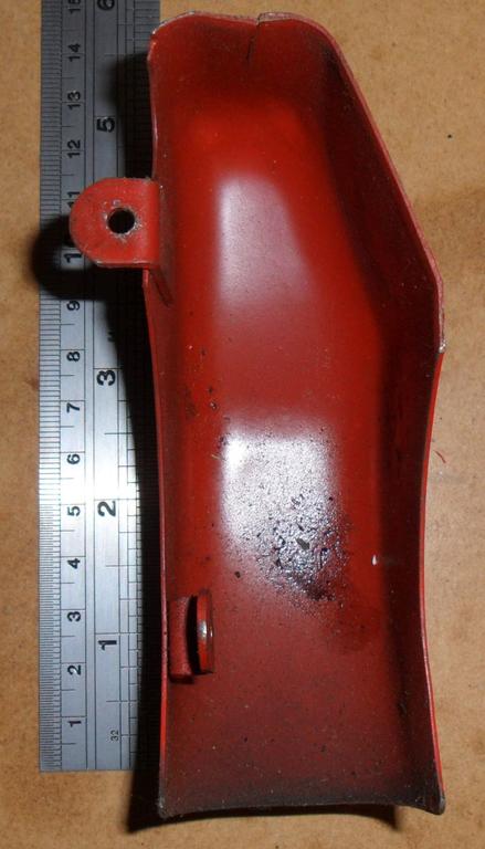

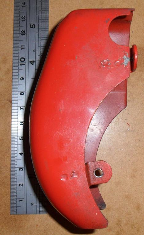

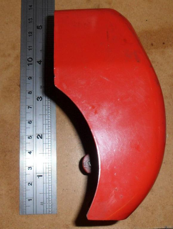

factory 487 #58 Posted August 10, 2019 12 hours ago, JUST O&R said: Been working a lot this week just found some time to work on my saw . Made a cardboard stencil of a cover then cut it out of some tin. Then brazed it together a little sanding and I have a cover. came out ok for the first one. now I might need to paint the rest. Looking very nice, personally I would keep the original paint on the rest of it as it's still in quite good condition, plus the repro decals don't look quite right. For reference here are some pictures I took of the coil cover from my Comet pump (I meant to add them a while ago but never got round to it), no idea if the bottom section has a bit cut out of it for the pump as I haven't got any of the other tools to compare. David Share this post Link to post Share on other sites
JUST O&R 237 #59 Posted August 10, 2019 Will I wasn't going to paint it but the tank need a lot of cleaning. Those are some great pix,s of the cover . I toyed with the idea of fiberglass but maybe next time. The tanks the next part of the project . Share this post Link to post Share on other sites

JUST O&R 237 #64 Posted October 31, 2019 Yes David its almost done. still looking for screws for the diaphragm plate the screws I have are Philips head screws. Thats's not the rite ones they should be flat heads so Im still looking. Share this post Link to post Share on other sites
factory 487 #65 Posted November 1, 2019 Are the screws your looking for the carb three smaller ones or the larger one? David Share this post Link to post Share on other sites
factory 487 #66 Posted November 1, 2019 You said you were looking for a cylinder baffle for your current project (the Toby Cart), if you were to make a replica of the type normally found on the C/Saw, then you will have that spare newer one for the other engine, just a thought. David Share this post Link to post Share on other sites
JUST O&R 237 #67 Posted November 1, 2019 Ya that the screws I'm still looking for just would like to have the rite screws there. I know its not a big deal most people would never notice. but when you see it you let me know it not rite so we need to make it as close as we can. ( YOU SEE THINGS I JUST DON"T SEE ) But I thank you for that it's great to have people looking closer then I do. Share this post Link to post Share on other sites
