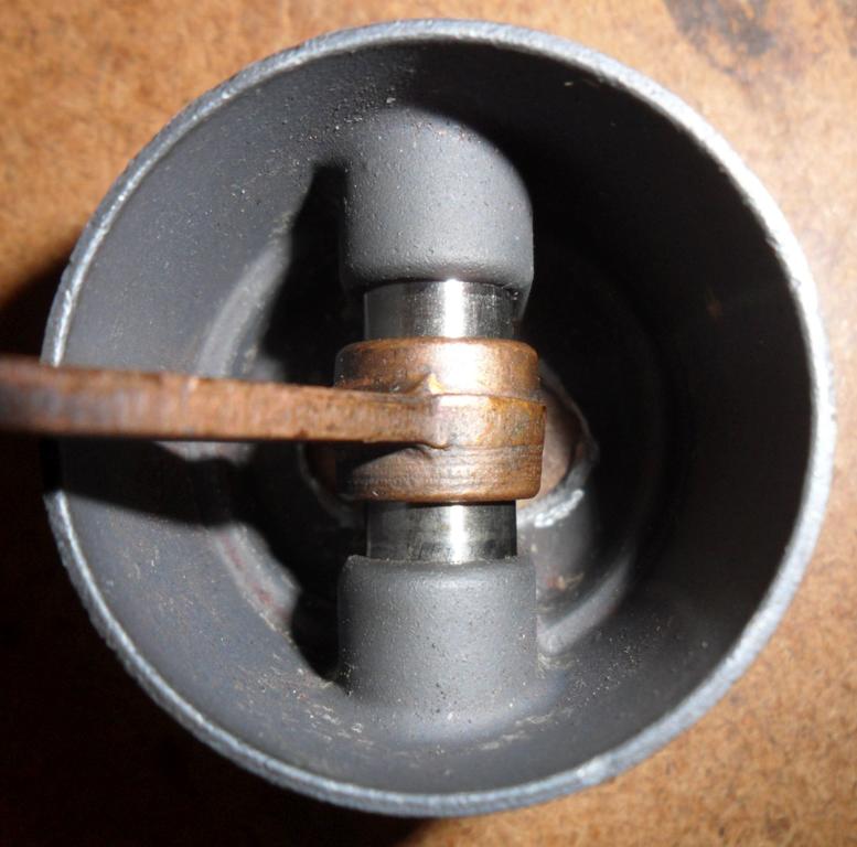

JDB44 0 #3 Posted October 14, 2019 Well picked the engine up a few years ago for my son. Had it running at our local steam and engine show and engine picked up speed and shutdown. Noticed it packed compression. Thought initially a gasket blew out on the exhaust manifold. Finally decided to start disassembling to see what was going on. Removed the cylinder barrel and found small pieces of metal on piston. Grabbed piston and noticed there were no bearings on connecting rod. Also bottom edge of piston had areas broken off. Would like to try finding parts to get running if possible. Share this post Link to post Share on other sites
factory 487 #4 Posted October 15, 2019 Last one I had that speed up & shutdown was due to the governor mechanism not working. Your engine sounds worse as the piston has got damaged, it will need a complete engine stripdown & clean to make sure no bits of metal are left inside, anything missed could cause similar damage at 6300rpm. Please post some pictures so we can correctly identify both the engine type and the parts needed, are you in the US? Note that earlier engines don't have any needle rollers for the con-rod little end bearing, example below; Also did you clean out any old crumbly filter foam from the carb air filter before it was run? David Share this post Link to post Share on other sites

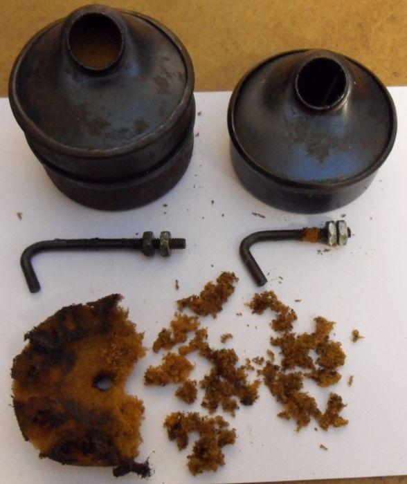

JDB44 0 #5 Posted October 15, 2019 Yes, I'm in the U.S. Engine had run good until that point. No filter media in air filter. Will need to further disassemble to view connecting rod at wrist pin. Before we jumped into that was hoping there were parts available to rebuild vs scrapping. Share this post Link to post Share on other sites
factory 487 #6 Posted October 16, 2019 Ouch, that doesn't look good, are the rollers from the bearing still inside the bottom of the crankcase or had someone removed them? Either way the surface of the crank pin will probably have damage too. If the bearing did fail and flung out all the rollers then there could be damage to the crankcase too. Have a look at the Tiny Tiger guide & instructions I linked in the earlier post for information on separating the generator from the engine, then you will be able to dismantle the engine further. A few years ago I acquired a dismantled Tiny Tiger that had suffered a catastrophic bearing failure, there were lots of dents inside the crankcase from the bearing rollers and it was also cracked as a result. It required a donor engine block (with tapered output shaft) to rebuild, you should be able to find an incomplete engine for not too much money to use as a donor if needed. I think the shipping to the UK was more than the cost of the donor engine. Here are some pictures of that Tiny Tiger, first picture as bought, second the donor engine, third the completed restoration. David Share this post Link to post Share on other sites
