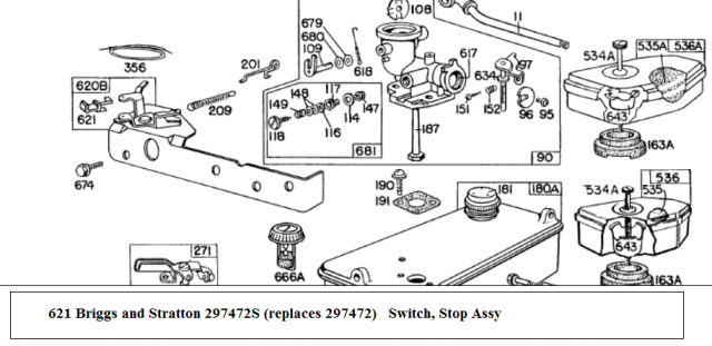

Darmic1 447 #26 Posted March 28, 2014 Thanks Ian, been making good use of my rest days! Cheers for that Gareth, silly question, do you have a picture, as mine is obviously missing this part and i've no idea where it actually goes or what it looks like??? Share this post Link to post Share on other sites
S1g 579 #27 Posted March 28, 2014 I'm not sure but ill see if I can find one. If you look at the throttle lever where the cable attaches, move it to the stop position and you will see a brass(probably now painted over) springy tag, which you push down and pop the wire through the little hole. Hope this makes sense? Share this post Link to post Share on other sites
Darmic1 447 #28 Posted March 28, 2014 I think I see where it should be..... but its missing, just a small grippy square pressed into the bracket where said springy bit should be! Share this post Link to post Share on other sites
Anglo Traction 1,018 #29 Posted March 28, 2014 1 Darmic1 reacted to this Share this post Link to post Share on other sites
Darmic1 447 #30 Posted March 28, 2014 Thanks for the diagram, have found the stop switch on the bay of E along with an air filter foam and a 3.5mm pull start rope. All for a little over a tenner. The rope which came with the mower was a 6mm one and wouldnt return correctly and the air filter was an old decorators sponge...... and I mean old!!! 2 pmackellow and Anglo Traction reacted to this Share this post Link to post Share on other sites

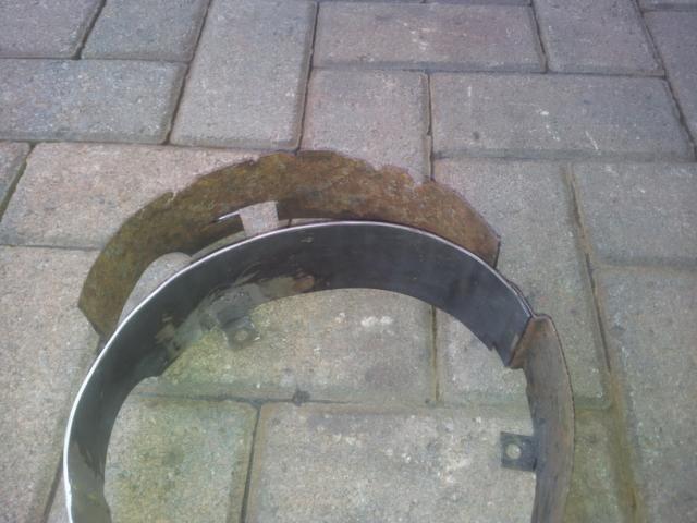

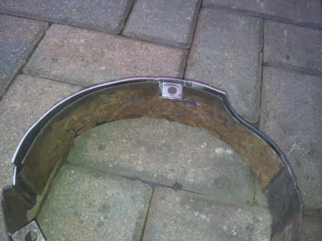

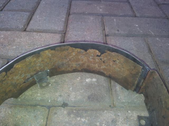

Darmic1 447 #35 Posted March 31, 2014 Haven't made much progress with this for a couple of days due to work.... Managed to get a couple of hours this afternoon so I've repaired the guard fitted around the bottom of the engine/blade. It was rotted quite bad on one side and had been fibreglassed. I cut out the bad and let in some new steel and then re-fitted the bracket used to bolt it down. I will drop the guard off tomorrow to be blasted and powder coated black. I will also be collecting the 2nd of these Saturn's tomorrow from Hook, nr Basingstoke, so not far away...... 1 pmackellow reacted to this Share this post Link to post Share on other sites

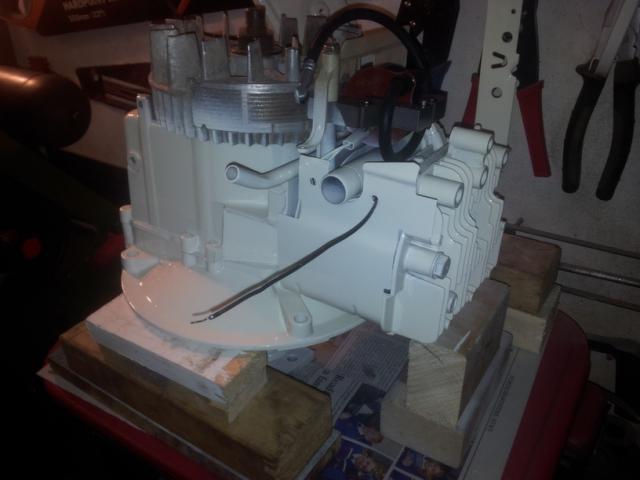

Darmic1 447 #40 Posted April 3, 2014 Saturn 2 got dismantled today. Gave up trying to start it, so I exacted some revenge with the spanners! All the parts are now at the blasters along with Saturn 1. Then I performed a dissection of Saturn 2's heart......... The engine is now totally stripped, having ordered new condensor, points, magneto armature, full set of gaskets and seals, new diaphragm, tank cap, air filter, exhaust and spark plug! If it wont start after that it may end up in space as its name suggests!!! All parts have been cleaned and degreased. Valves have been decoked and lapped in, will put some pictures up tomorrow. Share this post Link to post Share on other sites

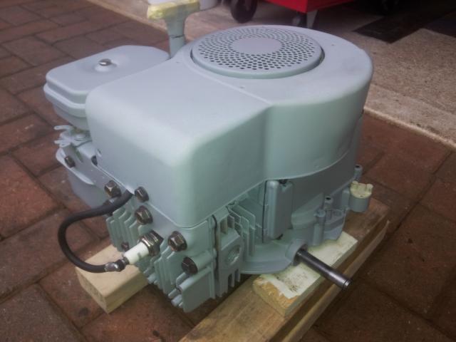

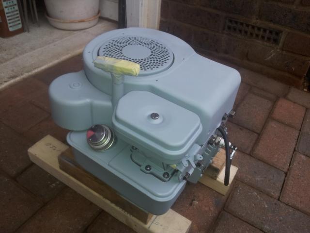

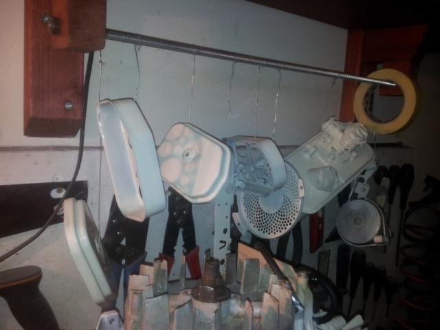

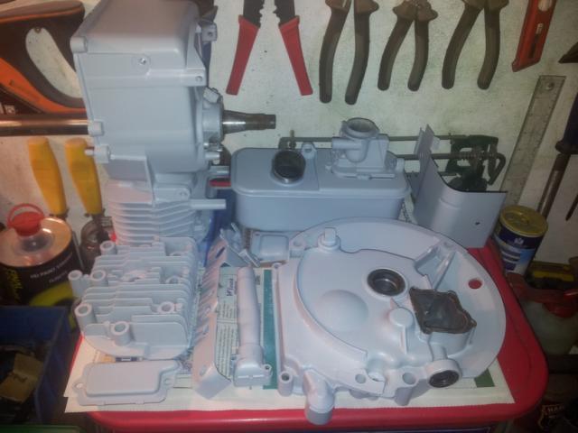

Darmic1 447 #41 Posted April 4, 2014 I managed to get these parts of Saturn 2s engine stripped of all the old paint, wire brushed and etch primed today. Wont be putting the top coat on until the new parts are fitted and the engine is built up. Share this post Link to post Share on other sites

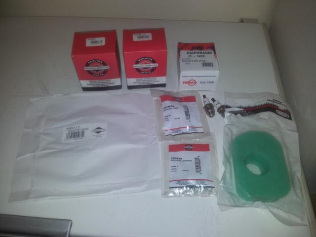

Darmic1 447 #42 Posted April 5, 2014 The postman bought me a pile of goodies today, all the bits needed to rebuild the Saturn's engine....... Share this post Link to post Share on other sites
Darmic1 447 #43 Posted April 5, 2014 A few hours later.......... All reassembled after finishing stripping and priming the air shroud, recoil housing and air filter case. Very pleased to report we now have a good strong spark, so hopefully it will now run! 1 pmackellow reacted to this Share this post Link to post Share on other sites

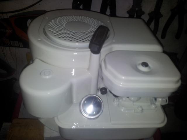

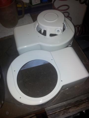

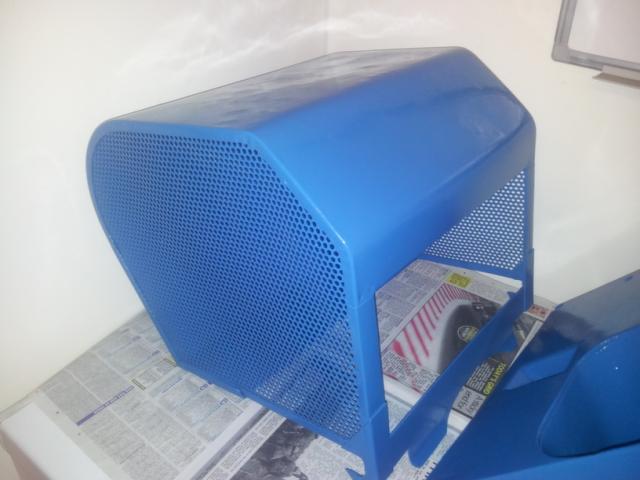

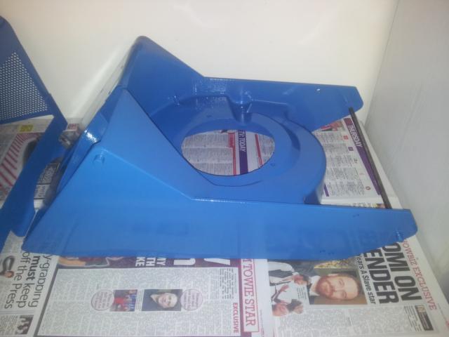

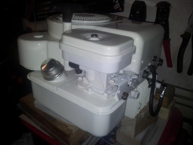

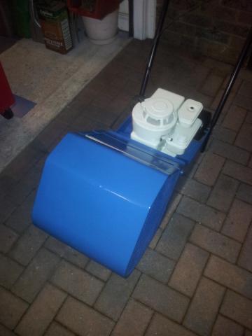

Darmic1 447 #46 Posted April 7, 2014 Saturn 2s engine got its new clothes today, along with the air shrouds, air filters, starter, fuel tank and the flywheel screen. Saturn 1s deck and grass box was collected from the blasters today, managed to get them painted too. The handles, roller and guard are all powder coated satin black. 1 nigel reacted to this Share this post Link to post Share on other sites

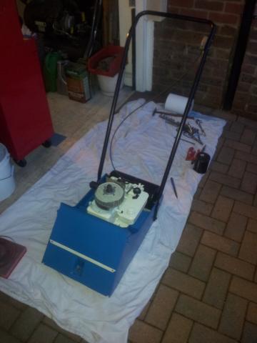

Darmic1 447 #48 Posted April 8, 2014 Spent 3 hours in the garage this evening and the 1968 Saturn is all back together. Titch has the job of recreating the Landmaster decals for it, only then will it be finished. I will get some daylight shots tomorrow. Also managed to finish putting the engine back together for Saturn 2, the 1979 one. Share this post Link to post Share on other sites

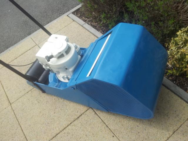

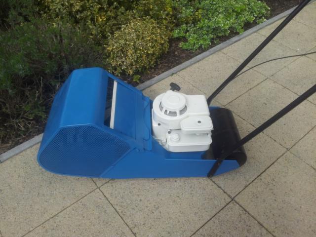

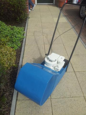

Ian 2,417 #49 Posted April 9, 2014 That's a rather nice paint finish, she's going to look great when your finished 1 Darmic1 reacted to this Share this post Link to post Share on other sites

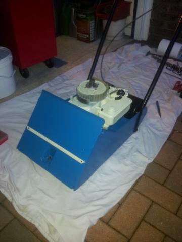

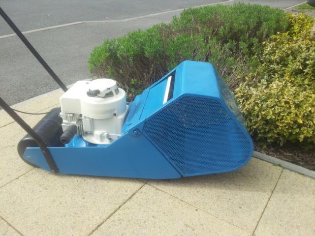

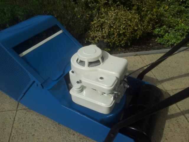

Darmic1 447 #50 Posted April 9, 2014 Thanks Ian, the first one is finished bar the decals, Here are a few pictures in the daylight. 1 nigel reacted to this Share this post Link to post Share on other sites
