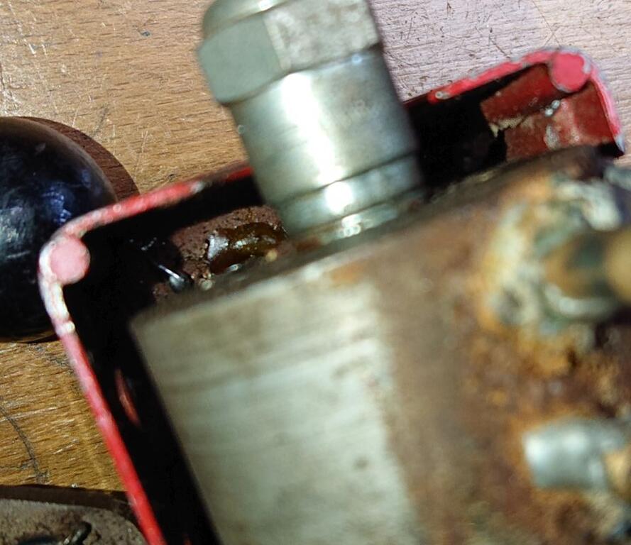

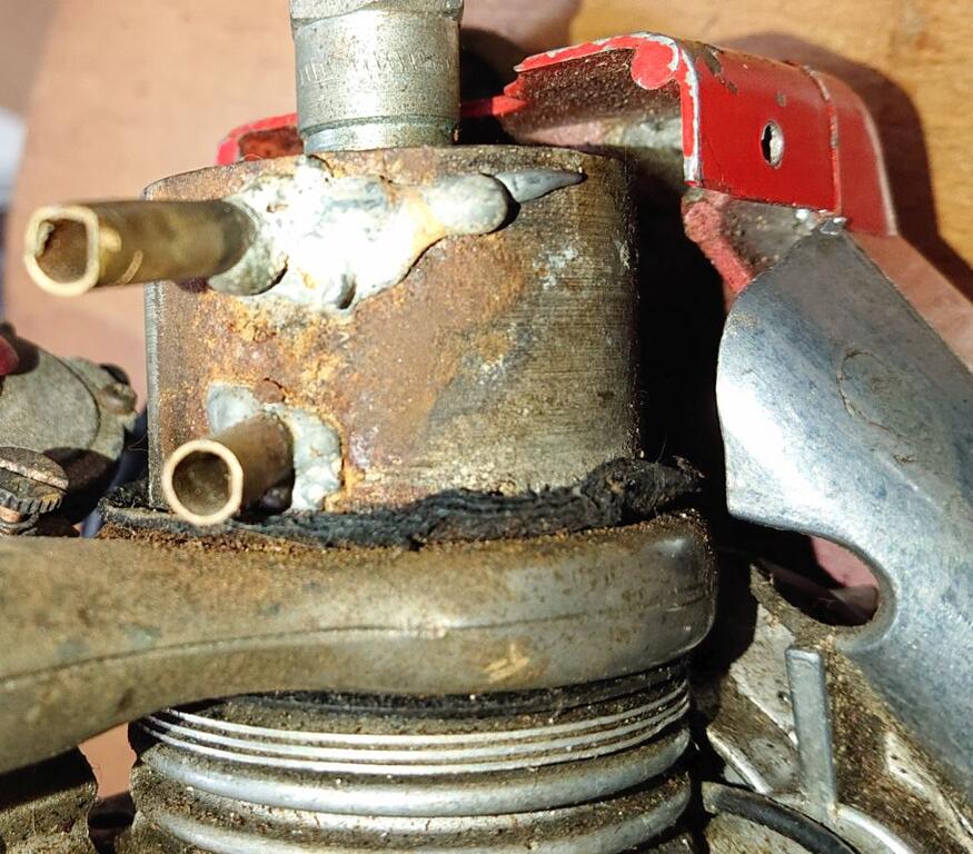

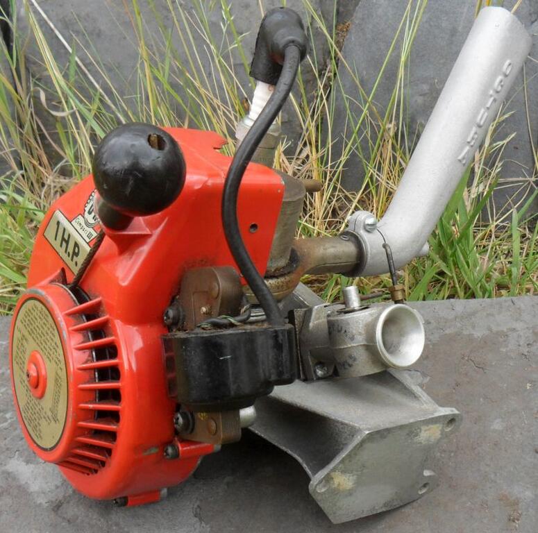

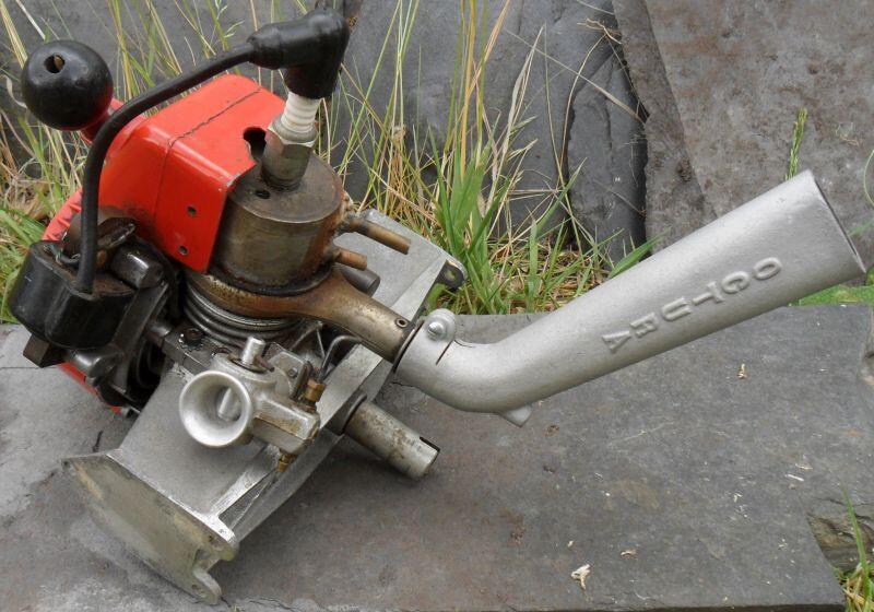

factory 487 #42 Posted June 4, 2020 Finally got the Octura carb & 'go-louder' exhaust fitted to my boat engine, the engine still needs rebuilding at some point on the future, will have to make another tool to get the cylinder off. Hopefully I'll find a more original cylinder in the future, this one has been bodged by a previous owner, they didn't even bother to remove the cylinder as there is lots of solder splattered on the inside of the starter. David 1 CNew reacted to this Share this post Link to post Share on other sites
CNew 408 #43 Posted June 5, 2020 That exhaust is awesome! Share this post Link to post Share on other sites
JUST O&R 237 #44 Posted June 5, 2020 14 hours ago, factory said: this one has been bodged by a previous owner, I see you have people like that there too. Ive seen my share of that here mowers are the worst Share this post Link to post Share on other sites
Fishnuts2 22 #45 Posted June 5, 2020 I'm thinking that I could almost hear the exhaust noise from that engine at my house! Neat project! Share this post Link to post Share on other sites
factory 487 #46 Posted June 6, 2020 On 6/5/2020 at 1:21 PM, JUST O&R said: On 6/4/2020 at 10:55 PM, factory said: this one has been bodged by a previous owner, I see you have people like that there too. Ive seen my share of that here mowers are the worst It happens in a lot of things and the stuff I used to repair for a living. I recycled a mower last weekend, it was massive lump of cheap orange plastic junk, saved a few of the screws & the motor brushes though. On 6/5/2020 at 3:10 AM, CNew said: That exhaust is awesome! On 6/5/2020 at 3:26 PM, Fishnuts2 said: I'm thinking that I could almost hear the exhaust noise from that engine at my house! Neat project! The V8 style exhaust seems a little more common, just need to figure out how to make a cooling system, then I can see if the (noisy) neighbours appreciate the sounds from it. David Share this post Link to post Share on other sites
