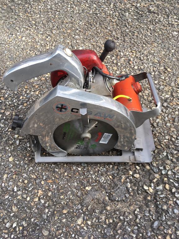

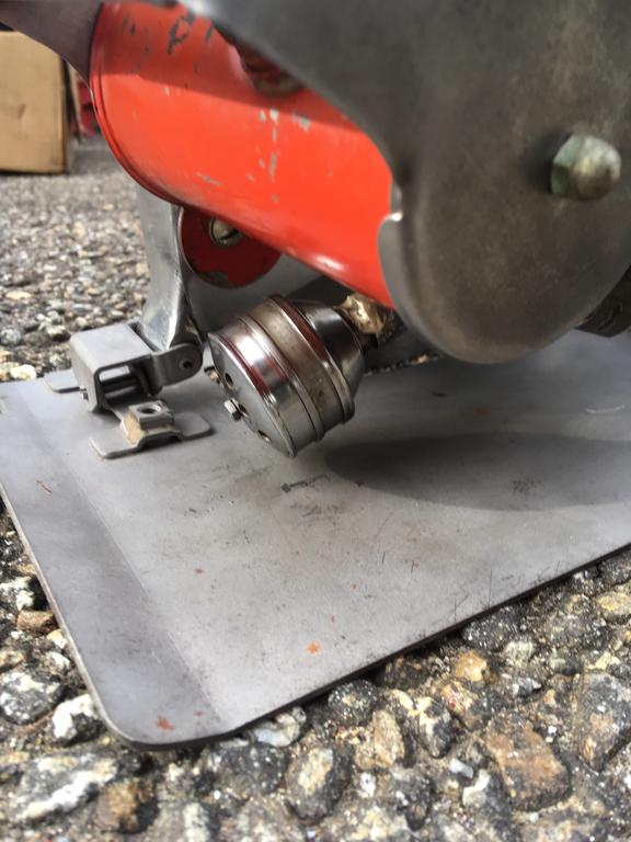

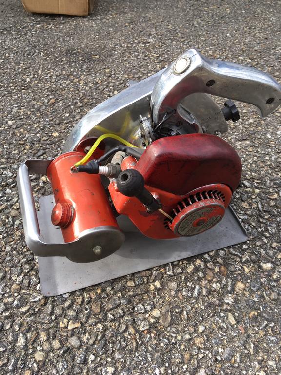

Wallfish 718 #29 Posted April 19, 2020 They probably are just rubber bands, hence "packing bands" and the pic in the drawing even looks like one for 5-2 . Put the engine together last night with a rubber band for 5-9 and used the old 5-2 as it wasn't too bad of condition. Share this post Link to post Share on other sites
Wallfish 718 #30 Posted April 19, 2020 Just need to do the recoil and I'll probably paint the top handle. Then a final clean and polish as it's difficult to keep clean while working on it. 3 pmackellow, CNew and factory reacted to this Share this post Link to post Share on other sites
Wallfish 718 #31 Posted April 20, 2020 Chromer C-Saw all done for now. Decided to leave the tank handle shinie and no new paint. That can be done by the next person. Found a chrome muffler to go on there too. Had a bit of a struggle with assembly. These have plenty of tough to get to screws. First the crank bound up after engine assembly and had to pull it apart 3 or 4 times because of a roller slipping out each time. Finally got that good to go then assembled like the last pics. Put the recoil cover on and went to do the coil cover. No go as the replacement coil I used wouldn't allow the cover. Fix the wires on the original and assemble again. That little nut on the post is very difficult to get to and the fatter wire on the repaired coil didn't want to snake behind the flywheel. Cover fits perfect this time BUT, forgot to install the governor vein. Take it apart and do it all over again and those reverse cover slot screws are a pain with the engine on the saw base not to mention the worst one is the back of the coil cover. Also got zapped pretty good while pulling it over and checking for spark. Seems Tom Easley (the name engraved into it) is haunting the saw! Maybe he wants the red parts painted? 2 CNew and pmackellow reacted to this Share this post Link to post Share on other sites
