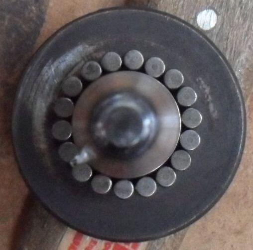

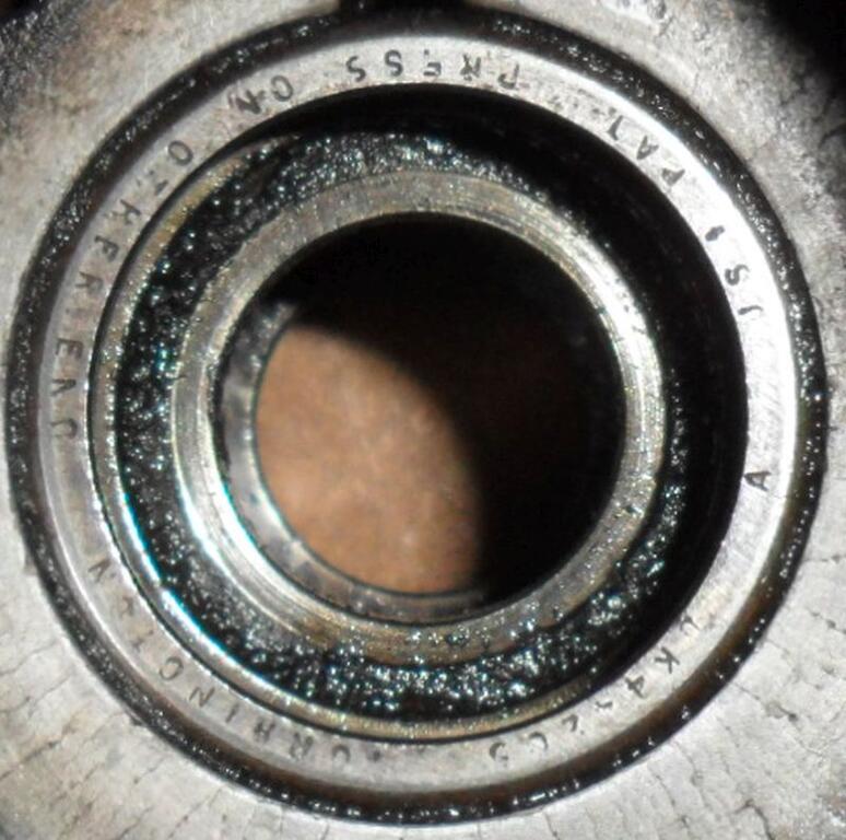

factory 487 #28 Posted June 23, 2020 Just to be really helpful (not) the parts lists describe that as a "crankcase assy. (includes bearing & thrust washer)" with no part numbers for the rollers or thrust washer, some parts lists from 1970 mention this type of bearing arrangement, I guess they could turn up randomly in other engines. My picture was from a 13B-252 engine dating from 1973, here is the before picture, the bearing appears to be made by Torrington, I seem to remember something like a disintegrated seal behind it, also there is another parts crankcase I saw a few weeks ago with this bearing. David Share this post Link to post Share on other sites
CNew 408 #29 Posted June 23, 2020 Interesting, I didn’t see any sort of seal associated with this bearing but I’ll check again. I’m hoping whoever was in this engine last didn’t forget some parts or lose some of the roller bearings. I need to count the ones in your photo and compare. Share this post Link to post Share on other sites
factory 487 #30 Posted June 23, 2020 There are 18 rollers in both pictures I took, you have to fit them in the crankcase on this type before inserting the crankshaft. Can't see anything that looks like a thrust washer though. David 1 CNew reacted to this Share this post Link to post Share on other sites
factory 487 #31 Posted June 23, 2020 9 hours ago, CNew said: I didn’t see any sort of seal associated with this bearing but I’ll check again. There isn't one, it was on something much older and looks more like a gasket to fill space behind the bearing. David Share this post Link to post Share on other sites
