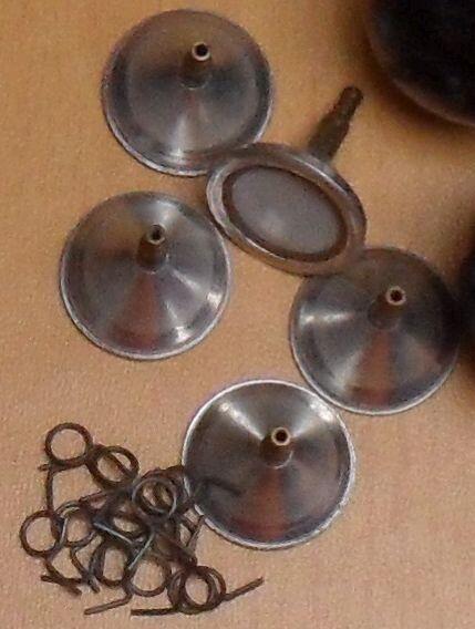

factory 487 #3 Posted July 23, 2020 If you could find a source, something like these would also be suitable with some modification to the pickup tube. David 1 CNew reacted to this Share this post Link to post Share on other sites
CNew 408 #4 Posted July 23, 2020 Funny, that’s exactly what I wanted to use but I only have one spare and want to save it for a tool at some point. I haven’t had any luck finding filters this small except the sintered bronze type Like the Dubro brand used for RC applications. Share this post Link to post Share on other sites
factory 487 #5 Posted July 24, 2020 Mine came from @Webhead, I don't know if he has any left or if they've all gone in the lots on ePay. David Share this post Link to post Share on other sites

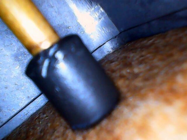

factory 487 #8 Posted July 30, 2020 I've used the Sullivan No.187 in-line filter on a couple of my engines, where the original filter was missing or damaged (I had a round tank where someone had stuck a hole through the tank filter). Here is a different base tank filter inside an earlier tank, not a very good picture as the (very cheap) borescope camera didn't want to focus on it. David Share this post Link to post Share on other sites
