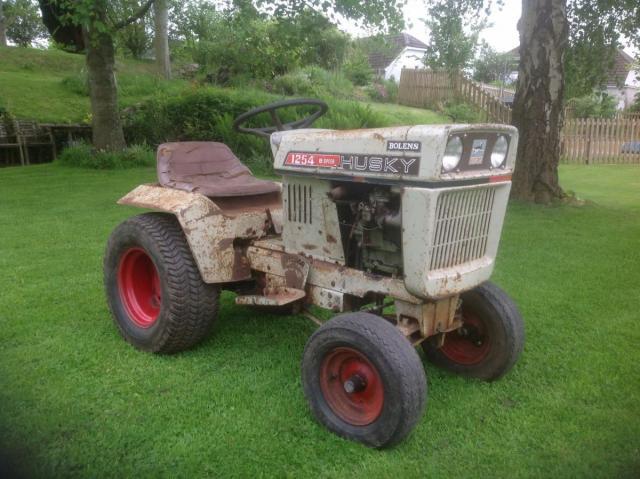

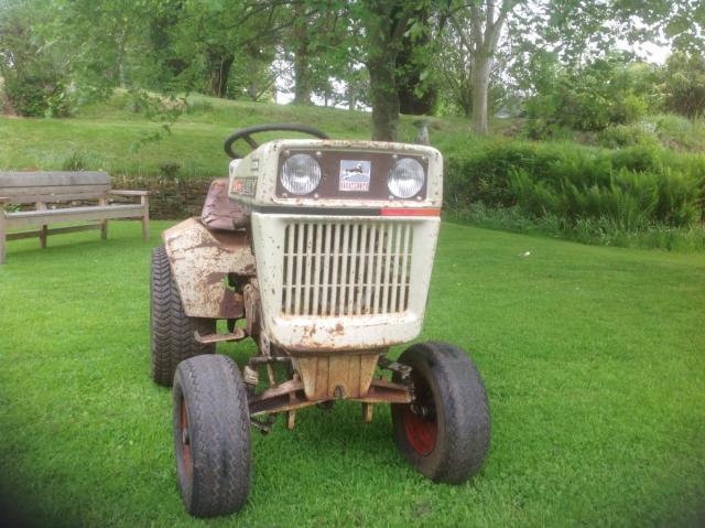

slf-uk 914 #57 Posted August 15, 2014 Quick picture of my 1054 and a couple of my other tractors, assuming I have got the hang of how to post pictures on this forum. Beware one Bolens is not enough!!! I forgot to mention that I have a good selection of Bolens spares, that I have found alternative sources for some of the parts and both of the parts suppliers I mentioned also sell secondhand parts. Looking at the pictures of your 1254, it looks like the lights are incorrect and you are missing part of the lift lever and fuel tank. Iain 3 HeadExam, Triumph66 and nigel reacted to this Share this post Link to post Share on other sites
nigel 1,881 #58 Posted August 15, 2014 I have just found this forum and thought I would reply to this post. I have a large collection of Bolens tube frame tractors plus several other Bolens and Wheelhorse tractors, and most of the Bolens tube frame attachments. I don't have a 1254 but I do have a 1054 which is the 10hp version of your tractor. The pin on the inside of the wheel is so that you can push the tractor without the engine running and the nut is for the diff lock. This must not be done up tight. Over the years I have taken most things apart on these tractors, so if you get stuck let me know. If it has not run for a while you will probably find that the clutch is stuck on. The most reliable source of parts in my experience is Sam at www.samsbolens.com/ and the cheapest is Jestin at http://www.tubeframes.com/ Best wishes Iain looks like i rememberd wrong then Share this post Link to post Share on other sites
slf-uk 914 #59 Posted August 15, 2014 I have just been looking at the pictures of your 1254 again and it looks like you are missing the cover from the front of the engine. You may have just removed it for cleaning but if it is missing the engine is not going to cool very well. It is a great looking tractor and you will be very pleased with it when you have got it running. Those Wisconsin engines are bullet proof and a lot better than the Tecumseh engines that were put in the later tube frame tractors. Iain Share this post Link to post Share on other sites

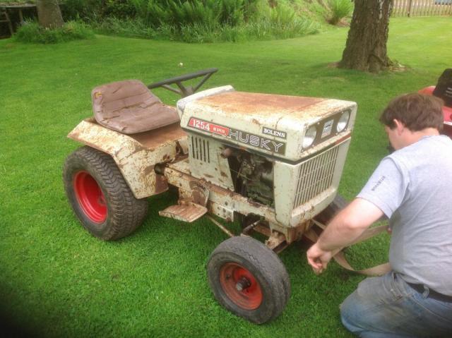

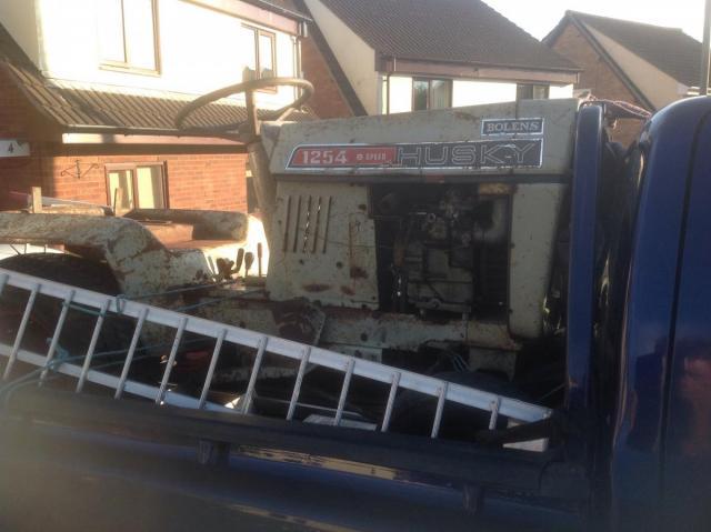

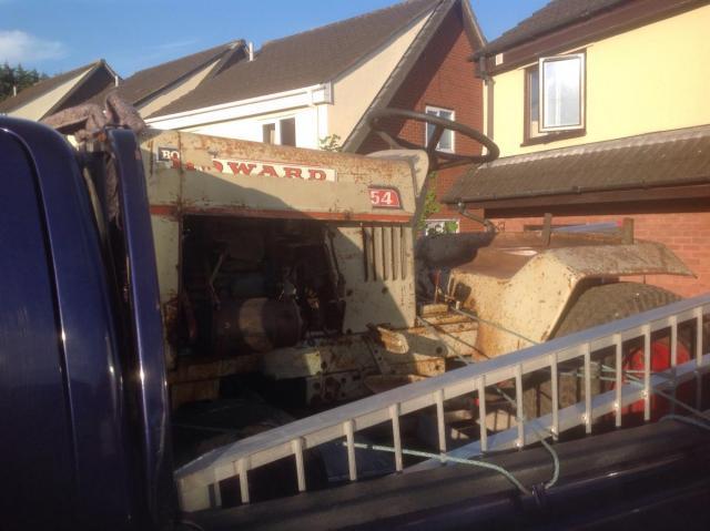

Triumph66 1,256 #65 Posted May 23, 2015 At long last, due to family bereavements, I have loaded my 1254 to go to Dorset to a friend (Daniel, aka Robins) to fit a new wiring loom in it and to do some carb fettling. When I got it back in early autumn I pumped up the tyres and greased everywhere and unlocked the diff lock to enable her to move around freely. Today, she moved from the back of the garage for the first time and onto the back of the Hilux. She's really is a solid bit of kit and worth the effort to revive her. I got a new fuel tank, battery tray, belts, air filter and other items to aid her rejuvenation. She will be dropped off tomorrow morning. Be good to have a catch up with Daniel and see how his WHs are faring. 3 Alan, nigel and HeadExam reacted to this Share this post Link to post Share on other sites

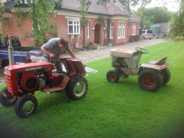

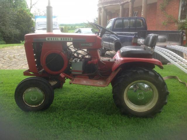

Triumph66 1,256 #66 Posted May 24, 2015 I dropped off the 1254 this morning at Daniel's house. Here are some photos of my Bolens in its new surroundings and some photos of Daniel's rare Wheel Horse. It's an electronic one apparently. And yes that's a tow rope to tow my Bolens down to his workshop. Childishly, he got a photo of me and my Bolens being towed behind his WheelHorse. 2 slf-uk and HeadExam reacted to this Share this post Link to post Share on other sites
slf-uk 914 #67 Posted May 24, 2015 Your 1254 looks great Andrew. It will be good to see it up and running It is rare that a WH get to tow a Bolens, it is usually the other way around Pleased you didn't post the picture that really would be letting the side down. Iain 1 Triumph66 reacted to this Share this post Link to post Share on other sites
Triumph66 1,256 #68 Posted May 24, 2015 I fear that Daniel will upload a photo of this incident in the fullness of time! However, once my1254 is up and running, I will challenge him to a race around his garden! If I win then that's sorted but if I loose I will blame him for his workmanship! That's a lovely Wheel Horse Daniel got and that exhaust made it so quite too. Share this post Link to post Share on other sites
