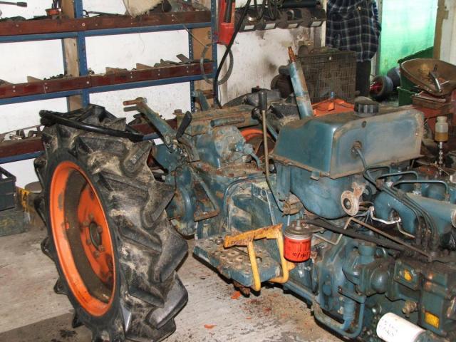

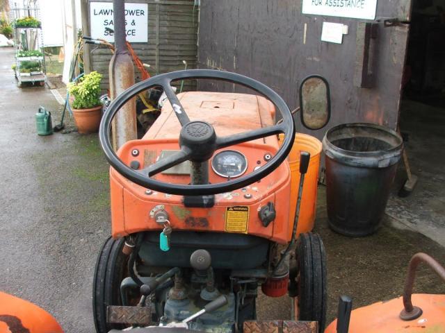

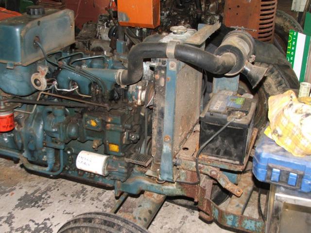

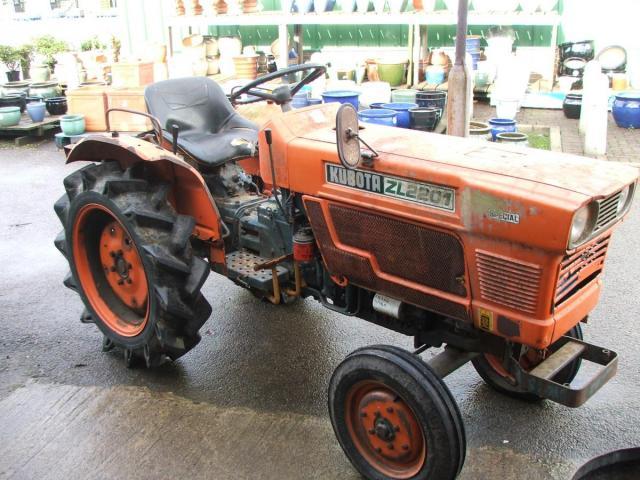

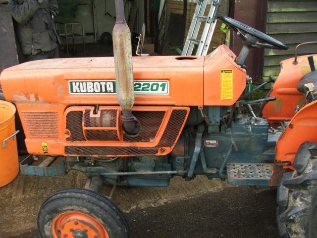

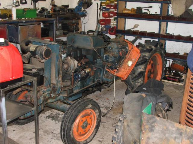

nigel 1,881 #1 Posted November 15, 2014 just to keep me busy this winter i have another project to do at the same time as handy landy this will be a quick one though we pulled it into the workshop at 12 and by 4pm we had it stripped of its clothes and when i say WE i mean my boy Karl and me, all ian did was drink my coffee 4 pmackellow, Ian, Triumph66 and 1 other reacted to this Share this post Link to post Share on other sites
pmackellow 2,738 #2 Posted November 15, 2014 What age is that then Nigel and what's the plans for it ?? Share this post Link to post Share on other sites
diggerjames 543 #3 Posted November 15, 2014 Looks good Nigel I used to have A B7001 I think ! It was a good tool used to climb mountains ! 1 nigel reacted to this Share this post Link to post Share on other sites

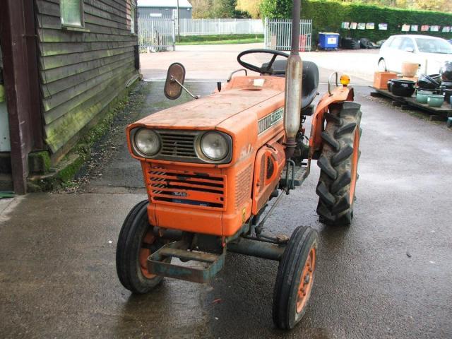

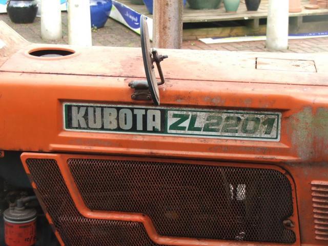

nigel 1,881 #4 Posted November 15, 2014 not sure of age paul i need to do some research 70s-80s it will be used on an estate mainly in the sand school for grading and towing a trailer for the gardener the problem is its an import and none of the numbers match up with records over here yes james this one pulls like a train Share this post Link to post Share on other sites
pmackellow 2,738 #5 Posted November 15, 2014 Just looked it up on Google, made 1976 to 1985 Share this post Link to post Share on other sites
nigel 1,881 #6 Posted November 15, 2014 all info you can find paul would be very welcome Share this post Link to post Share on other sites

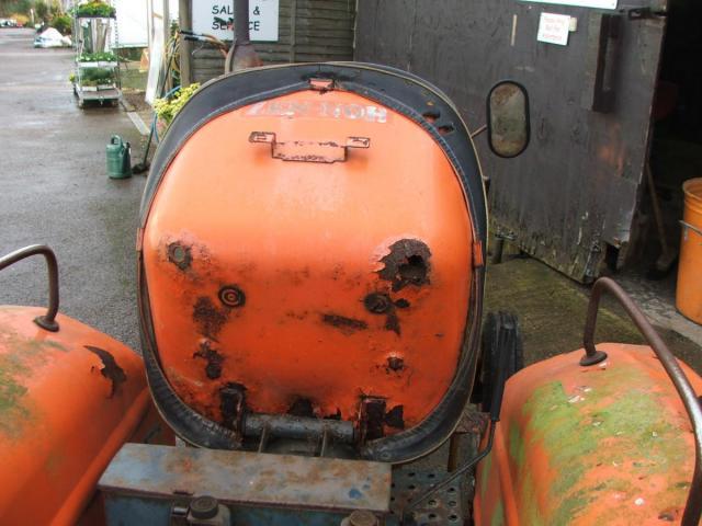

nigel 1,881 #8 Posted November 15, 2014 i need a new seat cover for it, anyone got an idea where i can get one please Share this post Link to post Share on other sites

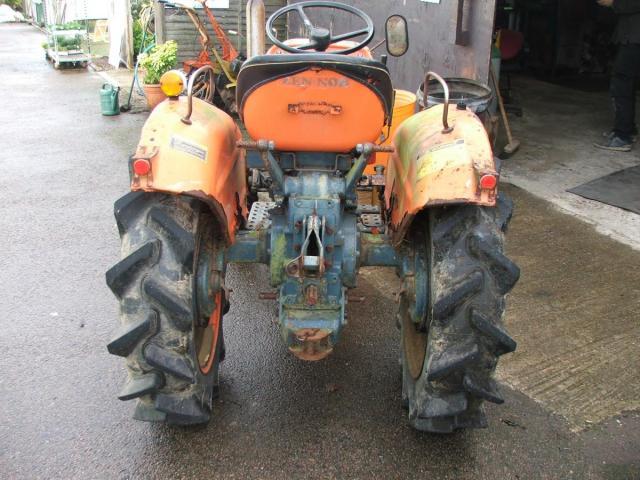

nigel 1,881 #15 Posted November 17, 2014 found a problem today the hydraulics on this haven't been used in years any way they went up but now wont go down, they seemed to have locked up any help would be welcome Ian has had a look and cant work it out ether, has any one got a manual for these or at least tell me what lever does wot cos its baffling me Share this post Link to post Share on other sites
Ian 2,417 #16 Posted November 17, 2014 I have to say that this is a very nice machine.. If a little ugly at the front.. The engine sounds good, with no exhaust it sounds great If anyone has any ideas on the 3 point hydraulics it would be good to hear.. As Nigel mentioned above the lifting arm are stuck in the up position. You can move them a very little up and down but you can hear a "metal clonking" sort of sound.. A stuck valve somewhere perhaps? Share this post Link to post Share on other sites

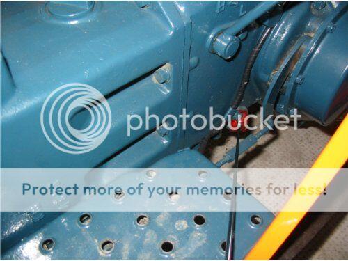

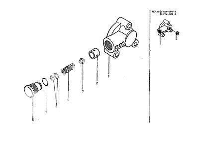

Tom 215 #21 Posted November 17, 2014 Hi, The hydraulic oil filter screen is located on the same side as the clutch and is just in front of the rear axle on the side of the transmission. It should be painted red but the paint has most likely worn off. I would imagine the pump is working because from what I understand the arms went up but won't go back down. However, you can check the pump is working by loosening off the pipe that goes from the pump to the three point housings very slightly and see if any hydraulic oil comes out as it should be pressurised, this should give you an indication that the pump is working. Another fault could be the pressure relief valve. Have you checked this? If you put the lift arm lever right down and put weight on the arms do they go down? Or are they spongy or are they solid? It's a matter of eliminating possible faults really, I am no expert but I can try my best to help you guys. Tom Location of the filter screen: Pressure relief valve diagram: Tom Share this post Link to post Share on other sites
Ian 2,417 #22 Posted November 17, 2014 Thanks Tom, your being a great help No we have not checked the pressure relief valve yet, it's on the list to check now.. The arms stay solid no mater what position the lever is in.. Share this post Link to post Share on other sites

nigel 1,881 #25 Posted November 19, 2014 Hi tom another update i took the valve out, and the lift arms are still locked up it seems to me and feels like its something mechanical holding it cos you can move the arms up and down about an inch but you get the sound of a solid clunk. would you have or know anyone who would have a parts diagram for the rear end of this machine, before i strip it down blind, cheers Nigel. Share this post Link to post Share on other sites
