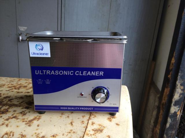

slf-uk 914 #13 Posted May 3, 2015 I bought a ultrasonic cleaner a while back but not had the chance to use it until today. I used it on the troublesome Bolens G14 carb, first with caustic acid as suggested by Norm and then with a general cleaner to remove any traces of the acid. It came out looking great but I have not had the chance to reassemble and test the carb yet. Picture of the cleaner I bought sitting on the Hood of a rather rusty Bolens G10. My Bolens are just like our cats, they get into every picture Iain 1 Triumph66 reacted to this Share this post Link to post Share on other sites
Tom 215 #14 Posted May 3, 2015 Very nice Iain, it will be interesting to see how it goes on the G14, hopefully it will cure or at least help it run better. Tom Share this post Link to post Share on other sites
