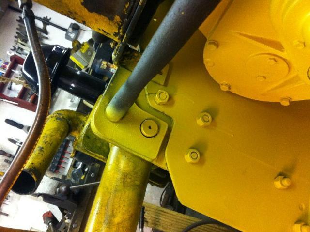

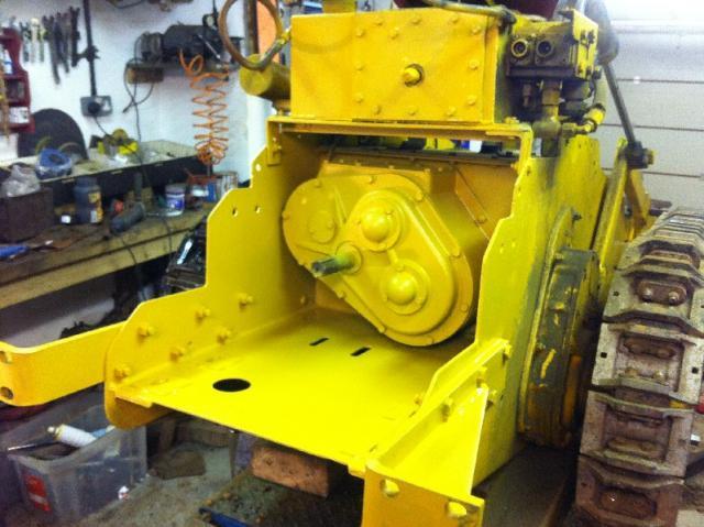

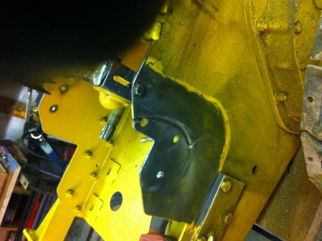

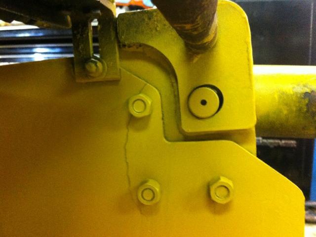

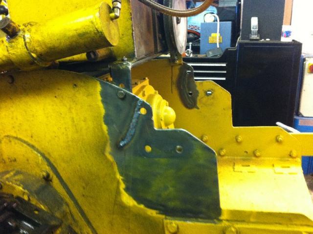

expeatfarmer 591 #5 Posted February 5, 2015 Waiting for the clutch I decided to refurb the engine bay and clean up the engine, in the process I discovered some nasty stress cracks in the body at the point where the main lift rams are bolted to the body. Any worse and the arms could have ripped off! I drilled the crack ends to stop the stress line, ground out a deep vee and then welded first from one side and then repeated the process on the other side. All better now and sprayed up with primer. I also found tha the diesel tank was full of pinholes that had been filled with Isopon, hopefully I will have a new one before Malvern but if not I will have to solder up the old one. 1 nigel reacted to this Share this post Link to post Share on other sites
expeatfarmer 591 #6 Posted February 5, 2015 I meant to say that it never ceases to amaze me at the quality of the steel used by Ransomes, this machine is over 60 years old and look how the metal cleans up for welding, the paint must be good too! Share this post Link to post Share on other sites
Stormin 4,458 #7 Posted February 5, 2015 Good job you found the cracks when you did Johnathan. Might have been an idea to weld a reinforcing plate inside. Bit of extra strength. Share this post Link to post Share on other sites
expeatfarmer 591 #8 Posted February 5, 2015 I did think of that and then thought if it has lasted 60 years loading sand it should be strong enough for the odd load of soil. Share this post Link to post Share on other sites

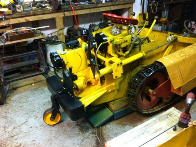

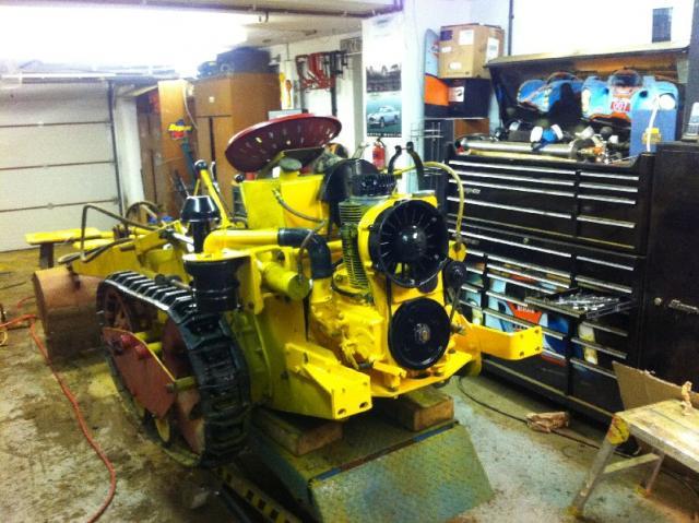

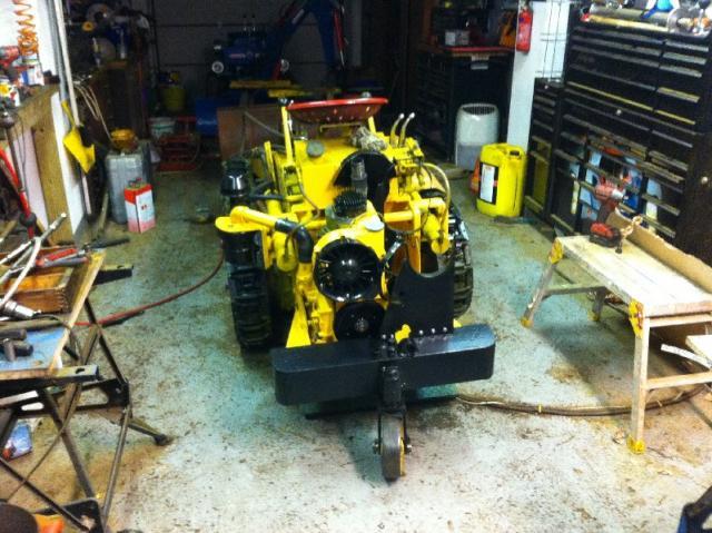

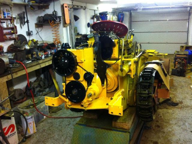

expeatfarmer 591 #9 Posted February 15, 2015 The clutch plate has been returned re furbished and re lined. Whilst i was waiting I cleaned up the engine and engine bay and re sprayed them as a part refurb ready for a full rebuild later. Now have it all back together just waiting for a new fuel tank 4 nigel, Rocboni, Stormin and 1 other reacted to this Share this post Link to post Share on other sites
Stormin 4,458 #10 Posted February 15, 2015 Looks a bit different from when I last saw it, Johnathan. I like the yellow and black colour scheme. Share this post Link to post Share on other sites

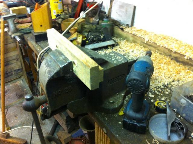

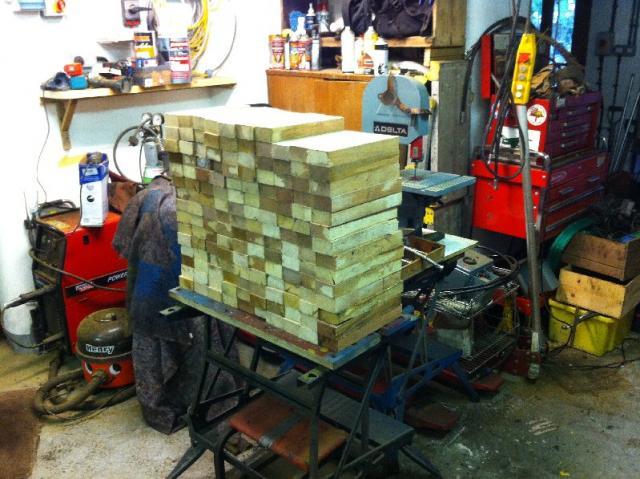

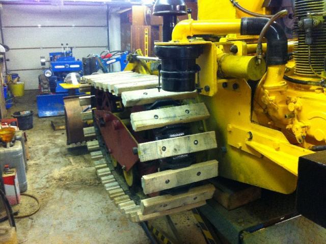

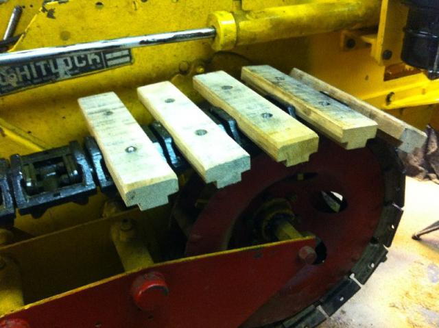

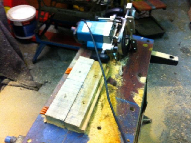

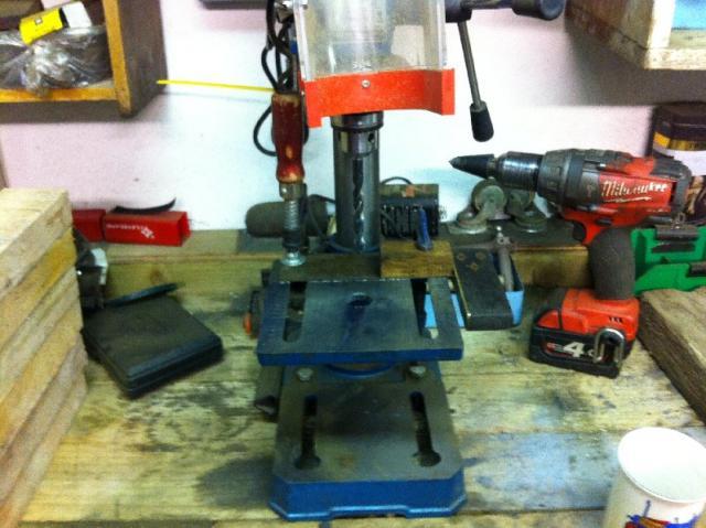

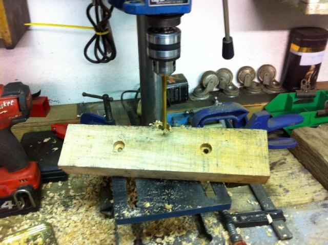

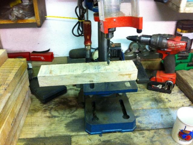

expeatfarmer 591 #12 Posted February 19, 2015 Started the task of fitting wooden swamp blocks to the new WR8 tracks. Firstly cut 128 blocks of geen oak ( enough for the WR8 and digger dozer ) Set up a simple jig to drill and counter bore two holes in each block. using a router I cut rebates on the back side of the blocks to clear the track rubbers and trimmed the blocks to width with a power plane. The green oak is full of tannin which appears to be corrosive so for a few pence more I used stainless machine screws washers and nuts to bolt the pads on. To start with I made the blocks one at a time and bolted them on but this was apparently painfully slow progress so I took ten blocks at a time through each stage rewarding myself with a cup of coffee or a puff on my pipe after each set. Listening to Planet Rock turned up loud also eased the tediumand the back ache. The digger pads are slightly different in that they bolt on above the tracks using an alloy spacer block , I have the pads ready to dress but not started fitting them yet. I have been using a small Clarke bench drill and found it very disappointing that the spindle turns out not to be vertical to the work table such a shame that for a few quid more the tool could be really useful. 1 Triumph66 reacted to this Share this post Link to post Share on other sites
Stormin 4,458 #13 Posted February 19, 2015 Mass production. Don't you just love it. What's the idea behind the swamp blocks, Johnathan? Share this post Link to post Share on other sites
expeatfarmer 591 #14 Posted February 19, 2015 They were a factory option to lower the ground pressure on soft ground and increase the stability. They are also a lot better on grass for not chewing up the ground when turning. For me they will stop or reduce chewing up the garage floor and the drive. Share this post Link to post Share on other sites
