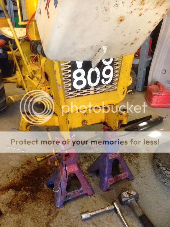

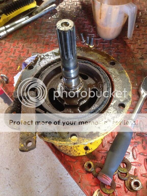

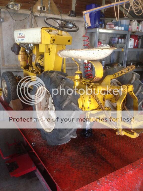

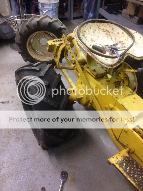

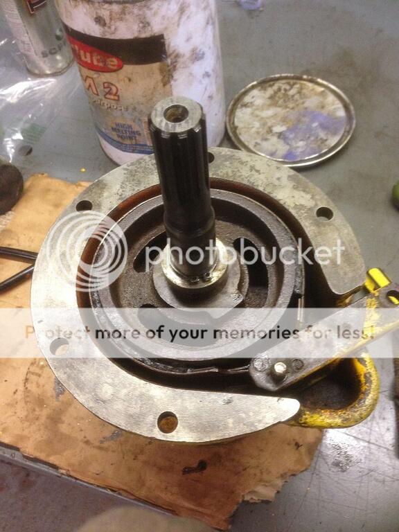

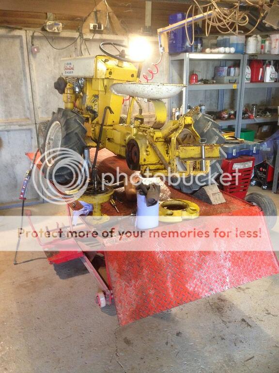

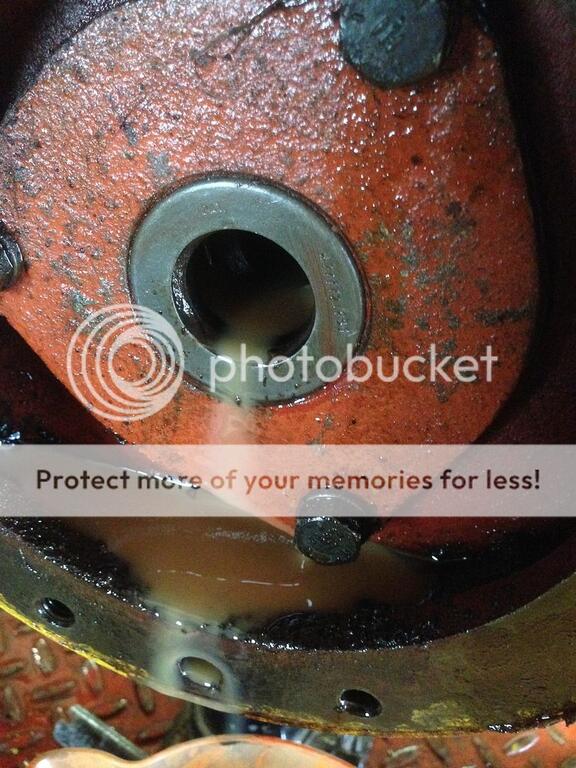

Tom 215 #64 Posted August 15, 2015 The Cub made it to Rural past times and all went well. I was very pleased as I was a bit worried it wasn't going to be ready. The engine runs sweet as a nut and the transmission drives well however I did notice that the axles were leaking which is a common problem on these as the axle seals going and also the bronze bushes wear. £15 got me both seals and bushes from a local bearing supplier which was much cheaper than genuine. Axle carriers off: Lots of old oil and dirt: All cleaned up and ready to go back together: All finished: Tested it and no leaks and the axles are perfect now with no play, it is a lot better. The only thing left to do now is change the drive belt as it is quite perished and has a few cracks. I have to admit this Cub is by far my favourite tractor Tom 3 Cub Cadet, nigel and Stormin reacted to this Share this post Link to post Share on other sites
