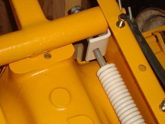

HeadExam 1,783 #3 Posted May 25, 2015 Only four of the seven photos showed up for me. Model 70s are hard to find, is it a recoil or electric start? The springs on the rear hitch are not factory, but the rest of the hitch may very well be. I thought the wheel weights may be early Bolens weights, but it is possible that E. Rowe which built the weights for Bolens and many other tractors, also supplied weights to Cub dealers overseas, that may have looked like Bolens weights, but were intended for Cubs, very hard to say. I do have photos of model 70 and 100 weights that were sold here in the US. and even that is speculation unless one knows the original purchaser. Share this post Link to post Share on other sites

HeadExam 1,783 #5 Posted May 25, 2015 Very nice Cub Ewan, you're also lucky to get all the manuals with it! Are you going to restore it or leave it? Tom I'm no Cub expert as I am new to them but I'm pretty sure the springs are factory as they were an option, from what I've read anyway. Apparently spring assist was an option to obviously help lift heavier implements. Tom Yeah but the springs for spring assist on the Cubs fit horizontally inside the frame channel an "helped" the lift rod Share this post Link to post Share on other sites
Tom 215 #6 Posted May 25, 2015 I see what you mean, I have to admit I hadn't seen one like this before, it's just weird how both Ewans and mine have an identical lift set-up. Tom 1 HeadExam reacted to this Share this post Link to post Share on other sites
HeadExam 1,783 #7 Posted May 25, 2015 I see what you mean, I have to admit I hadn't seen one like this before, it's just weird how both Ewans and mine have an identical lift set-up. Tom You guys think alike, lol. Maybe someone saw the other tractor or it was a shared idea. I posted another picture on my previous post Share this post Link to post Share on other sites

HeadExam 1,783 #12 Posted May 25, 2015 I've sorted out the photos now, it is an electric start and the springs are factory as they are in the brochure that came with the tractor from the dealer, this is from the brochure. Hi Tom, it is very rusty in places so a lot of new tin work has to be welded in so I will be restoring it. It was factory, but I think it was Auto Culto made to fit on Cubs, but not a hitch that IH or Cub Cadet specifically made. The hitch was sold in order for you to use (and buy) Auto Culto implements that would attach to the Cub and Universally to possibly many other tractors as well. They probably had the same deal that Allied and Brinly had in the states and therefore, yes factory, but not IH, that however is splitting hairs at this point. It does seem that the mounting point for the springs needs to be moved back and attached to the seat mount rather than attached to a rod across the seat brace. Notice the factory IH wheel weights in the picture, you cant see all of them, but they were the same for many years, I still believe yours may be older Bolens weights, but I could be wrong. What I do not understand is how the Universal Auto Culto says it is a three point, when there are only two points to lift, by the holes in the lift straps. I just don't see where the center lift would hook too the implement in order to actually lift an implement, because with out the center piece it isn't a 3 point implement lift, nor could 3 point implements attach to it and 2 point attachments would be difficult to lift without a 3rd point of lift. It is what revolutionized farming, the Ford three point system. I'm no expert on Cub or Auto Culto, but it would be very interesting to see how the lift worked (I know the thing worked, lol) and what type of implements it used. Does the brochure you have show any other details/pictures? The brinly lift would have hooked into the bracket with the three holes at the lower bottom of the tractor, a U shaped bracket with a sleeve hitch mount, the hole on the top lift would have had two straps attached to the bottom lift and used to raise the implement. The bolts would tighten the implement to the the back of the hitch. the Cub original rear bottom lift was different and used a single spring to the back of the seat brace for an assist, as in the photo, you can barely see the spring at the top. Share this post Link to post Share on other sites
Cub Cadet 613 #13 Posted May 25, 2015 It was factory, but I think it was Auto Culto made to fit on Cubs, but not a hitch that IH or Cub Cadet specifically made. The hitch was sold in order for you to use (and buy) Auto Culto implements that would attach to the Cub and Universally to possibly many other tractors as well. They probably had the same deal that Allied and Brinly had in the states and therefore, yes factory, but not IH, that however is splitting hairs at this point. It does seem that the mounting point for the springs needs to be moved back and attached to the seat mount rather than attached to a rod across the seat brace. Notice the factory IH wheel weights in the picture, you cant see all of them, but they were the same for many years, I still believe yours may be older Bolens weights, but I could be wrong. What I do not understand is how the Universal Auto Culto says it is a three point, when there are only two points to lift, by the holes in the lift straps. I just don't see where the center lift would hook too the implement in order to actually lift an implement, because with out the center piece it isn't a 3 point implement lift, nor could 3 point implements attach to it and 2 point attachments would be difficult to lift without a 3rd point of lift. It is what revolutionized farming, the Ford three point system. I'm no expert on Cub or Auto Culto, but it would be very interesting to see how the lift worked (I know the thing worked, lol) and what type of implements it used. Does the brochure you have show any other details/pictures? The brinly lift would have hooked into the bracket with the three holes at the lower bottom of the tractor, a U shaped bracket with a sleeve hitch mount, the hole on the top lift would have had two straps attached to the bottom lift and used to raise the implement. The bolts would tighten the implement to the the back of the hitch. the Cub original rear bottom lift was different and used a single spring to the back of the seat brace for an assist, as in the photo, you can barely see the spring at the top. I understand what you are saying, I suppose that's why mine and Toms has the clevis part attached to it. This is the brochure, notice they are cub cadet matched equipment, not cub cadet made This is the only part in the brochure that shows the lift in action, it's not very clear Share this post Link to post Share on other sites
OldBuzzard 186 #14 Posted May 25, 2015 I've always wondered why CC called that hitch a 3-pt when it's obvious that it isn't. Maybe it was the marketing weasels that came up with that to make it sound more like a 'big' tractor. An engineer certainly would have never made that claim/mistake. Share this post Link to post Share on other sites

Cub Cadet 613 #16 Posted May 25, 2015 I've always wondered why CC called that hitch a 3-pt when it's obvious that it isn't. Maybe it was the marketing weasels that came up with that to make it sound more like a 'big' tractor. An engineer certainly would have never made that claim/mistake. Cub Cadet didn't make the lift that I put pictures on of, the part that they called the 3-pt hitch is the casting that features in the brochure below, this came with my tractor. The pictures that Alain posted is what the Cub Cadet and Brinly 3-pt hitch was like. I love all the literature you have, very interesting with lots of useful information. I'd love some of those implements! Tom There is some cool implements isn't there. Ewan 2 HeadExam and slf-uk reacted to this Share this post Link to post Share on other sites
HeadExam 1,783 #17 Posted May 25, 2015 Auto Culto was as many of you know a brand of walk behind machine built by Allen & Simmonds in Reading, Berkshire. The lift that Ewan and Tom have was more than likely used to allow Auto Culto produced attachments for the Cub Cadet and other 4 wheel tractors. I imagine that with the influx and increase of ride-on machines Auto Culto saw an opportunity to still be relevant in the attachment business which had a lot less overhead and headaches.I understand there being a lot of Wheel Horse related equipment over in the UK as there is a factory in Belgium being, and I can see Cub Cadet as International Harvester had English and French lineage, but I'm surprised not seeing more John Deere equipment. I'm not surprised in seeing Bolens equipment as you folks seem to know a well built machine when you see and use one. It seems Mr. Howard was so enamored with them, he added his name to the machines so Like David Brown we could suppose there was a Howard Bolens, lol. The Rear Tool Bar, Moldboard Plough, and Potato Lifter in Ewan's literature is definitely Allen & Simmonds Auto Culto equipment. The original lift may have also came with a cross bar for attachments that didn't have outside pins, but without a chain over, or to, the top "stinger" or one point lift, I'm not sure how you would lift the Plough or Potato Lifter, which would be necessary. On the Auto Culto MK2 and Deluxe's this was accomplished by a bar attached to the implement 2 Cub Cadet and slf-uk reacted to this Share this post Link to post Share on other sites
