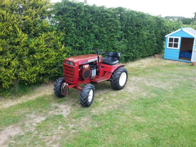

Charlie Smith 192 #12 Posted June 6, 2015 Thank you Ian for that great post! Pictures where good also I have managed to get my tyres on, not too much hassle getting the old ones off but putting these new ones on was a bit of a wrestle! but they are on now, 5 nigel, Alan, Triumph66 and 2 others reacted to this Share this post Link to post Share on other sites
Alan 1,274 #13 Posted June 6, 2015 You've shrunk Charlie. 1 Triumph66 reacted to this Share this post Link to post Share on other sites
Tom 215 #14 Posted June 6, 2015 You've shrunk Charlie. :lol: Looking great Charlie Share this post Link to post Share on other sites
Charlie Smith 192 #15 Posted June 6, 2015 You've shrunk Charlie. It's all this hot weather we're having, First bit of rain and i'll grow again! No it seems rather impossible when ever little Tyler is out in the garden I cant seem to get a picture without him in the shot somewhere Thanks Tom 1 Alan reacted to this Share this post Link to post Share on other sites
